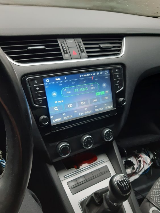

My radio is aftermarket by the way

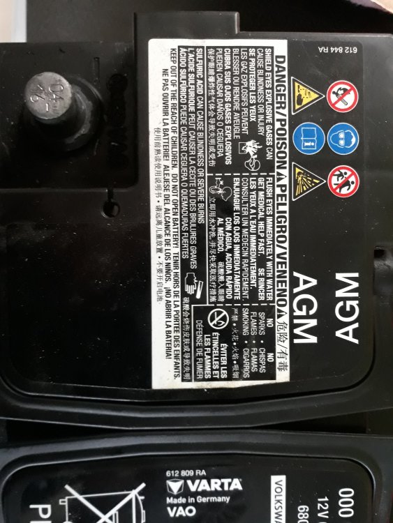

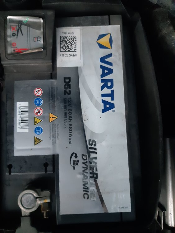

@haris Can you tell us what exactly you currently have on your vehicle? VARTA Silver Dynamic are not fitted by VW group on the production lines. They are only supplied as aftermarket parts or direct to small volume vehicle manufacturers.
A photo of your current battery will be perfect.
The reason I ask is the battery you described doesn’t exist on the fitment listings for your vehicle.
Edited by BigEjit
I bought the car 2 years ago and this battery is fitted.
Varta silver 60 agm
I thought it was the first one from the factory. My mechanic also said that this type and brand must be the car's stock battery
I was very pleasant 2 years now from the battery and I'm thinking king to buy the exactly same again

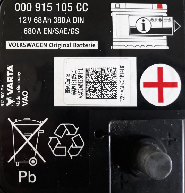

So it is definitely not it’s first battery, this one is it’s second aftermarket supplied part. The paint mark on the negative clamp is not on the surface of the tightening nut and it has been slightly overtightened as the gap in the clamp has been closed up too much. It also looks too small for the insulation wrap.
D52 is in the VARTA catalog for mk2 Octavia 1.4 without stop start.
Ideally if you want another AGM, the Silver Dynamic 096AGM is best fitment for Mk3 Octavia 1.4. (Short code E39)
Otherwise EFB Blue Dynamic 096EFB is the cheaper option for stop/start. (Short code N70)
Before ordering, check the size of the battery on the VARTA website so you know it will fit in the battery box to be absolutely sure it’s correct.
Whatever replacement you choose, I suggest you get it coded into the vehicle Just in case it was not done correctly when the current battery was fitted.

Here is a link to website of a supplier selling a D52. Notice that it looks (superficially) quite different from your battery. It is also the way I expect a Varta Silver Dynamic battery to look. The vaguely silver coloured plastic is the usual give-away that it is part of Varta's silver range.
My strong suspicion is that you have an OEM version of the D52 (same battery, internally, just cost reduced in some of the cosmetic/appearance features, to meet Skoda's requirements...I've seen Varta/Skoda do this before, and in that case, it was a non stop-start battery, and looked even plainer)
BigEjit is probably correct that this battery has been disconnected before: Most probably, whoever just felt that they needed to disconnect it because of needing to do work where there was a risk of a short, but it could be out of another vehicle.
The OEM versions do not normally make it in to the retail supply chain (in the UK anyway), but it could be what you get if you buy a battery from a Skoda main dealer.
If the battery has a date code, that may be a further clue.

It looks to me from haris's photograph as if the negative clamp has just not been pushed far enough down the battery post (which is slightly conical) before being tightened.
If it was a Skoda-supplied battery, I'm pretty sure it would have a VW-group part number somewhere on the top label, @Axle_of_weasels
Or is that in fact one just to the right of D52 on the second line? Ending 901 068?  Can't make out the first three characters.
Doesn't seem to be; those last 6 characters don't fit with any I'm seeing in parts catalogue. (And axle's link's title tells us that is the varta part number, not vw-group; now that I've gone there)
Edited by Wino
D52 is the wrong size battery for the car.    It’s way too small.
The original part no is 6R0 915 105 B and quite a bit larger.
The battery does say Silver AGM dynamic... the AGM being hard to see, but it’s in silver on the top label.
As such it’s a start stop battery, although it wouldn’t surprise me if a Used car dealer had a Car with a dead battery and put what they could get from a catalogue on the car.
catalogues can be wrong..
