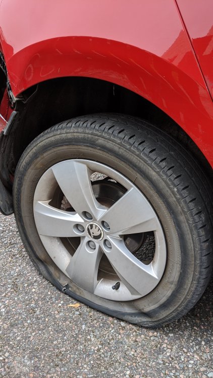

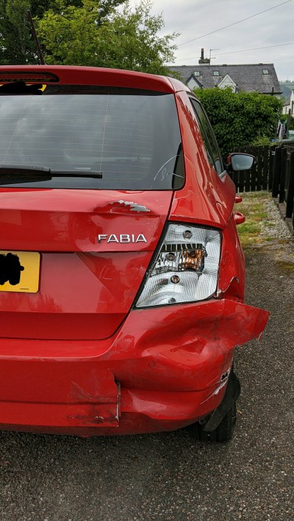

We were unfortunately involved in our first accident a few days ago, rear ended at a roundabout. No fault of ours. My 2016 Fabia Mk3 SE TSI has been assessed at the accident repair workshop and they have initially given me a HIDEOUS repair estimate of £5200!! 🤮. Now the guy is going to 'sense check' the cost of parts with Skoda Edinburgh but this sounds absolutely ridiculous and just heading towards a total loss 😥.
Does anybody have any advice on this and whether the costs should be anywhere near this! ? Pics below of the damage. They've included a new alloy as cannot be sure of its integrity apparently. All parts are to be replaced completely I think including bumper, boot and right wing.

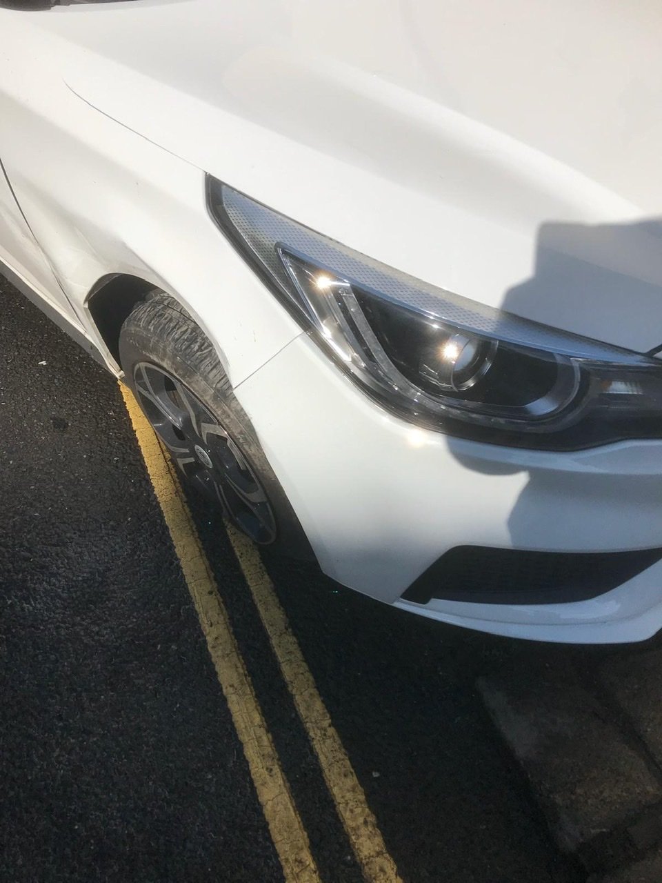

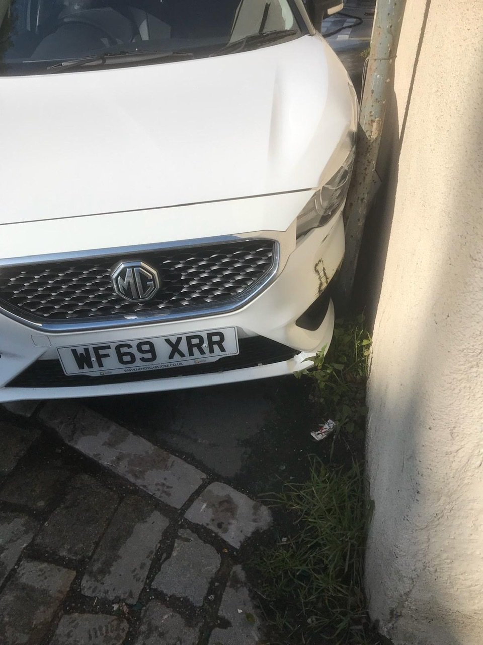

This damage cost about the same as that ....

Did the repair work include anything other than bodywork, lights and a wheel for yours? Presumably as a nearly new vehicle £5k would have been classed as an 'economical repair' though. Cheers
Yup, lights and wheels were included, but it got written off in the end. This model of MG is cheap brand new, which is was.

The biggy is the rear quarter panel (wheelarch / wing). Front wings simply bolt on. Rear quarters are part of the shell so need a lot of time (labour) to replace if it needs it.
Sounds about right to me: hiddeously expensive, but about right.

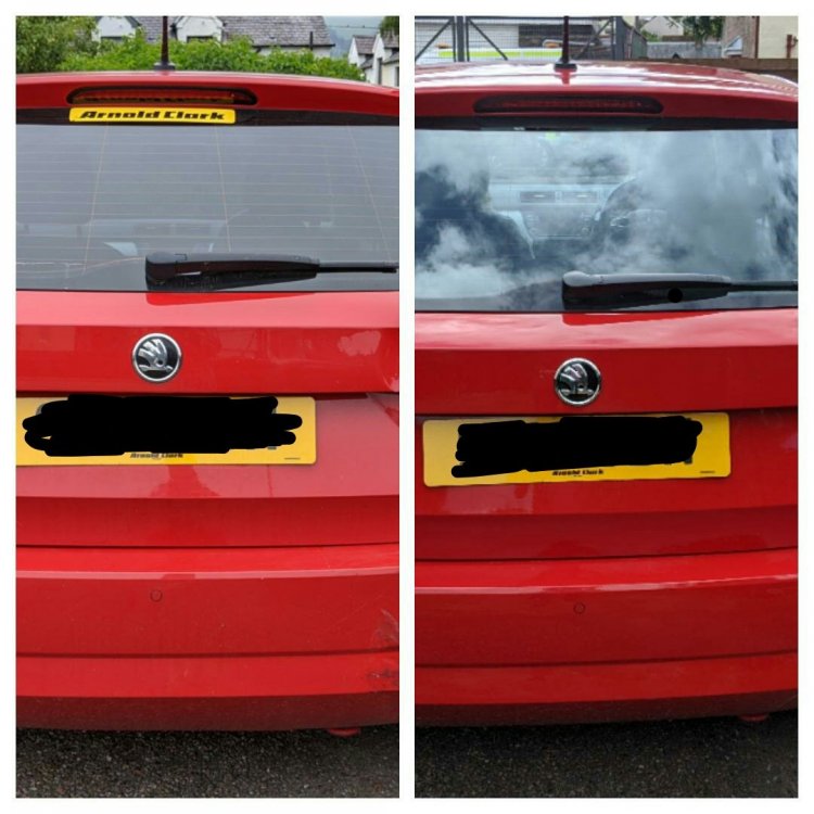

I really appreciate everybody's feedback on my original post, and I've come back for an update and to ask another question.  Amazingly, my insurer accepted the repair cost, and 5 weeks (yeah!) later I had my car back.  There was one immediate issue in that the rear windscreen was replaced with un-tinted glass when the original was tinted.  You can imagine it looks pretty stupid now with tinted rear passenger windows!:angry:  Unfortunately, rather than telling them to shove it and fix it properly before accepting the repair I agreed to take the vehicle away and return it at a later stage to get it replaced...school boy error.  Now 9 weeks later I still haven't had my rear windscreen replaced.  They have been dragging their feet the entire time and then tried to say I got factory tints fitted after I bought it, which is absolute b*****ks.
Anyway, I think I got my message across but they keep saying that they are chasing the parts supplier which makes me suspicious.  Is it not pretty easy to find the correct part from Skoda and just order it or am I missing something here?  I know that a glass company would fit it but surely there wouldn't be a problem sourcing the windscreen itself?  Does anybody know where I could find the part no. for such a thing?

p.s - here is the before and after:

My money is on one of these two as my car has a roof antenna and pretty sure has a "diversity" window antenna (8L5) due to the vertical lines in the old rear windscreen.  The 4KF code confirms the privacy glass from the B-pillar backwards including the rear windscreen.  This link to somebody selling the 6V6 845 049E part number is the closest online I've seen to what I need.  I've contacted Skoda CZ but they are insisting only on giving me information using my VIN if I want to make a complaint!!
