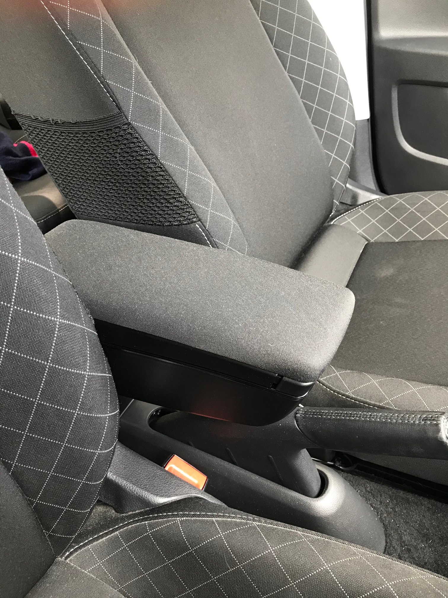

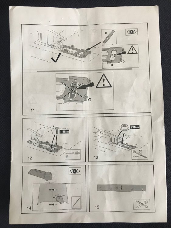

I purchased the genuine armrest from the Skoda dealer for £139 which is cheaper than anywhere else I could find.

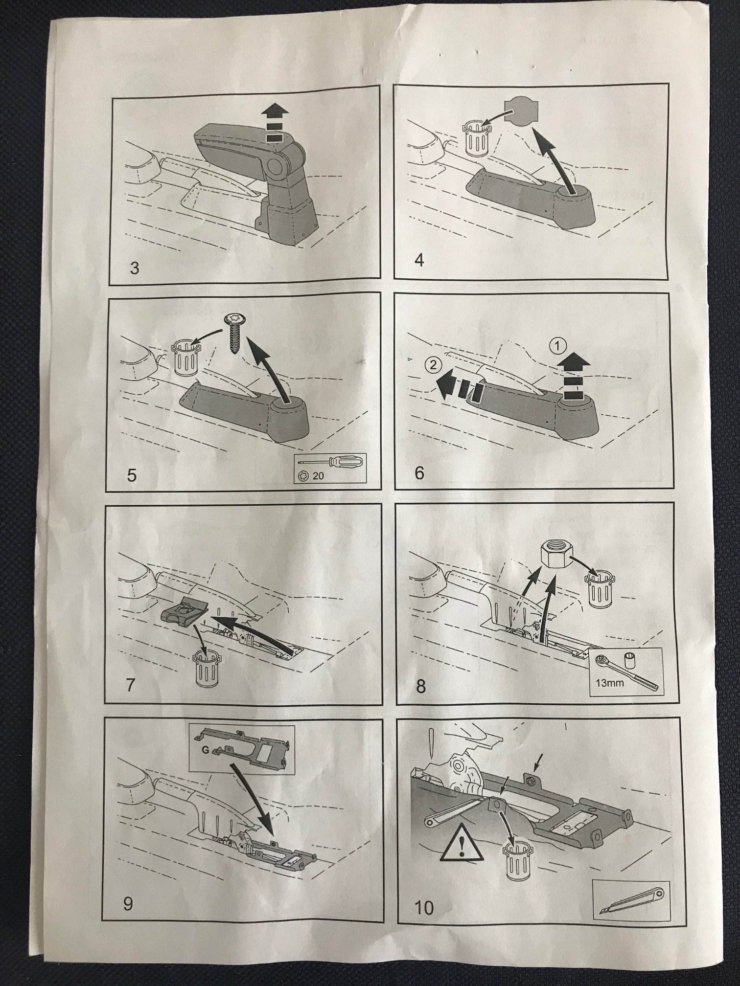

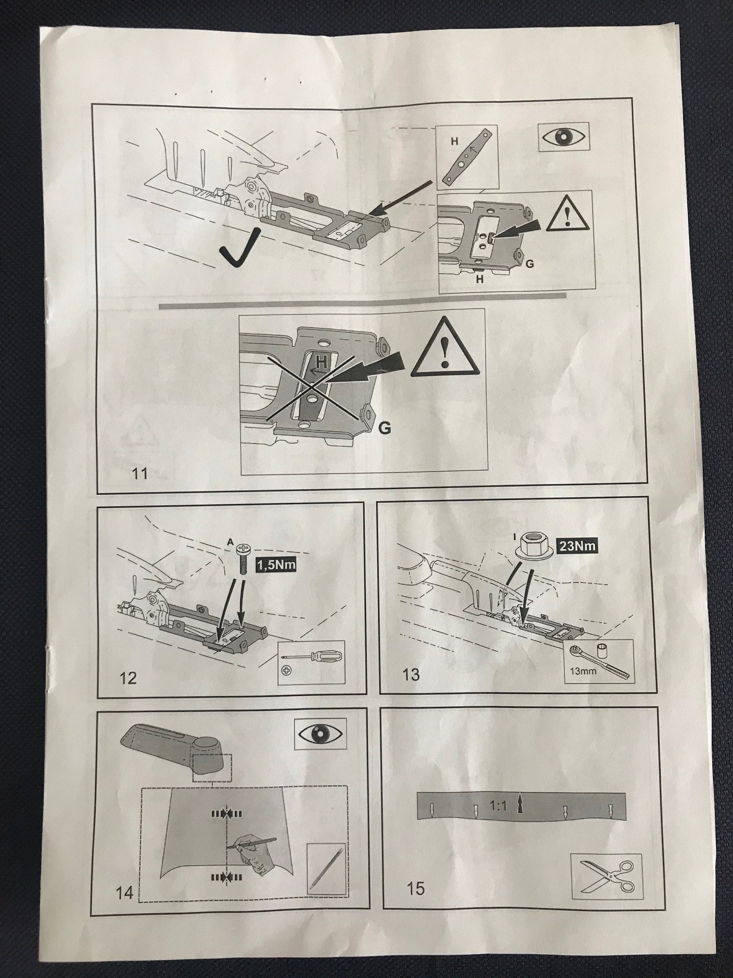

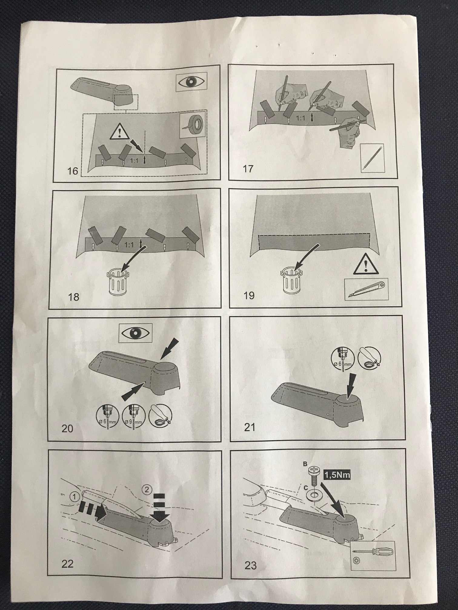

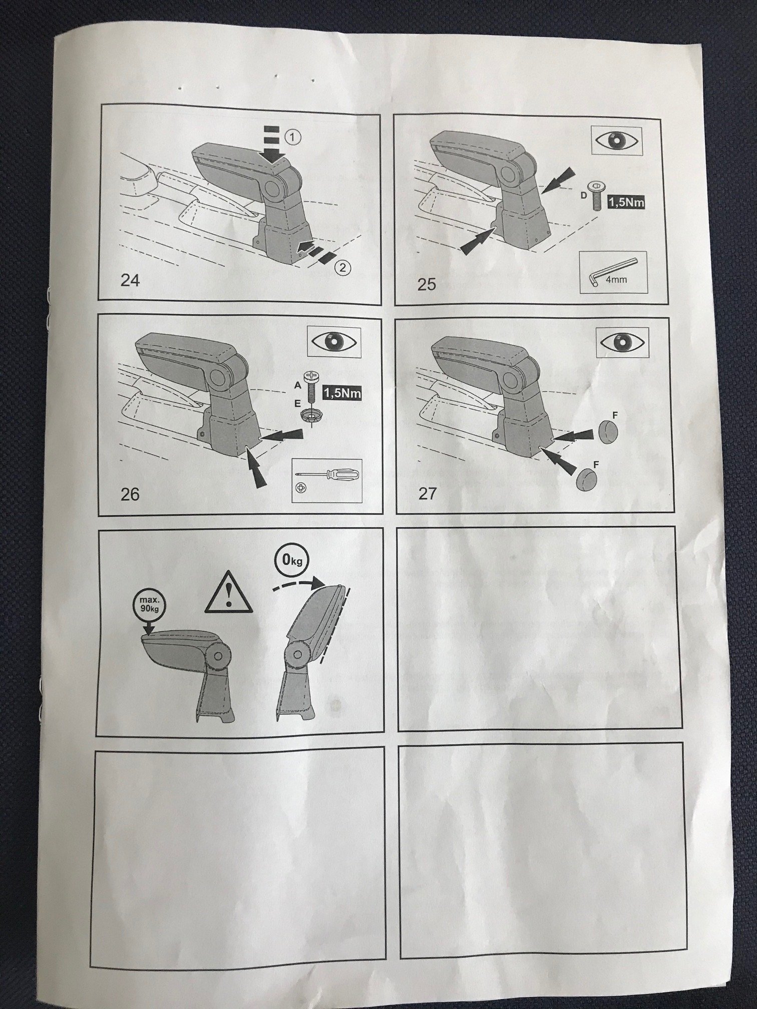

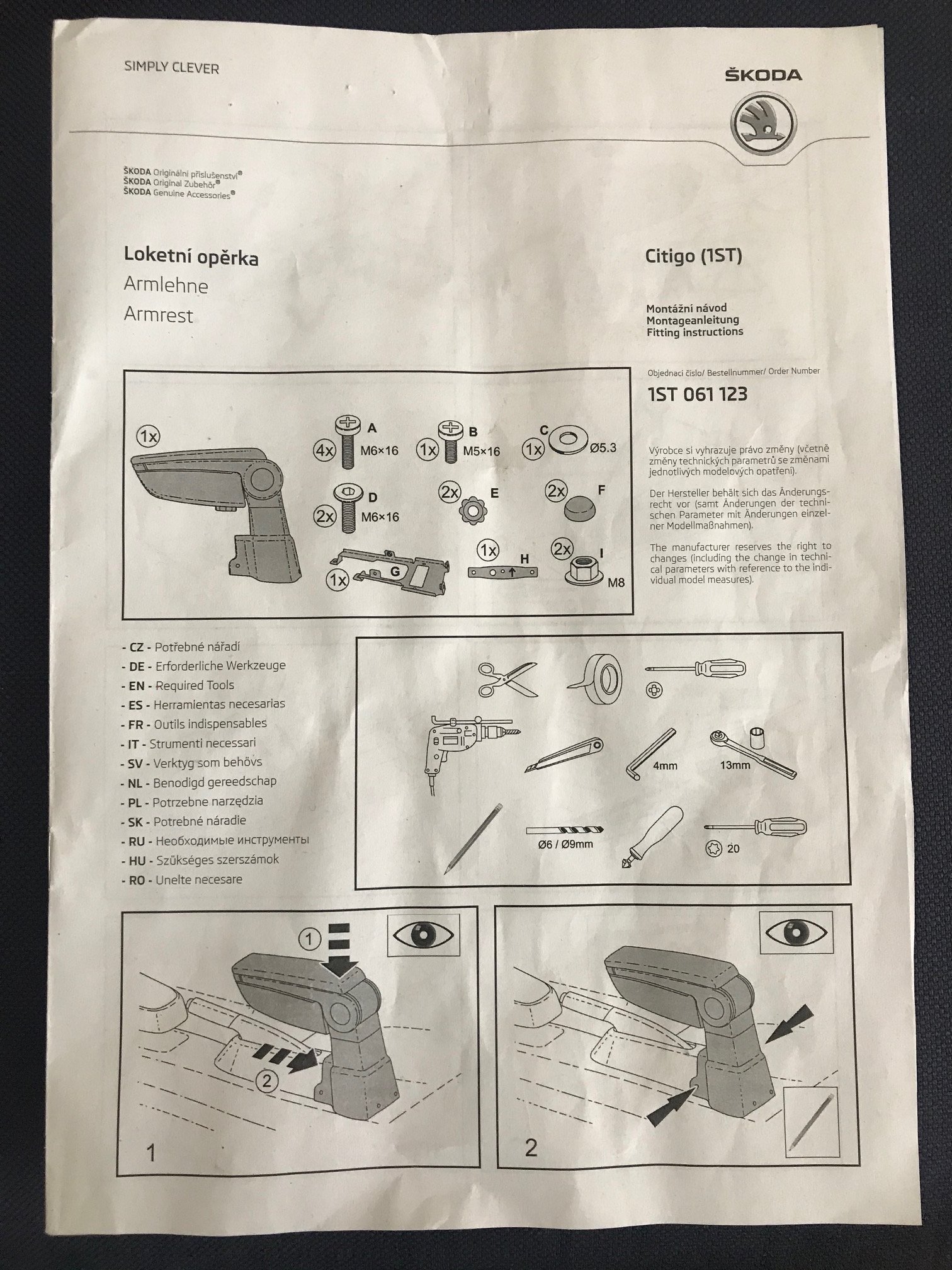

I thought I'd put the installation instructions on here in case anyone else was thinking about fitting it.  It took me 2 hours to fit taking my time, I used a boring tool instead of a drill and I didn't torque the screws to 1.5Nm (not sure how I would do that!)  but someone more competent than me could do it in 1 hour or less.  I'd even say anyone could do it.  By far the most difficult part was #25, it's incredibly fiddly and took 10 minutes to get each screw into the hole, but that may just be my incompetence.
It's definitely a huge quality of life improvement, I don't think I could go back to driving without it.  Only negative aspect perhaps is that it is pretty slim, cant really be shared with a passenger
