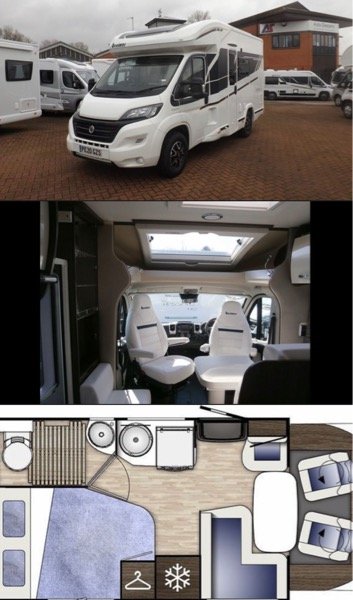

Appreciate it isn’t even Skoda related never mind Superb III but to conclude the thread...
Today we put a deposit down on a Benimar Mileo 231. 20 plate, just registered on Thursday! It’s a Fiat Ducato cab with proper 9 speed auto box (new model without the horrid robotised “comfortmatic” gearbox). 2.3 litre Diesel engine, 150bhp 💨
There was 4K off in the “sale” but negotiated down another 2K plus them fitting a roll-out side awning included.
The infotainment system looks pretty basic/cheap compared to ours in terms of GUI but it has European camper van sat nav which is cool - you can dial in your dimensions and any onboard hazards (flammable gas etc) and it’ll plot your route making sure you’ll fit / are allowed etc.
Looking at some YouTube vids it also looks like it has Apple CarPlay and Android Auto too which will be a nice bonus if it’s standard.
Full alarm/tracker plus a solar panel that can run the electrics for about 5 days from full before the battery gets low. So we can do a bit of off gridding but I’ve got my 4G router so I can still annoy you all with my posts 😉
Thanks again for the advice
