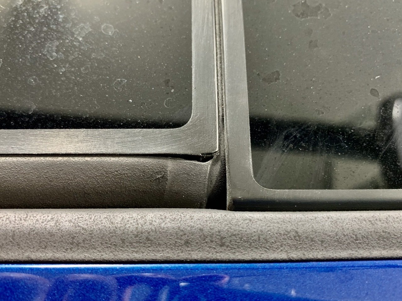

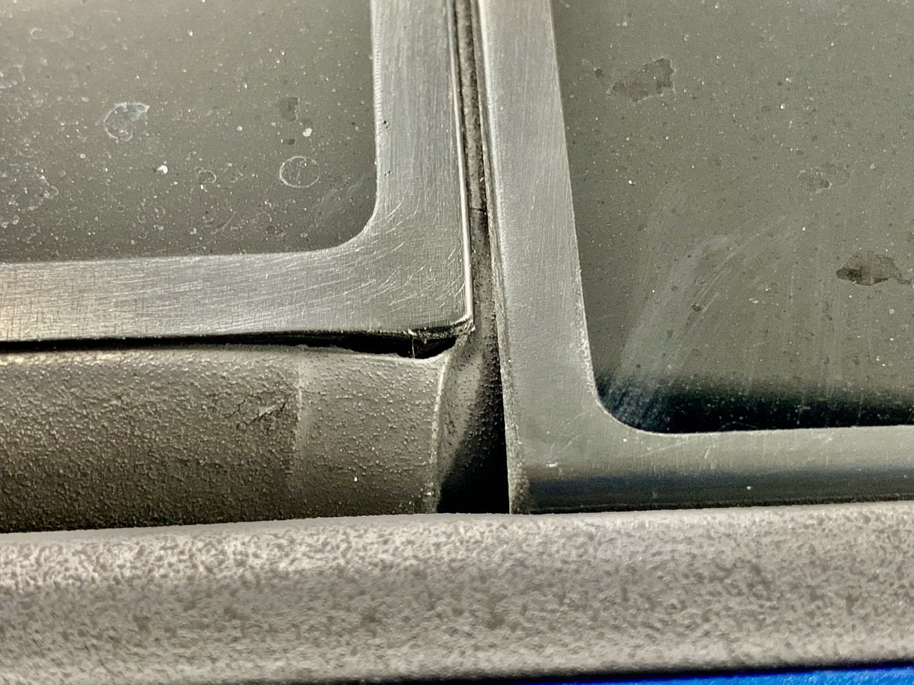

have noticed a gap between the frame and seal on the rear pane of glass. those of you with pano roofs - any issues ?
what's a good temp seal until dealer can fit me in ?
Having no leaks, paiyng no attention.
There's always going to be a leak round the edge of the moving sunroof pane, but there's a drain pipe in each corner to take the water away. As long as they're not blocked by muck you should be OK.
That’s what the recent recall/campaign is for (at least it is for the Karoq - the Kodiaq is probably the same). At the ends of the drains there is some sort of valve, like a teat on a baby’s bottle which can get clogged up with debris. Not sure if these are replaced or they will just snip the ends off and leave open pipes. This has always been a problem with VAG cars, mine is going in next week to have this done, together with the AdBlue metering issue.
