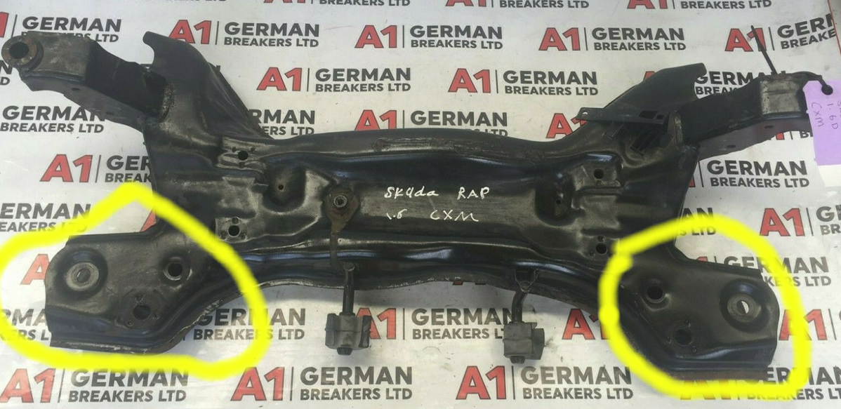

Sadly no replies here yet for you; I too have failed to find a good photo of the underside of a Rapid to help you. The front is straightforward; behind the front wheel an in about a foot or more are some solid structures connecting the body to the engine subframe. These solid structures will take the weight of the front end. image.thumb.png.917b3c30369b72b31a49adaf36150175.png

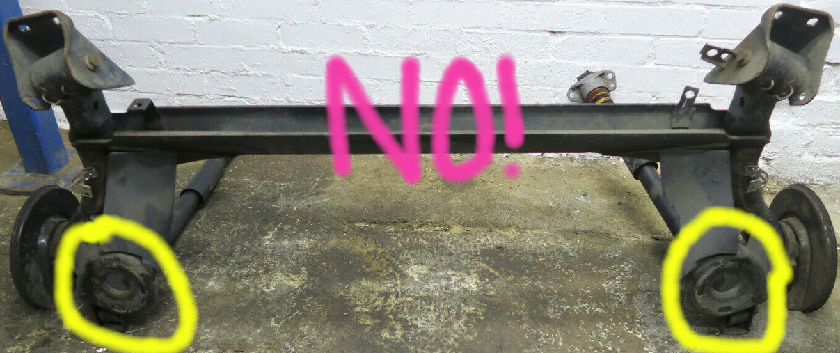

The back end is a little trickier. It's tempting to use the central tube / bar connecting both sides, but you run the risk of permanently deforming it. Here I would get under the base of the spring; preferably with a wooden pad or rubber puck. If you're not happy with that, then use the central tube right up against the end. image.thumb.png.5fd15bb661117e38a47698f6194e4262.png
I've used the points mentioned for front (axle stands) after getting the car jacked up via front sill jack points. For the rears I again jack at the rear sill point and do use that cross beam but at the very outer edges I place the stands, it seems strong enough no flex.

Hmm.... Maybe not place the axle stands under that rear cross beam then, you'll need to lower that to get the springs or shocks off. I'd jack on that then place the stands (with suitable pucks or a wedge of wood) under the sill jack point.

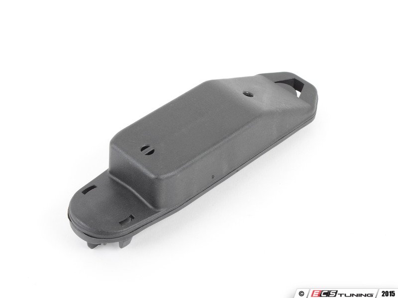

I recall seeing the factory lift points at the rear and at the front in the position shown on the diagram were 2 round brittle plastic shields with a flat edge, they were let into and flush with those stupid plastic insulator shields which get broken if you use axle stands on the cill seam, I very nearly jacked up on them thinking they were metal.
I think I levered one out and there was the round pressed cup shape donut underneath, I could not understand why it was there and why they went to the expense of covering it, being a factory lift point makes complete sense.

I will need to retrofit the rubber parts, I was describing the plastic cap covering the metal location piece spot welded to the floorpan.
The bits are expensive but there is something very cheap on Ali-Express for a Tesla which might fit or could be modified, I may give then a try but only if the Yeti has the same lifting points.
@J.R., is there not an official replacement plastic cover that has the same effectively as the Audi TT hard plastic peg that gets driven up into the rubber protector, and something else for the rear points?
My Octavia 2 has those OE covers fitted and I once nearly made the mistake of jacking on them.
If the Yeti has the same set up I want to replace them with hard rubber adaptors that I can jack under, there is only one place at the front of the car to place an axle stand safely and its the only safe place to jack as well, I dont like lifting on the sill in order to use the axle stand under the suspension point, those 4 factory lifting points seem to be the answer.
At the rear its not so bad as I have a towbar that I can jack under. At the front its the undertray that causes all the grief.
I looked under the car and I noticed that in the rear there are two holes on each side.
These Audi TT lifting pads 8N0804583 (+ 8N0803855) should fit just fine in the rear. But alternative to the rear could perhaps be 8V0802847A??? Not 100% sure.
