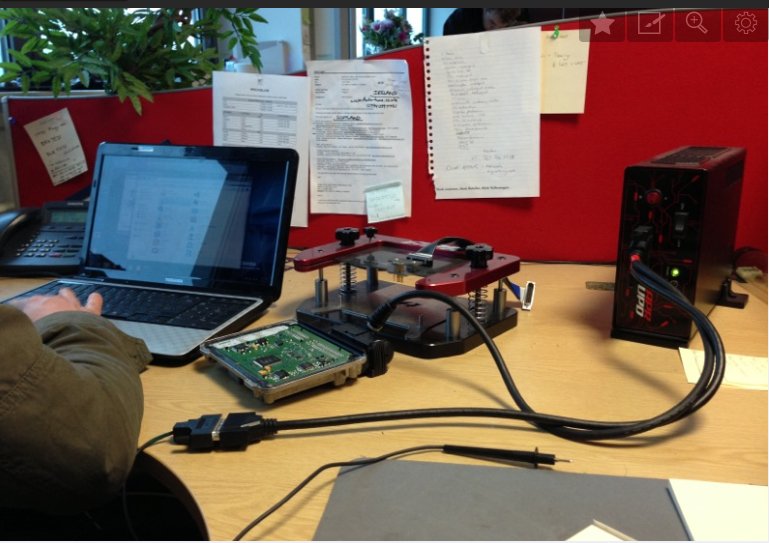

Usually the ECU's are not locked, but on occasions the VW Group / Skoda have locked ECU's and for the latest WLTP / & RDE2 certification they might well have locked ECU's.
Tom Jones sang about it. 'It is not unusual'.
So the professionals that do new engine management / write maps and re-map vehicles will be the first that may find out as they get their hands on a vehicle to remap.
It took nearly 2 years before the 'well established companies like APR / REVO and others' could actually have a remap for the CTHE 1.4TSI / TFSI that could be done through the OBD, even though they were advertising that they could.
There were APR Dealerships even opening ECU's and not able to remap.
The CAVE engine before from 2009-2012 had different ECU's and of the 3 you had to open 2 of them to unlock & remap.
