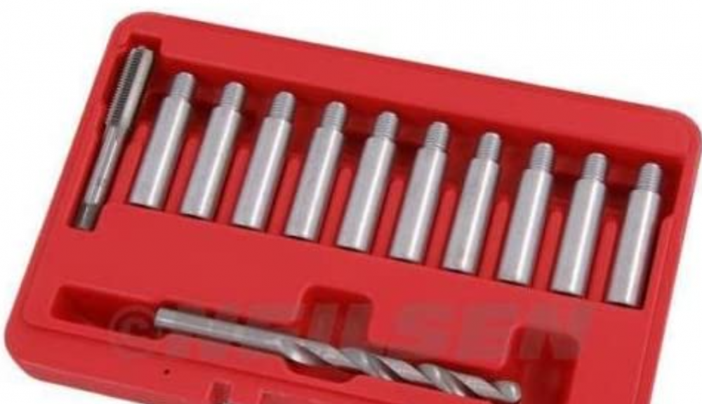

I had a look at the kits and they insert a thread the same as standard, after first removing the pins and drilling/tapping new threads. Look fairly do-able but I then saw an even simpler variant, where the kit had bigger threaded pins, again in tens, where you just drill, retap and no need to fit insert as the pin has M10 not M9. (eBay). Type (cut and paste) in the details once on eBay
Brake Caliper Guide Bolt Thread Repair Tool Kit Set - Ford GM VAG VW Audi
That was the later, simpler kit. Bit pricier but still a good price.
I was looking around and have seen the earlier type one a little cheaper with a make an offer so I am waiting to see if they accept. I also saw someone who sold three sets of the insert type kit for £14.99 so that was worth asking them if they have more as its around half price!I I am now of the opinion, the later type are simpler so worthy but the threaded insert type are more adaptable, for other areas of worn thread of the same size. So, ease, get the pin version, adaptability, the insert type. I will update on what I choose. If I get a good deal from the lower price seller, I will post that as they may be "Just worth having" for fifteen notes!
I have also seen very low cost ones, of differing threads/sizes so it has opened up a new world for damaged threads!
I had a small concern with the threaded ones as, although I read that the thread will be stronger then the cast iron one, due to being steel, I wondered if on unscrewing the pins to change pads again, the insert might just come back out again and then, you are re-fitting it into the cast metal again. I suppose knowledge will make you cautious, though.
It must be remembered that these pins must fit parallel to each other as the caliper hole to guide pin is a very small clearance fit, any miss-alignment could cause binding of the caliper on the pin. Ideally you would want the drill and tap to be bushed to the caliper hole to allow re-machining with the caliper in place. The image in the link supplied by Wino is not clear enough - the tap looks shouldered but a long way up the tap - has anyone used one of these.
The pins have a shoulder behind the thread so unless the thread is very misaligned if they are tightened hard they will pull into alignment, otherwise they can be persuaded with a few hammer blows.

 The shank on the tap is small diameter so you cannot be sure that the tap will run square to the carrier This is what should be bushed to centralise in the caliper hole. Also if the drill does not cut square to the carrier and does not run concentric (centred) in the guide pin hole you could get slide stiction issues. Agree than hammering in not the correct method.
Would like to see the instructions for use of the other system mrgf showed, looks like some sort of jig included to increase accuracy.
Funnily enough, that was the set on the other thread/post. The one I actually discovered was the one with the pins but I popped the other up, to highlight the difference. I am unsure about instructions but one seller suggested looking at them in use, on youtube...

So, I drew breath, got prepped and undertook the job, this morning!
I took my time, got all the necessary tools, trolley jack, axle stand, wheel chocs, wheel removal tool, etc-etc. Plus a cordless drill, to do the drilling for the inserts, as I had the two threads go. (The second, I must add, by a mechanic who told me he'd had done it up properly, as I had left it loose, when he fitted a new brake master cylinder and bled the system)!
So, with removing everything, checking the threads, drilling, fitting the inserts and re-assembling, then putting the gear all away again, I spent two hours.
This would most likely be halved if I was working from a garage but I had to get the stuff to and from a shed and was working in the street, outside.
The inserts are a fairly tight fit and I would recommend using threadlike compound on them, as advised any way. The Laser website has full fitting instructions, which I downloaded and printed, and also will point out, the inserts go in to the holes the opposite way to the caliper pins, so as to resist coming loose. I found the best method of fitting them in the new holes to be a gentle tighten with the caliper pin, then remove said pin and gently squeeze the insert a little more with a G-clamp. repeat until happy the insert is full home.
I did it this way as I did not trust the insert to strip again with too much pressure on the pin, when screwing, whilst I did not want to distort it by G-clamping it too hard, either.
(A little OCD but thats just me)!
The second hole, I drilled and just ever so slightly used the bit to ream the hole a little larger as the first was sooo tight and I assumed if anything, the drill bit would shrink as it drilled, making later holes tighter and tighter. (May be designed for ten holes but as mentioned, the first WAS very tight).
That action did make the second insert a little easier but then, so does practice!
I did also use the guides, provided in the box. As you can imagine, the original threads were stripped almost but not quite, all the way through. The pins stayed put but would still turn easily so I did not trust them. The guides, you insert from the opposite from fitted side, too and then slot the guide over, lining up the second hole, poking the drill bit though and gently drill the new hole. Not hard but worth using the guide, just to be sure to stay on the correct trajectory.
Once the insert is in, do the same for the second hole, if needed.
I would think the new inserts, being made of a hardened steel, would be less prone to stripping, unlike the cast holes but I still took great care re-tightening both during installing the inserts and re-fitting the calipers.
So, all in all, a few hours labour saved a fortune in fitting a new steering knuckle, which I think would have been beyond my expertise (HA)!

So there wasn't any thread-tapping operation, just drilling and press-fitting?
I didn't much to my regret... The tap that comes with the kit is just there to "Clean the thread" In order to assess its state. You are recommended to lube it and screw it in, to perhaps clean and rectify slight damage. Mine was almost all the way with just a little bit of decent thread left, to enable screwing the tap and subsequently the pins, backward into the holes, so to speak.
As this is the way to drill and fit the inserts anyway, it is easier to keep the wheels facing straight forward as I usually turn the wheels outward, when swapping brake pads.
The drill bit itself, is a stepper drill so it starts off small and goes bigger until full diameter. I suppose this is so as to help prevent the bit jamming and snapping in the hole. Drill gently, removing the bit a few times as you won't that!
The pressing of the inserts is straight forward but tight. If you can do brakes and drill holes, it should be easy enough to do. I would also think many users won't even bother with the guides but I did as I didn't want to mess it up. You might even think the complicate it more though!
I was nervous of tightening the inserts by cranking in the pins, which to them in so as I mentioned, I staggered this by part tightening, removing the pins and then clamping a little more, then pins again, etc. No stripped threads, no crushed/warped inserts/
They are quite tough little inserts but I would recommend pressing rather then hammering as that is asking for issues. When the inserts are fitted, they don't obstruct the caliper fitment, which is something I was worried about as they do protrude from the hole by a few mm but there is easily enough space. No need to over drill (Countersink)  the outer edge as I have seen people do with other insert kits. I would imagine this to actually weaken the hole slightly. I did mention I reamed the hole slightly but it was really just passing the drill bit through the hole at high speed a few times, with very slight pressure to make a very slight change to the diameter. Most likely better not to, then over do it though! Just work the pressing/ pin screwing a bit more at a time...
One over thing I noticed is the new threads seem quite tight on the new pins so be careful and you won't strip them but they will almost certainly need to be turned with an Allen key or something. I think the Allen key provided will do at first, so as not to over force it and perhaps finish with a ratchet/torque wrench to obtain a better tightness to the completed job.
