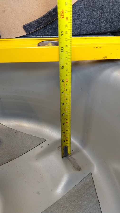

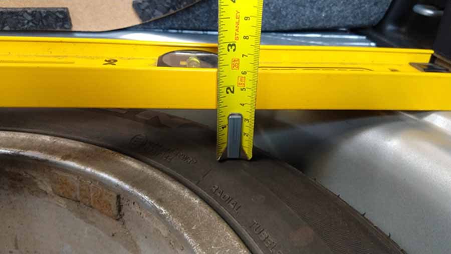

On 15/07/2020 at 15:48, PhilMacInnes said:
Will 215/45 R16 fit in boot without lifting cover?
I would say yes.
Photos of a 185 60 15 on a alloy in my boot.
The limiting factor for me is the tool kit, not the tyre/wheel width.
Thanks AG Falco
Edited by AGFalco
added I would say yes.
