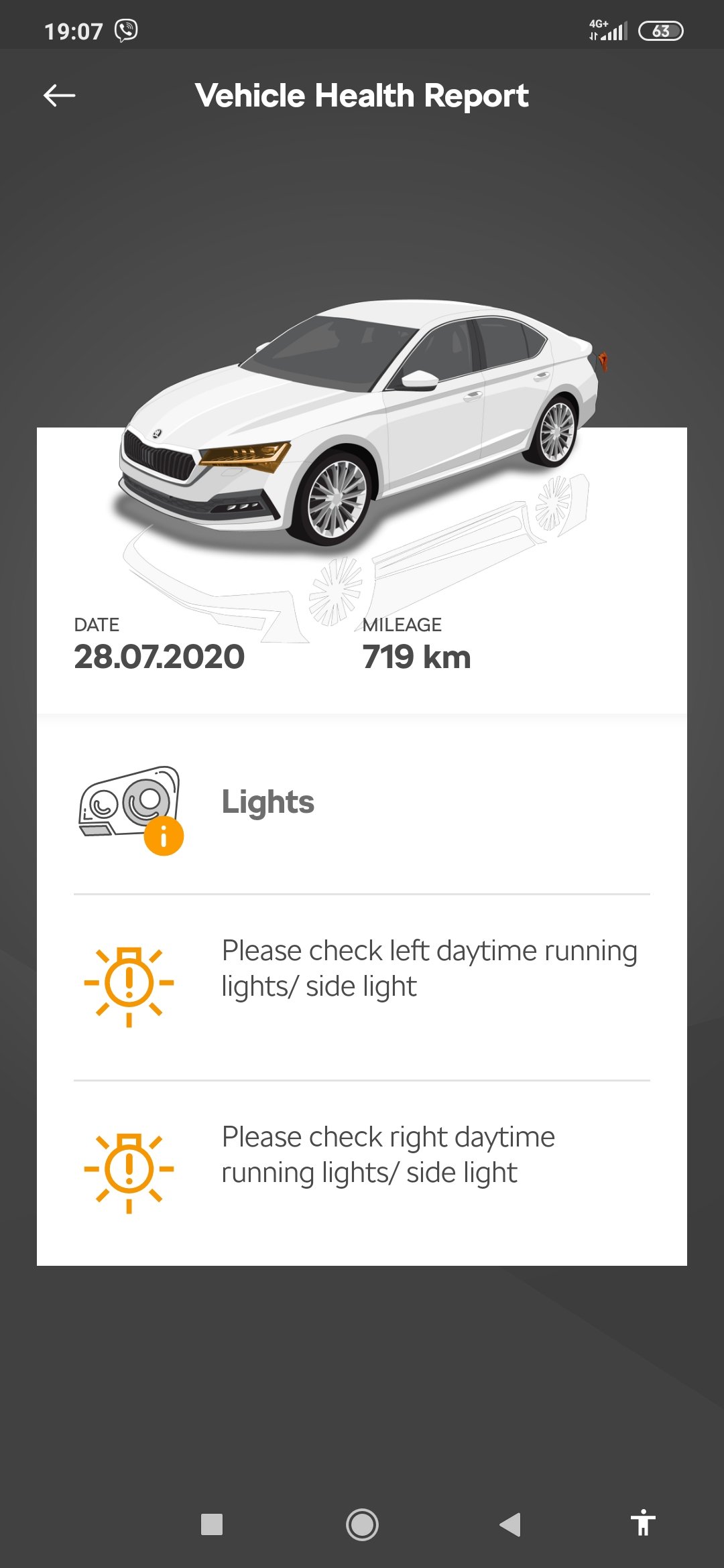

One other thing happened today
I got two error messages for my DRL lights.
After I locked the car for 5 mins I got back again, the error was gone.
Btw the DRL were working.
Edited by OctaviaMK4
Ok folks
Went to the dealer today. They found out that the DRL lost connection for a split of a second and hence the above issue.
Anyways they reported this to Skoda directly.
