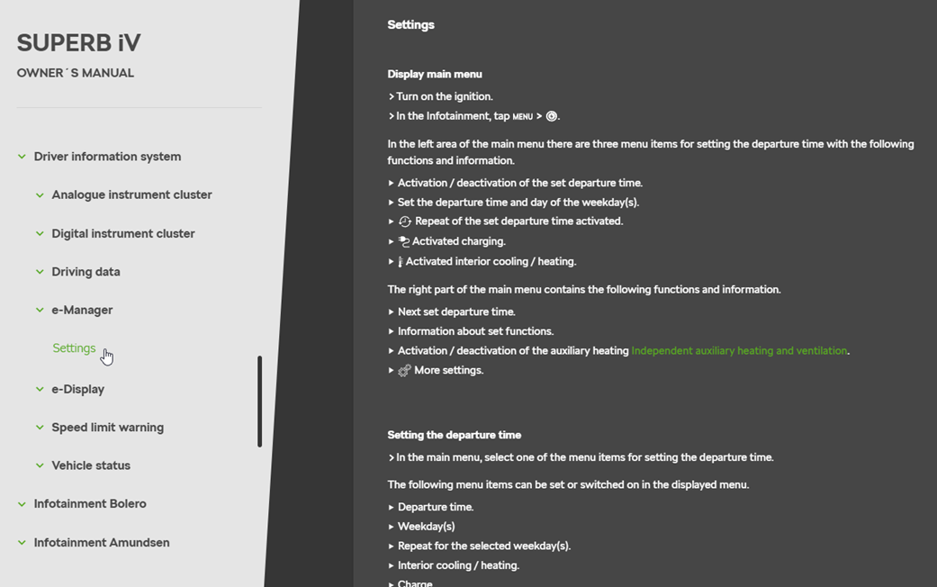

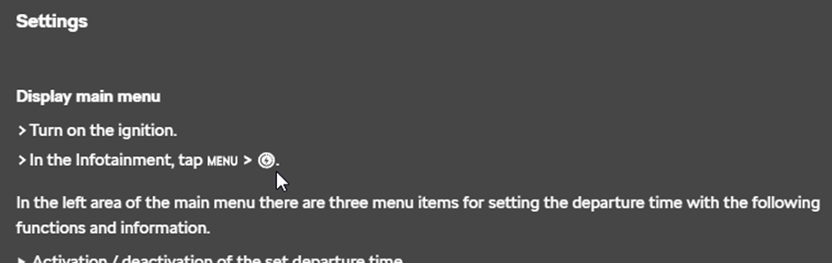

The other way is controlling the charging via the Columbus/infotainment system (I just failed to find that in the Owner’s Manual and had to use the Search Function) but I don't think you can charge to a pre-set limit via this method. I just went out and had a look to check! The Columbus mirrors the plans set via the MySKODA app in time, date and charge rate but not the charge limit. I reckon you need the app to do that.
For setting the charging time up via the infotainment system (you've probably sussed this already) in the manual, it’s actually under Driver Information System >>> e-Manager >>> Settings
Hope that helps!
