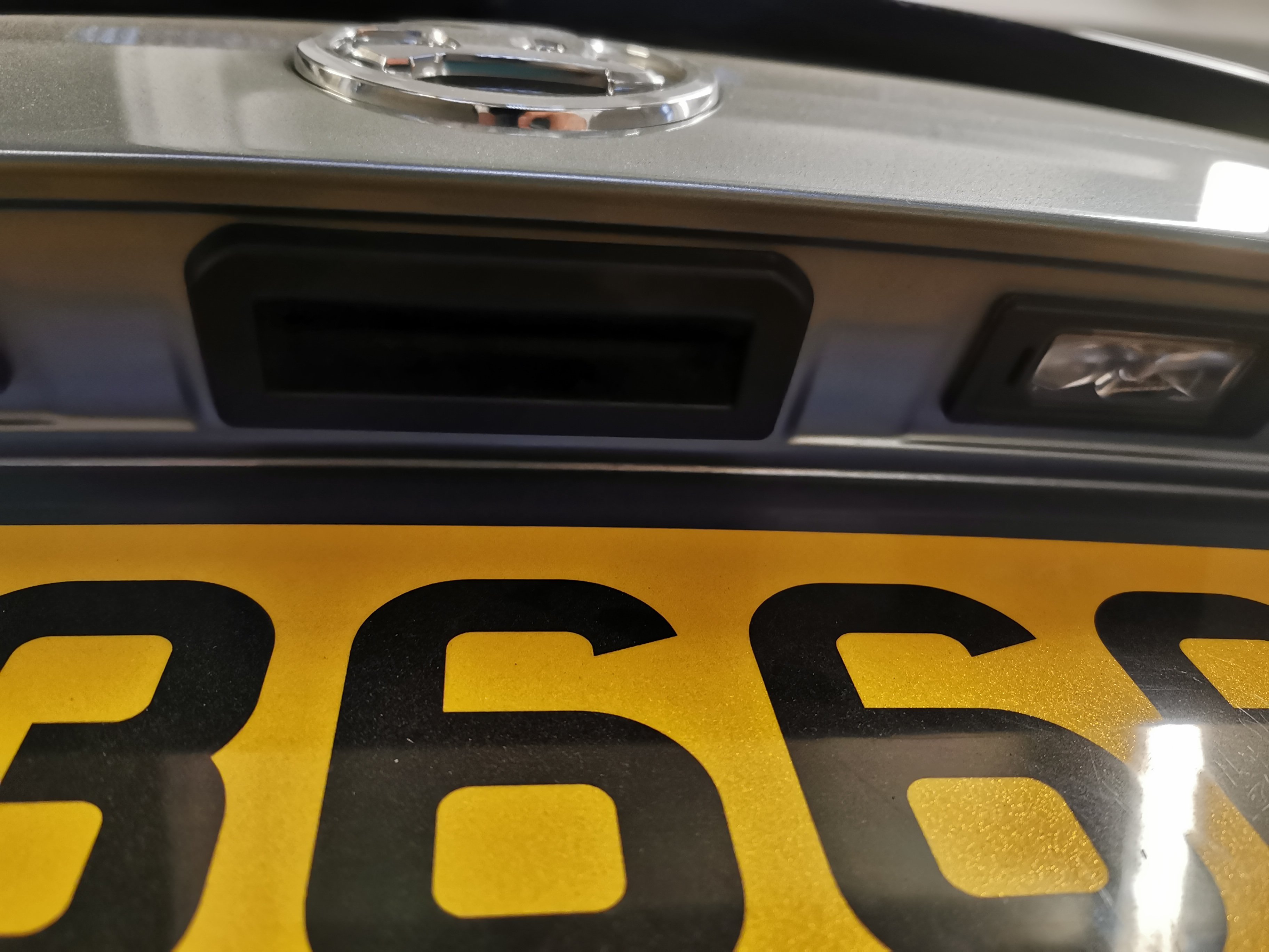

Check your boot handle, if it is a perfect rectangle you can use any camera that is in a 112x48mm handle with the correct dataset on it so on the blue car there I used a 5E5827566G handle and the green car had a boot handle with curves on the outer edge which needs a Kodiaq handle, 566054634A. Unfortunately I’m not planning to come to Jersey but if you don’t have VCP yourself make sure the correct dataset has been loaded onto the camera you order. Both part numbers above are Highline with washer.
Sasha this is some amazing invaluable information here thank you so much.
So i did a bit more research and
1- my boot handle seems to have those curves

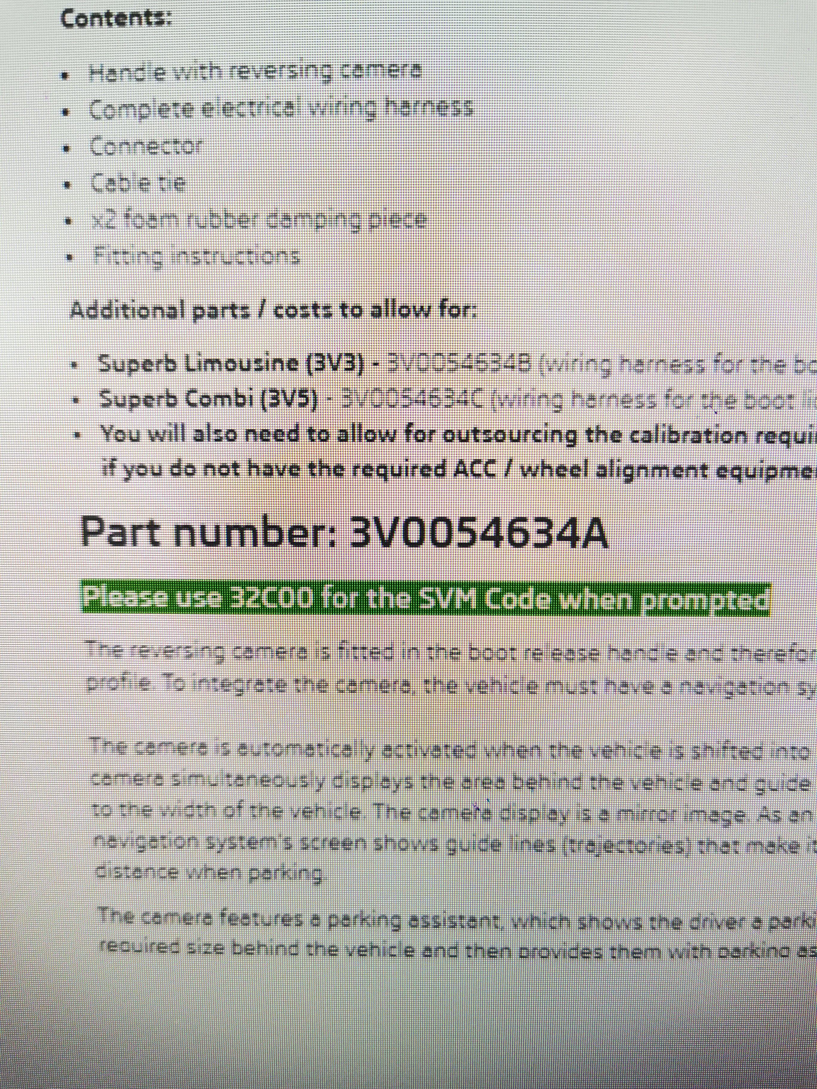

2-my local Skoda can only supply camera with part number as on screenshot below(would that be suitable even my head unit is 3V0 919 606 D, would that be the same camera as you suggested above?
Sorry to be a nonsense just trying to make sure I'm ordering right thing,
3- is coding it in very hard? I have access to Skoda systems so that could make it a bit easier....
That part number is fine, it’s the Superb one, not the Kodiaq one but it’s the same thing anyway. 3V0919606D is the radio screen part number, your radio will be 565035020x without SIM or 565035021x with SIM and they both take cameras, all MIB units on UK and Jersey/IOM etc cars take cameras. Coding is very easy, one change in 5F and one in 10/76 Park Pilot. Easy enough once you have the dataset on the camera but if you are adding with ODIS it’s really really easy.
