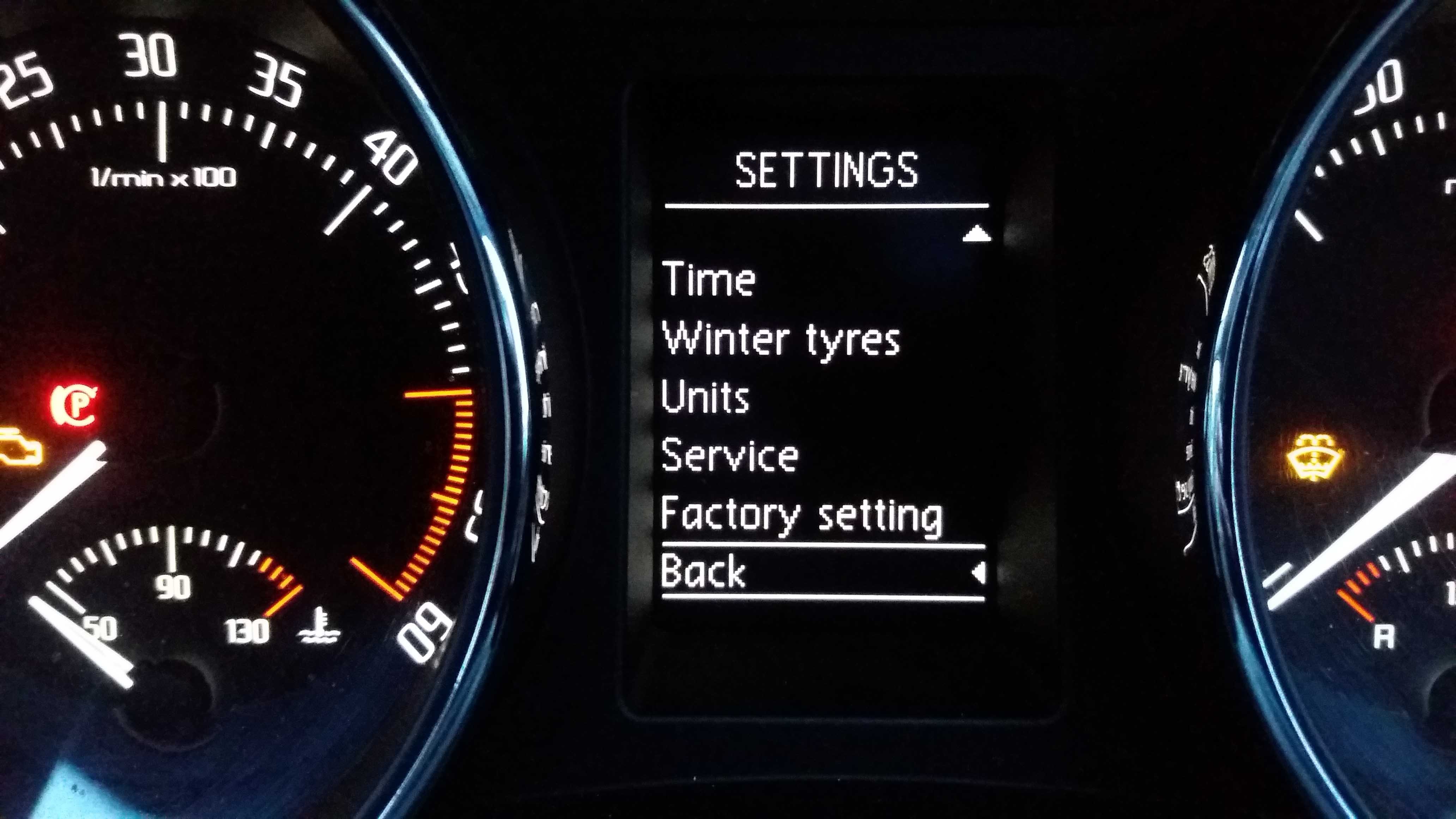

You should use a speed index to cover your car's top speed. You can go higher, but that often means you get a racier tyre which is often more expensive. If you drop the speed rating you have to remember this. Put a sticker into the dashboard or if your MFA allows set the lower speed rating in there and you will get a warning when you approach it.
