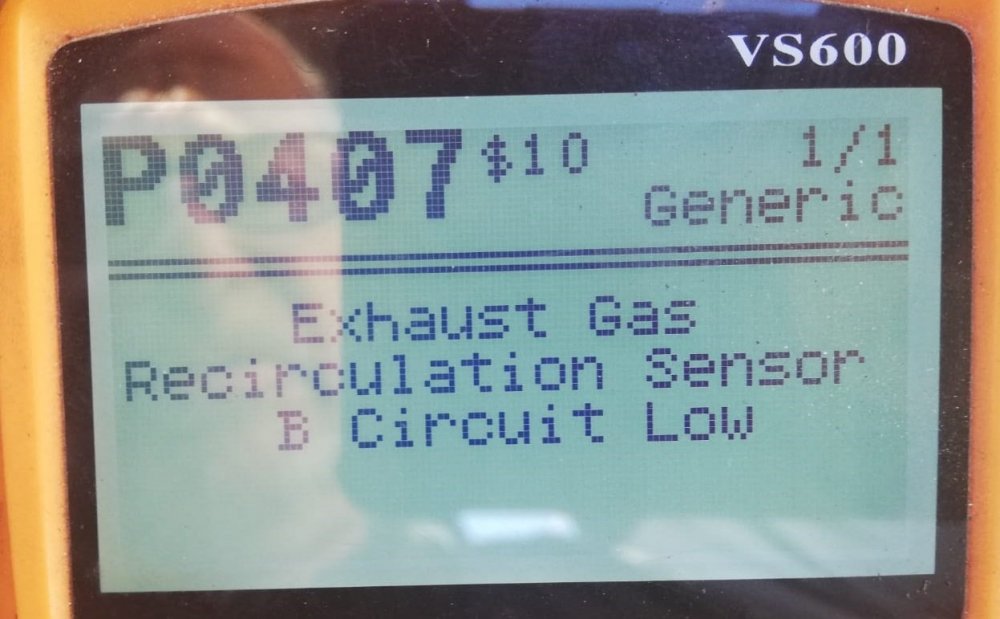

Then I had  the warning light engine check. Connected my diagnostic tool and got a PO407 error as attached.

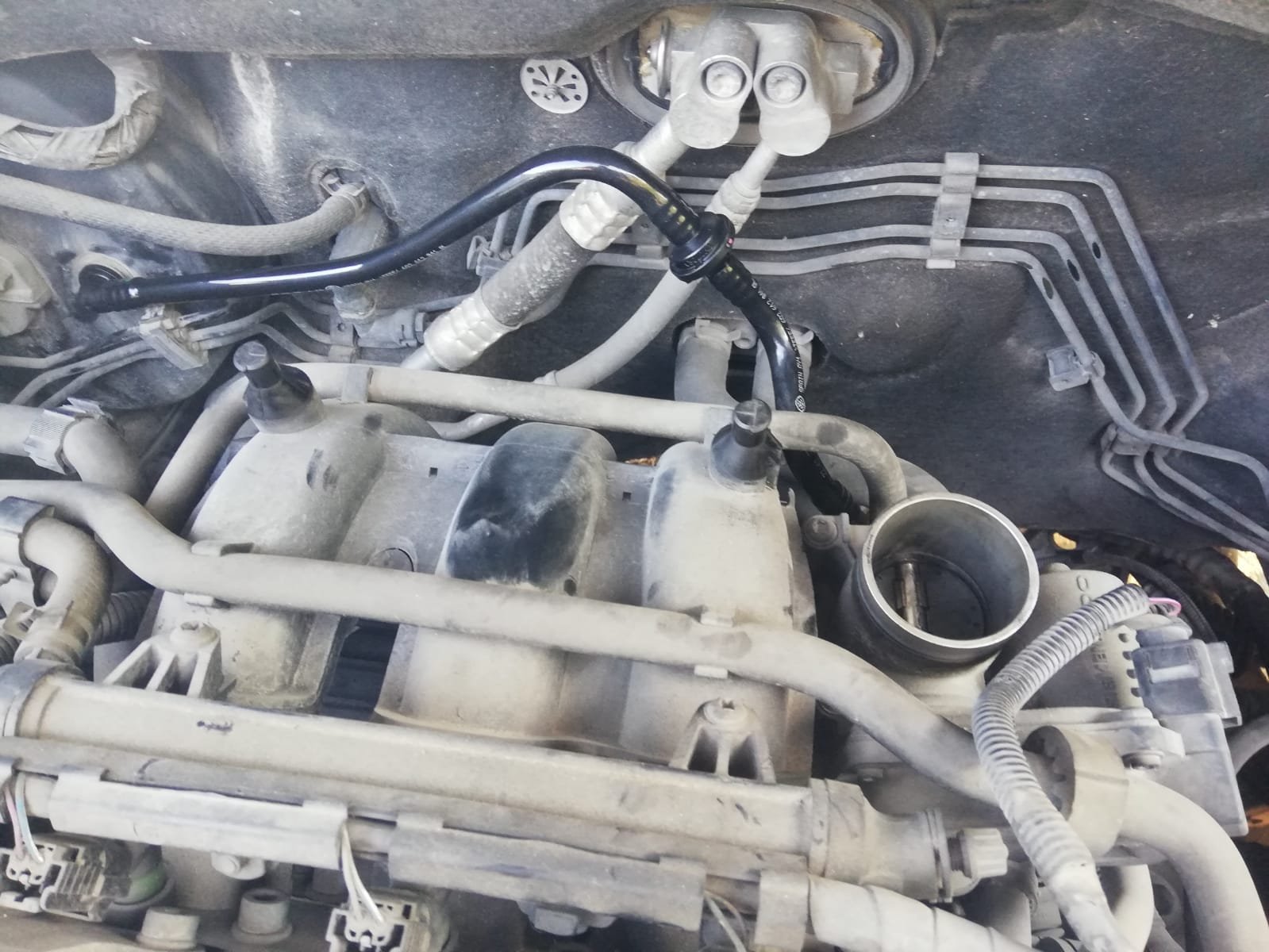

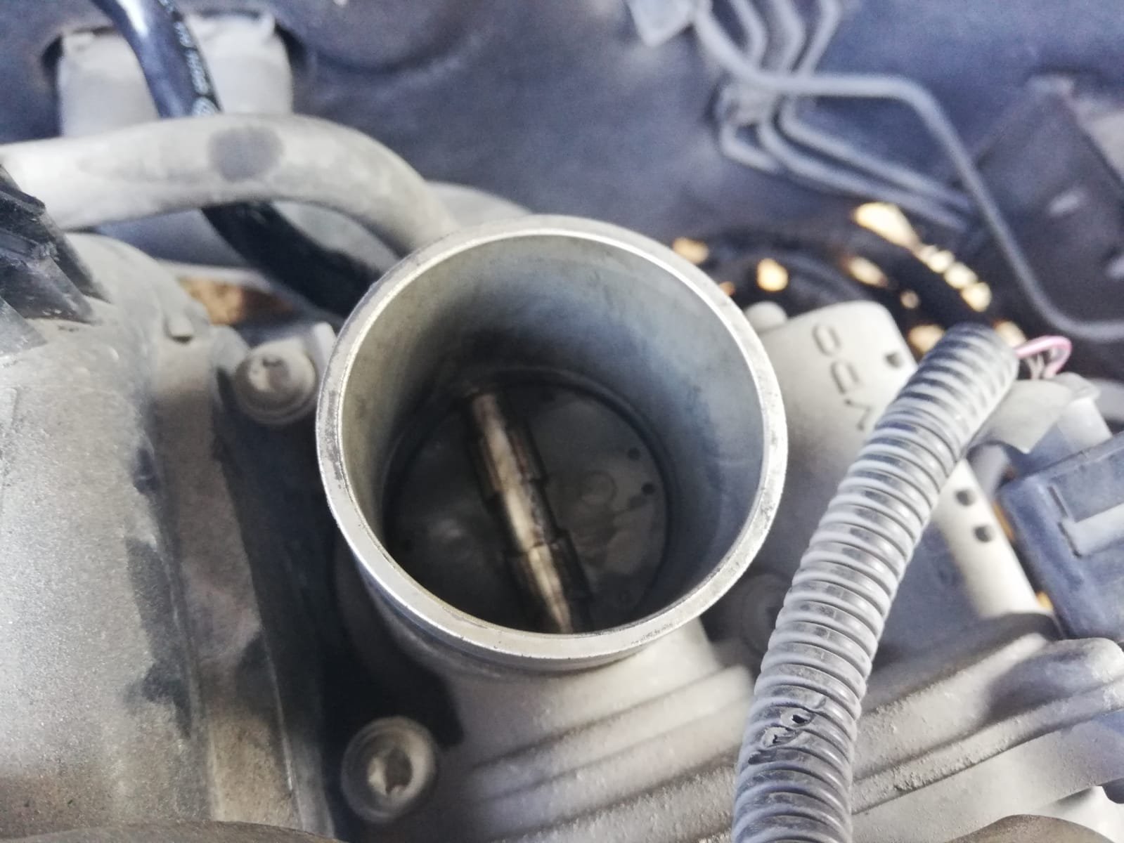

Since a service was carried out almost 2 months ago and the fuel filter was replaced, to star off i cleaned the throttle bottle with some cleaner and a cloth which was a bit dirty to be honest. Then i noticed that there was a tube related to the brake booster vacuum host was slightly cracked/damaged. I replaced that since i read it could be the cause, since it will intake air from there. Have checked the fuel cap to make sure it is sealing properly  and added some fuel cleaner with the unleaded to make sure the fuel system is in place.  went for a ride and worked like a charm for a day.

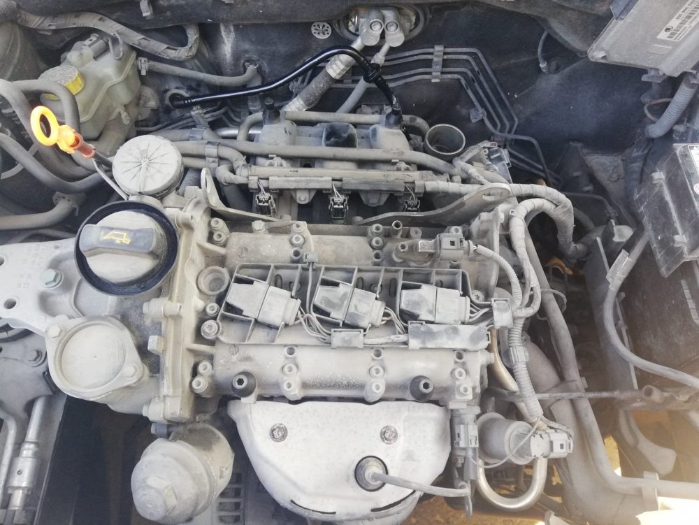

Can you post a photo of the front of your engine, with any engine top cover removed? I'm slightly surprised that a 2006 1.2 even has an EGR valve, as the BME engine code dropped that item in December 2005 to the best of my knowledge.
sure wino I will do once i reach home this evening,  since i'm with the other fabia. Could it be mine is a 2005 version since I got mine feb 2006.?

Dear Wino, please find attached engine images.

I've edited your first photo a little to point a green arrow at the EGR valve, and put a red box around a port on the PCV valve that you could try experimenting with.
With engine running try putting a finger over the small hole that I've put a red square around next to where PCV is written.  See if anything changes about the way the engine is idling.
The other thing you could try, since the fault code points to an EGR fault, is to unplug the electrical connector from the EGR valve and see how the engine behaviour changes when in the conditions where it was previously having trouble.

HI Wino, the following was carried out.
when PCV hole was blocked for a couple of seconds ,  i could here  a low pitched squeak but nothing really happened at idle mode.
regarding the  EGR Valve i removed the connector and went for the same drive. to be honest the car was working smoothly even at low revs and no light showed up. will try it again in the next 4hrs or so for a longer drivve to make sure it remains the same.
is this a dirty/damaged EGR Valve? I read this is just a solenoid that could be stuck could it be the case?

I'm not sure really mate, but it does look like the valve is misbehaving in some way, if the car works better when it is disconnected.  Wait for the confirmation on a longer drive before considering what to do, I think.
It is a valve that's driven by a proportional solenoid, with potentiometer position feedback, so a number of faults can occur and be detected by the diagnostics.  The P0NNN generic codes aren't as useful as the VAG-specific numerical codes which you could read with VCDS or a handheld scanner with VAG coverage.
e.g. 16785 flow rate too low
16786 flow rate too high
16788 control difference
17811 (as above)
17812 basic setting not performed
Quite possible that the EGR valve is sticking due to age/wear.  When ours failed in that way it generated one of the control difference codes, can't remember which.  I think it means position indicated by potentiometer doesn't match position requested by electronics.
Your PCV valve may have a slight leak, but not significant/critical if it doesn't change engine behaviour when you block that port, I think.
