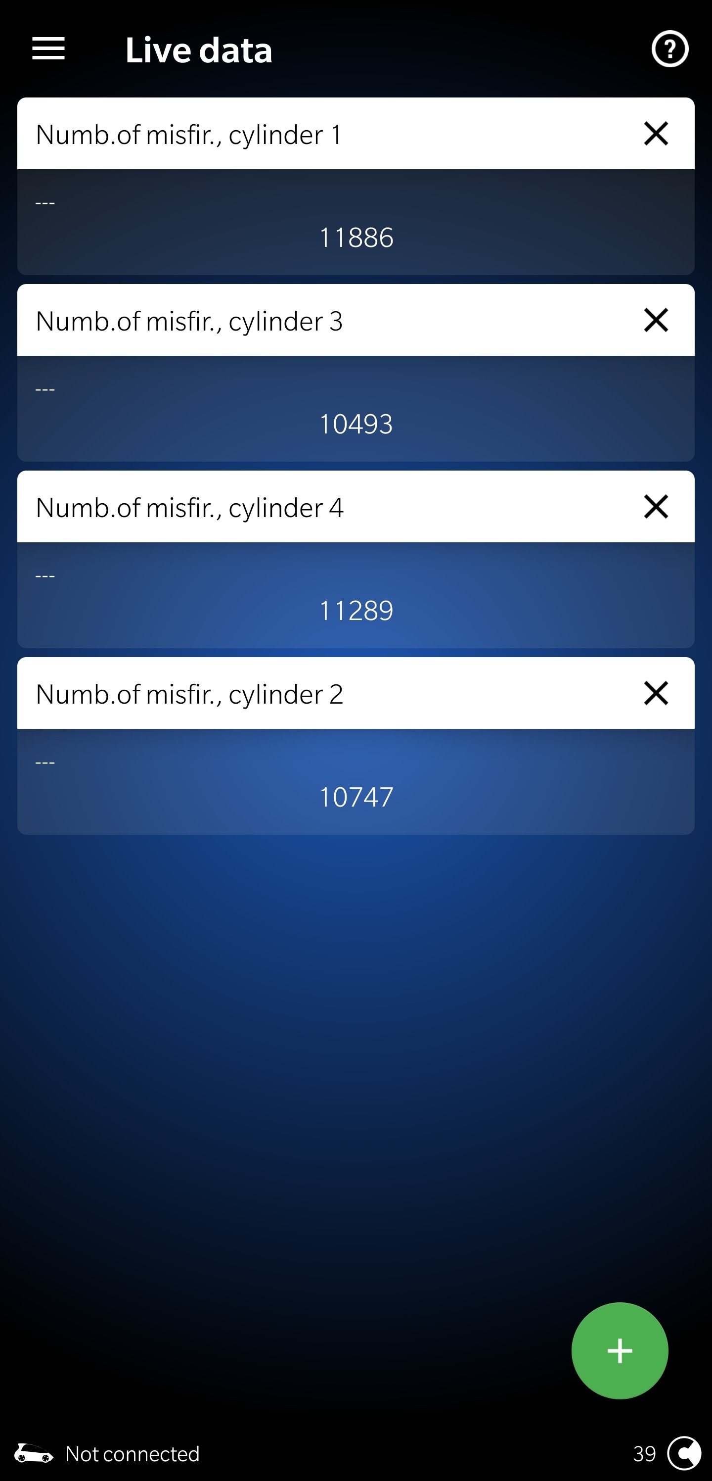

Only today did I decide to monitor the car on startup and noticed via OBDEleven that all cylinders are logging misfires (you can feel it happen when it does!)
It doesn't seem to misfire enough to trigger any codes which has me stumped.

(Screenshot attached from OBDEleven that was taken just after I disconnected)

@krigl at first I thought it could be that, it noticeably adds to these counts when idle which is the worrying part. it is also getting progressively worse/lasting longer when cold starting.

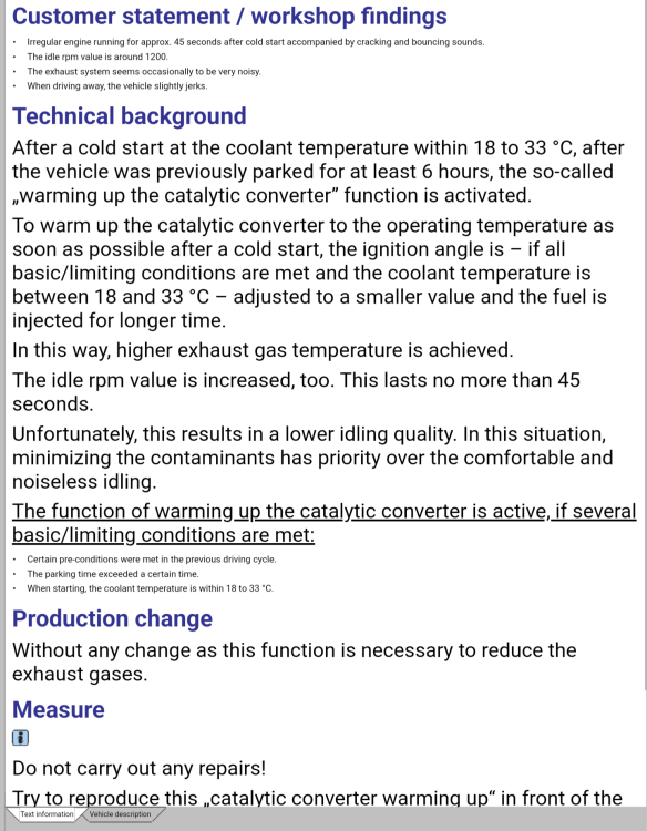

Hey, did you get the lumpy cold idle sorted? I have the same...

I got new coils recently and spark plugs, this completely solved the hesitation. Rough idle is only there with a hot restart after 2-3 hours but this is a documented (normal) issue to do with the catalytic converter.
Cold starts are completely fine now.
Note: I changed spark plugs at the start of this thread, that alone didn't fix the issue.

@steevsWho has documented this and said it was normal?    Is that on Social Media / Forums?
 Only normal if something is not quite right.   If it is someone at at Dealership saying 'They all do that' then they are telling lies.
Edited by roottoot
It's a TSB that can be seen in Erwin, unfortunately you need to pay to access Erwin.
So is there a Software Update or a hardware update for the fundamental fault, or what does the TSB tell you?
Has someone from VW Group told people if their car runs rough after a hot start after 2-3 hours then tough titty this is normal?
How is a 1.2 engine doing a hot start after 2-3 hours, is this in tropical conditions or something?
Have those with cars that start and run smoothly just ended up lucky?

Now it can be maybe Pinned on here so that people need not pay to find out when Dealership Employees do not demonstrate to the customer that running rough can be 'Normal'.
Also that when you open the drivers door after the car has sat a while the fuel will be primed before the car is started, or even before a key goes in the ignition if the car has a key.
Coolant temperatures of 18*oC- 33*oC are going to be uncommon when the car is used in much of the UK through winters where the Ambient temp is not even in the teens so the coolant will not be when the car is sitting.
So no issues or rough idling with Catalytic warming when the coolant is below 18*oC?
Just the increased RPM that might drop off after 40 seconds.
Edited by roottoot
