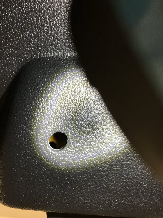

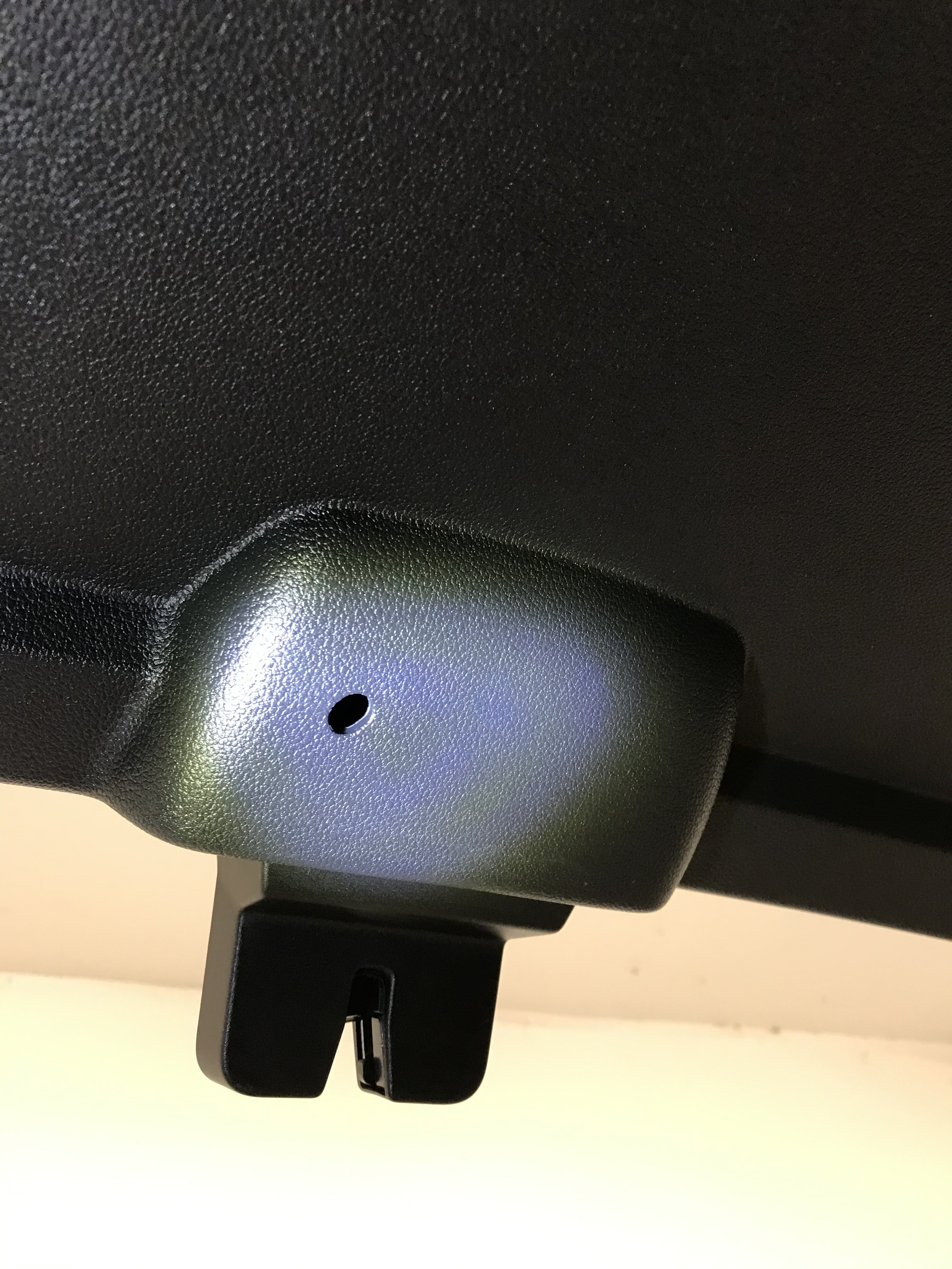

This is mine. The hole the torch is on is an emergency release. You can just about make out the yellow lever inside the hole in the second photo that needs to be lifted with something like a screwdriver as already suggested.
Thanks for that , my cover is not hard plastic like that its the faux carpet stuff , but now i know its approx position i can drill a hole and try and push it

I drilled a hole roughly where its shown on undertheradars car but cant see a release lever , took it down to a local garage they also checked it out and couldnt find a release so its booked in for them to sort , they did warn that they may have to wreck the trim to get at it , great design Skoda !!!! .
