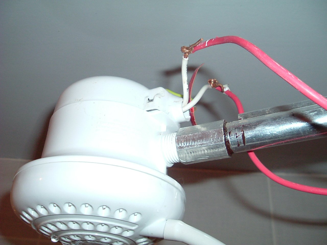

Attached is a photo of the wiring on a 240vac shower heater in a hôtel in Peru, Bolivia or Chilé (cant recall) where people were complaining that everytime they touched their bathroom taps they got an electric shock, it certainly gave a tingling shower!!
As you can see it was a brand new installation, no earth although it looks like a yellow/green conductor tucked up behind.
