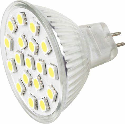

The last ones can be quite dangerous without a cover as can be found online.
Without a cover, some unsafe versions can leave you exposed to live high voltage.
All of mine have a glass front cover...   That pic was just one I found as typical of the type.
Although as it's an mr16 it's only 12v
Edited by skomaz
12 volt........... Got one of them. Just the one.

Just now, Tilt said:
12 volt
Indeed I hadn’t noticed that particular one is a low voltage, but the gu10 versions like that are not and can be very dangerous.
