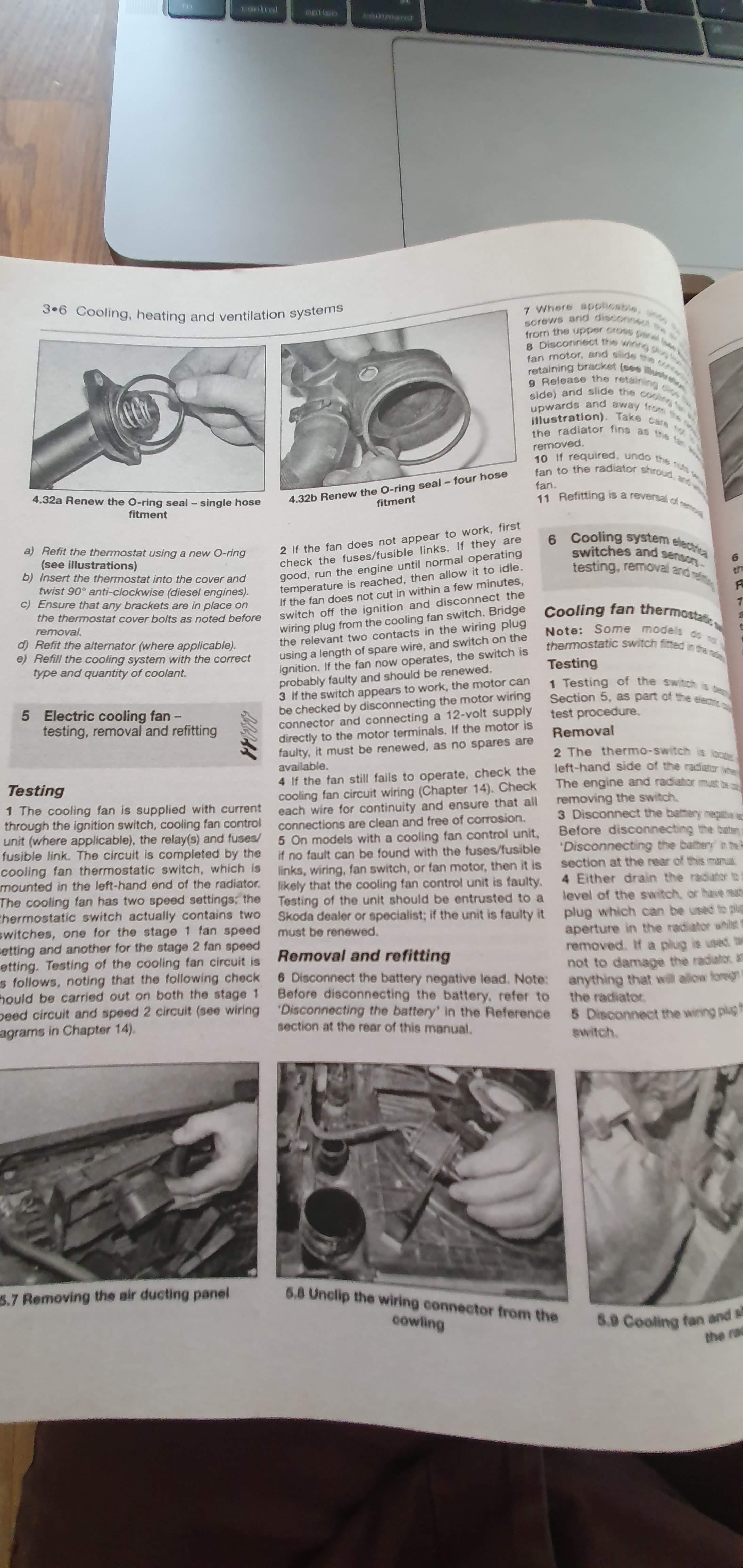

Guys I have checked the fan wiring, I looked at the fans fuse, I have even managed to jump the fans as the Haynes manual suggests and the fans work. I left the car in the garage at around 20 degrees celcius outside temp, with the ac set to max Lo and never once the fans kicked in. The temperature in the car was very very cold. I didn't hear anything abnormal with the cabin fans.

What was the method suggested by Haynes for 'jumping' the fans?

I was gona take some pictures and show you, it kept raining every time I finished wor. I'm sorry to have confused you. I only have 1 fan, I blame autocorrect haha. See the Haynes manual picture

OK, so in the middle of that page of the Haynes there are some instructions for testing. did you do 2, 3, or both sections (2 by linking out thermoswitch loom connector, 3 direct wiring to fan)?
I have only jumped the fan with 2 wires from a spare battery I had. I haven't jumped the switch after coming up to operating temperature whilts at idle, I'm still to work it out how to do it. Basically I need to test the switch, then move to the next thing.

If you can link out the thermoswitch loom connector that would test the power feeds, the relays in the fan control unit and the power wires to the fan, so ideal really.
Don't bother running the engine up to try to trigger the switch, just go straight to unplugging the loom connector from it and linking contacts.
There are three wires going to the thermoswitch, a brown, a brown/blue, and a brown/green. To get the low speed to operate, you link the brown to brown/blue; this energises the low speed relay, and should bring the fan on at moderate speed.
For high/full speed you link brown to brown/green energising the other relay, but I think the ignition needs to be on for this one to work.

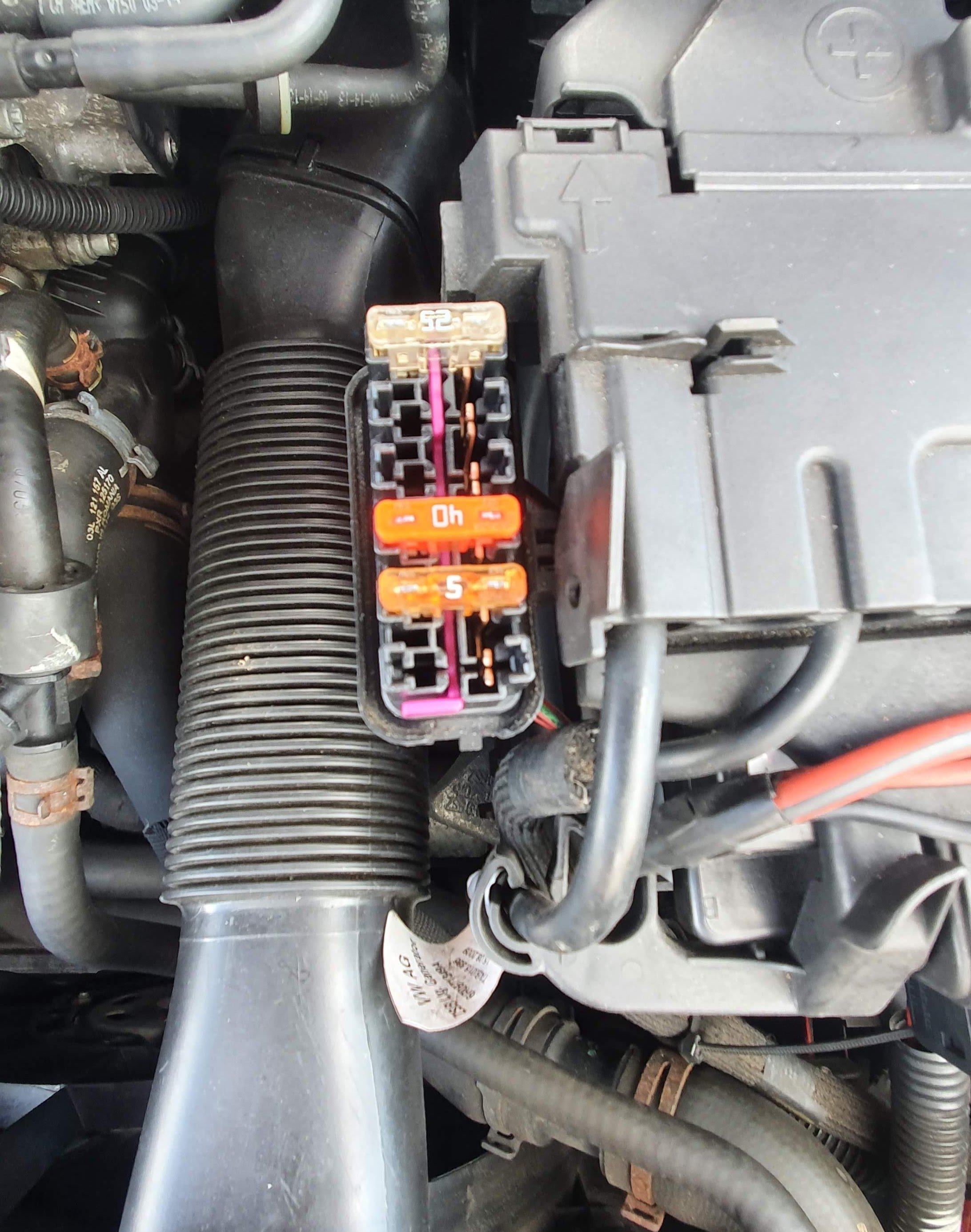

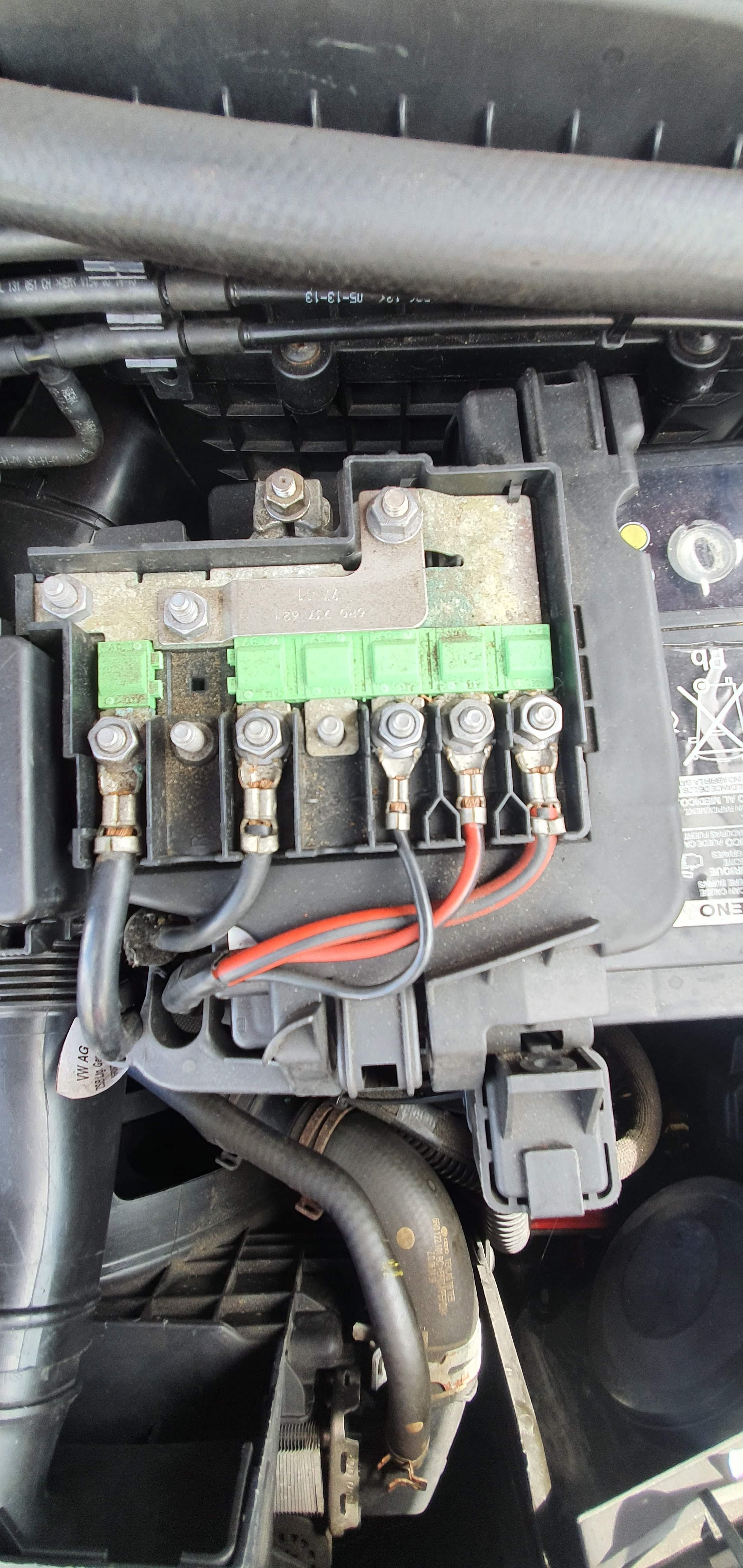

I will have to read your comment whilst under the bonnet. Thanks for that info. This is the fuse I looked at, No6 (second from the right backwards) is the coolant fan? Is that right?

Yep, that's the main permanent 12V to the fan control unit, but there's an ignition 12V feed too. The diagrams and fuse maps are confusing me to the point of suggesting you check all the blade fuses under that cover to the left of the strip fuses there, and also fuses 8 and 9 in the cabin fuseholder. That should cover all the possibilities I think.
Access to the thermoswitch is probably better from under the car, unfortunately. It's in the same vertical line as the top and bottom radiator hose connections to the rad, but rather nearer the bottom one.

Do you mean these ones too? I have to admit I have not checked the the easiest ones under the steering wheel. The rain has stopped, I will take the skoda in my garage this evening (the convertible will be out for a bit) and I'll go through your steps. Thanks again

Yep. :)
