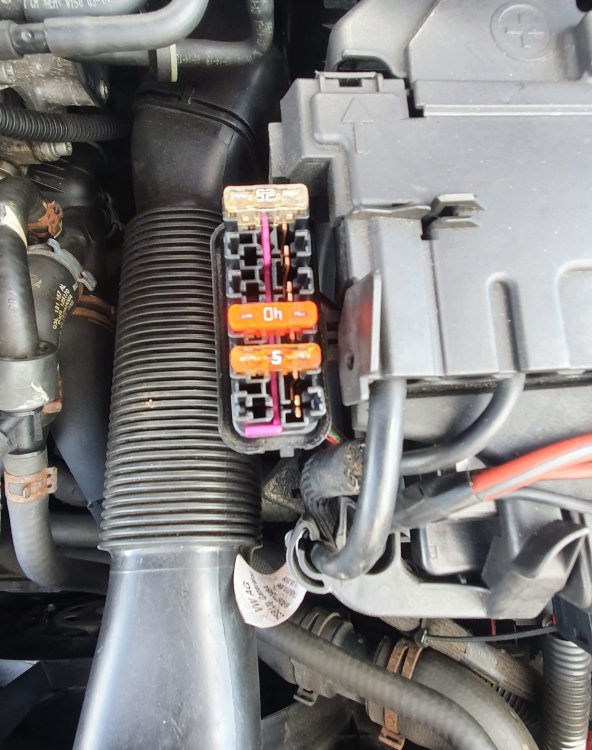

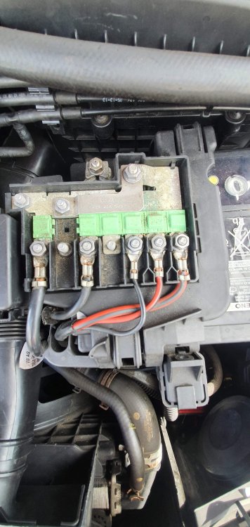

That's why your aircon failed on the hottest day of the year, check the fans spin freely and haven't seized, then check the fuses.
Your condenser was already very hot before you even started the car, as soon as you switched on the aircon the temperature would have shot up and with no fans running the ECU would have shut it down right away.
right so, I need to check the fuses for the fans, and look for any abnormalities in the wires/fans
