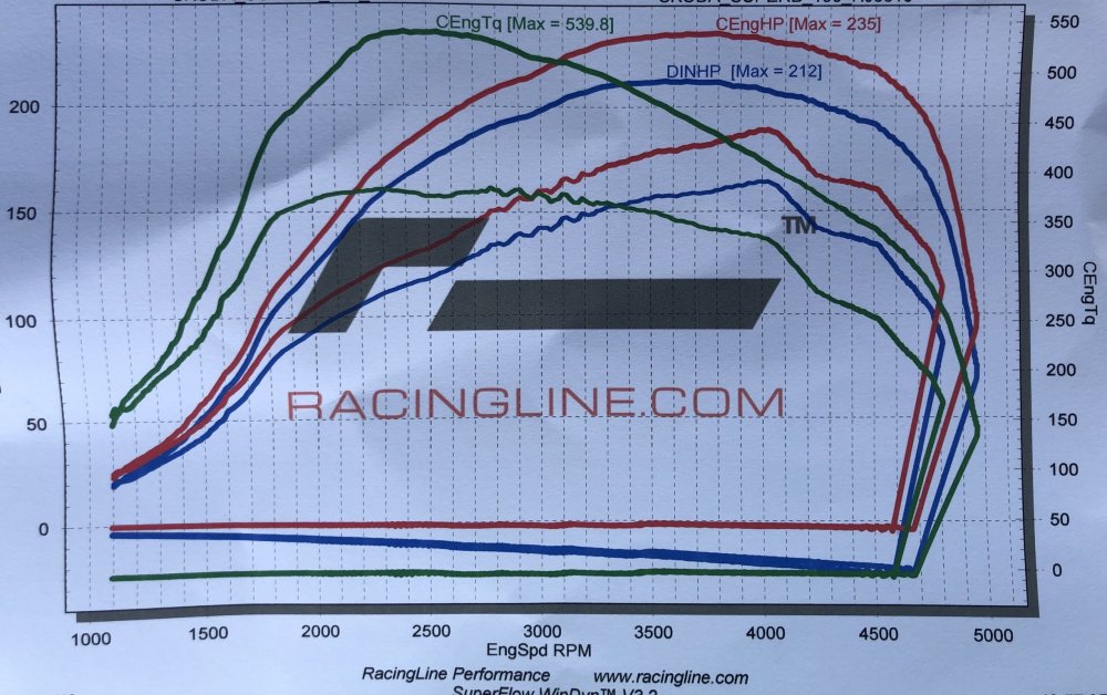

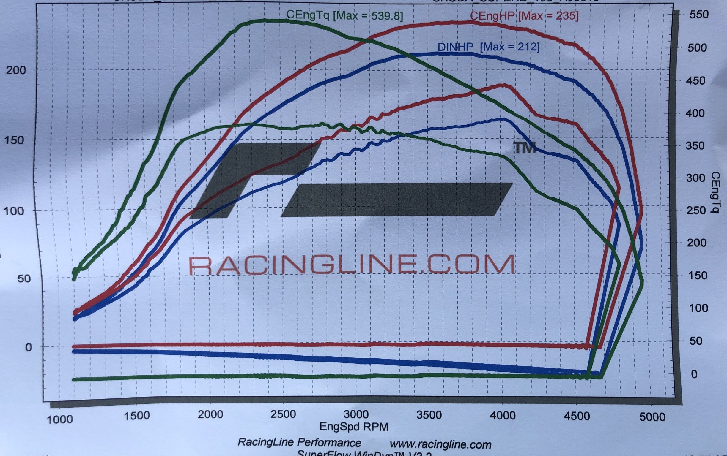

Mine 190 diesel, dsg 4x4 sportline.
Racingline map 235 bhp and 540nm. Consumption slightly better on a run but Obviously as expected will use more if really pushed.
Standard curve and mapped. You can see the torque limiters on the gearbox limiting at bang on 400nm
