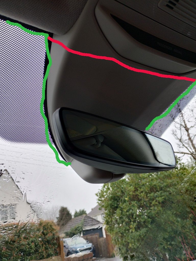

Hi,
I have read various article and checked some videos on hard wiring a Dash Cam but before starting can simeone confirm if the wiring can be easily looped from the LH side of the mirror towards the RH pillar towrds the fuse box behind the coin box on  the RHS on a UK RHD Kamiq?
I assume the cable will have to "loop" around the edge of the large centre plastic mounting that contains my road sign camera!
Thanks
Assuming I have correctly understood the question, - yes, my Nextbase cable is long enough to follow the route that you have described.
Just for clarity,  the green line is where the cable should be tucked in,  it cannot/should not be pulled or inserted on the route shown in red!?
Thanks
Could anyone confirm my assumptions as I intend to fit it in the next couple of weeks!?
Thanks
Its actually better to just take the wire up, behind the left hand A Pillar Trim.  Everybody assumes you have to go up the right hand A Pillar Trim.  It is simple to route a cable underneath the dash board and if you go up the left hand side then the middle piece won't be an obstacle. The end result being neater.
Yes you are correct that you can't get a cable across that centre piece, at least I couldn't on my Yeti. That's why I just went up the left hand A Pillar.

Thanks aubrey,  that's what I was thinking of doing and I will try it.
Did exactly that earlier this morning, front camera wasn't too hard at all. Camera behind mirror on left side, was going to do the right as I had in my Audi A3 but with the Kamiq it obscured a little too much vision, so opted on the left. Wiring tucked nicely along the top, down the left pillar, around door edge, straight under dash all hidden to the fuse box piggy backed in number 43 as you guys mentioned (wiper). Used a couple of cable ties for the slack then and tucked tightly near the fuse box, hate hearing any rattles such as possibly the wires being loose tapping.
The rear camera proved most difficult, managed to just about squeeze cable again along top left of windscreen, down the same left pillar, down door edge, and then cutting across the lower floor trim straight to rear seat. Was stuck at the rear seat for sometime trying to figure out the best neatest way of doing it, and if going up n down too much it would have been short for the camera itself. Wire shows a few cm near rear seat, rear window edge, along the inside of the trim going into the boot, and then just about had enough to tuck under the rear window trim.
