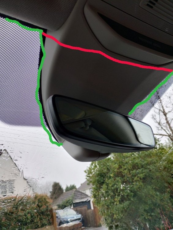

could you please confirm the following regarding the front camera fitting:
did you need to remove any of the sound proofing under the dash/stowage box to route the cable?
did you route it between the roof lining across the joint at the top of the A pillar (by releasing the the top of the A pillar cover) then around the door seal and back at the joint towards the stowage box?

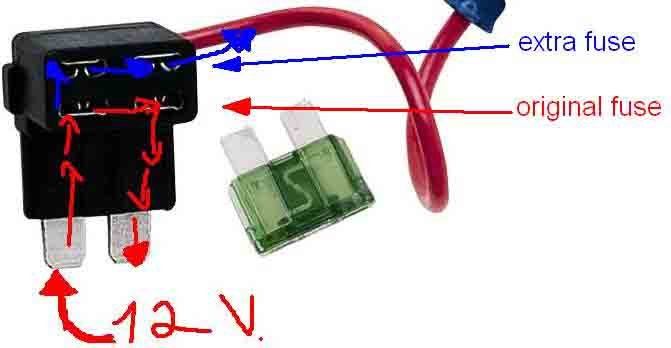

  • Good Morning, I had the same problem when I fitted my dash cam.  I eventually piggy backed to no 45 (Windscreen Wipers). No problems since.   Good luck, Liam
  • Thanks, i have connected it to no 43 as there was no fuse in 45 for some reason, and it works!

Lucky have a carport so was under cover nice n dry...... Don't worry about terminology I'm as bad.... So yes the sound proofing (the felty type stuff yeah?) underneath there are plenty of gaps to put the wiring in. This was the easiest part of the lot underneath and across to the right hand fuse box. So along the roof you can just prise it open just enough for the wiring to push through, where it can then be held enough. Going down the left pillar then, again prising the plastic trim just enough for the wire, then pushing the rest of the wire down near enough prises open the trim as you go down.  It's also covered by the rubber door seal.
Then before cutting across underneath the dash from left to right, theres a joint between the pillar trim and the floor trim, ended up tucking the cable between the joint, and under the dash, tucked under then all the way from left to right.
I'll do a quick video tomorrow and put it up on YouTube.

FWIW I piggy-backed on to fuse 43,  bought a cigarette socket and used the supplied lead as a voltage reducer.  Fed lead with a thick wire across to LH side and up and across windscreen as advised.  All invisible except about 20mm across to the lower door seal but does not show as both cable and plastic are black!

Have yet to fit my dash cam, got a hard wire kit off Ebay which includes 3 different size piggy back fuses, going by previous experiences with garages and MOT stations they have an aversion to dash cams and insist on immobilising them when working on the vehicle, thats where the magnetic mount of the Nextbase is an advantage.
