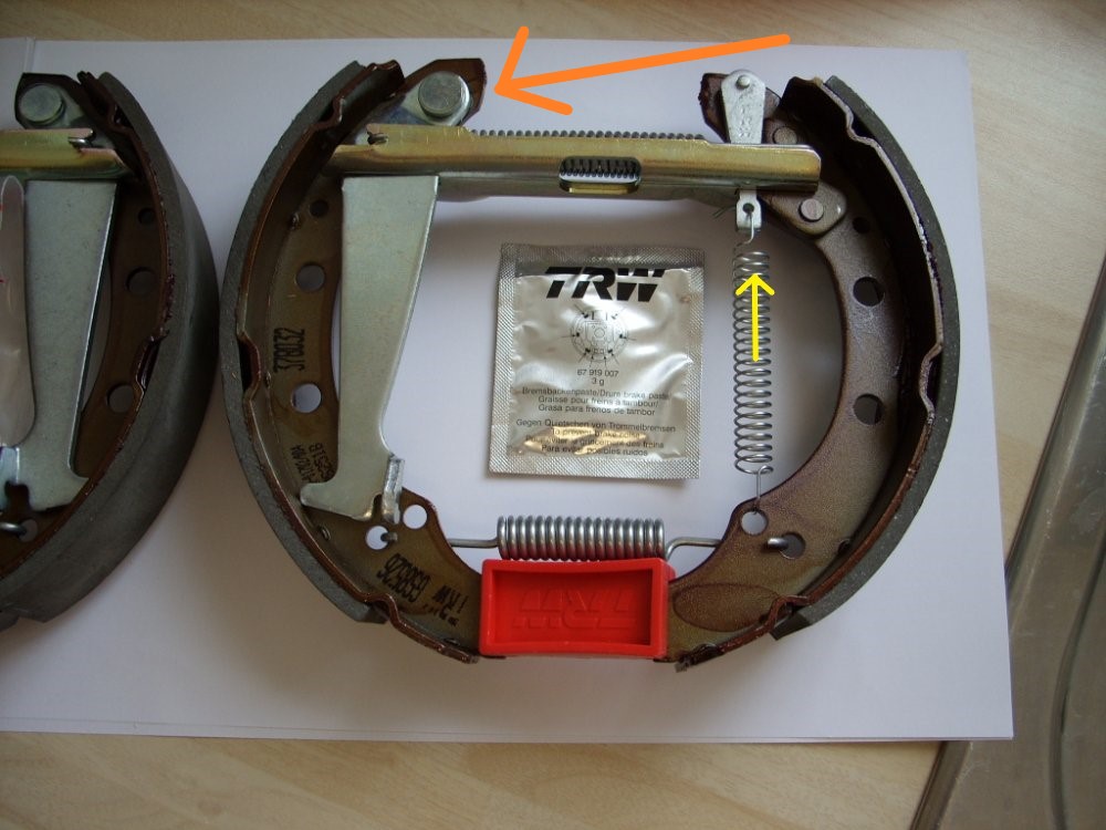

If the brakes are binding it's usually either the wheel cylinder piston(s) is/are seized or the rivet joint(s) in the handbrake lever(s) is/are seized. Orange arrow in this pic...
In some cases the handbrake cables can also become stiff and not return properly.

OP- TMB has posted a decent photo of the assembly.https://www.briskoda.net/forums/topic/484528-2004-tdi-mk1-brake-fluid-quantity/ I've been working on my rear brakes recently and after many years of car DIY, I'd suggest you at least change the shoe hold down springs ( the circular items almost half way down the shoe). From experience it's almost impossible to get these at a reasonable price ( unless someone knows different ,and I'd be happy to hear that), so the next best option is a rear shoe fitting kit which includes all the springs and the holding fixings.
NB- do not forget before or very soon after removing shoes to secure the pistons( or better still if you don't), be prepared to open the bleed nipple to allow the shoes to contract ( and get the drum back on). (I do it with two levers after opening the nipple. It's easier that way and simpler to bleed with something like a Gunsen. most of the fast fit places simply remove the shoes and wait for the new ones to arrive. Result more air than fluid in system.

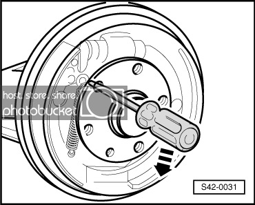

Backing the auto adjuster off is done by using a thin screwdriver through a wheel bolt hole. It's also far easier to renew the shoes if you take off the wheel hub/bearing.

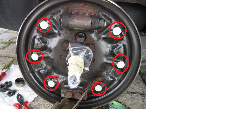

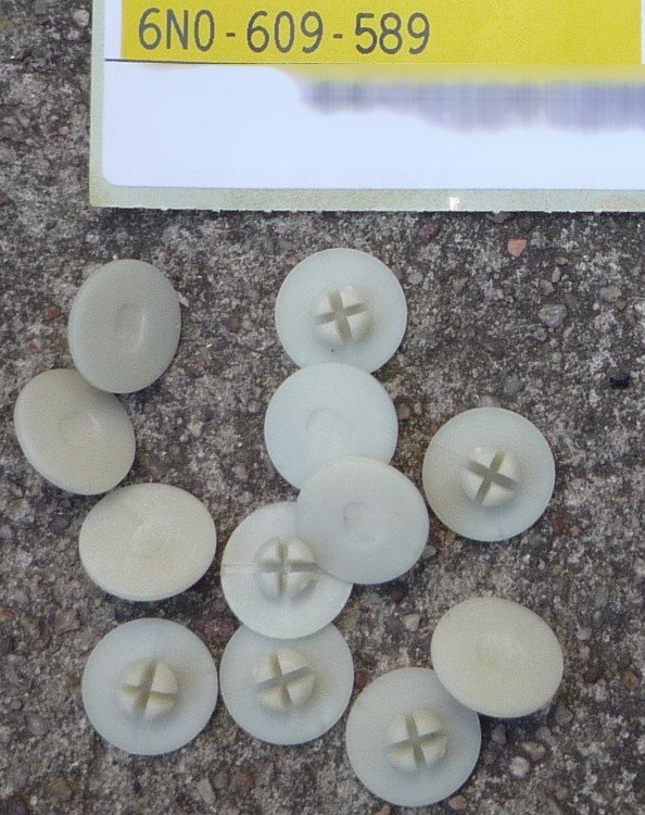

Remember to check the nylon glide pads on the backplate too. Mine had thrown the towel in.
They should be lubricated with a smear of appropriate brake grease.
