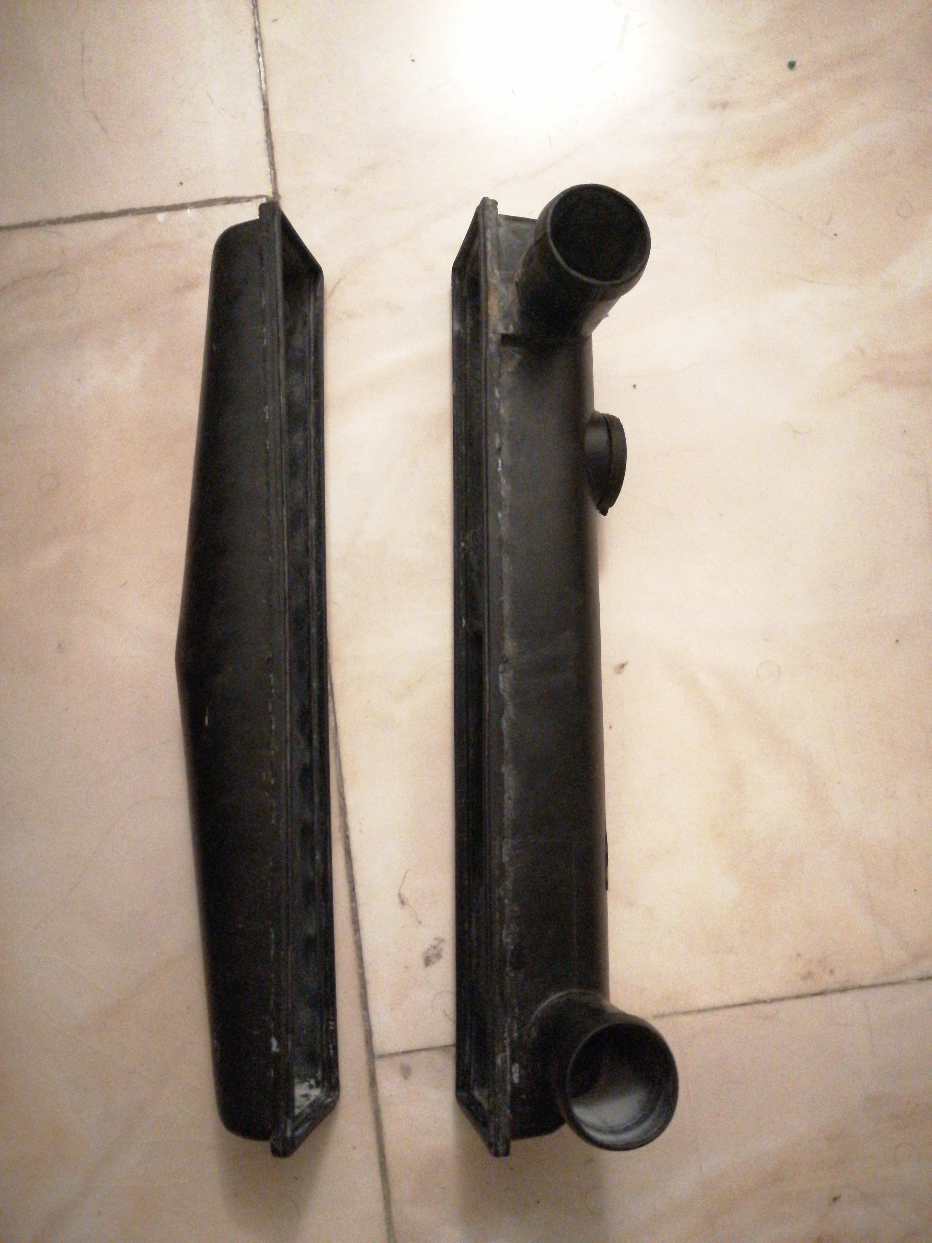

Forgot to mention my fan bearings are worn out so i might fit 2 modern fans instead of this old noisy hog and i had to replace these 2 things from the old radiator these in the pic are the 1.6s umm come to think of it the one on the right should have been installed so the fan switch could have some room to fit probably and plug the upper hole with something
You created "radiator for warm climates" mentioned earlier :) Combining inlet/outlet from 1.3 and 1.6 won't work, because 1.3 is divided to 2 chambers in ~1:2 ratio, while 1.6 is divided in half, coolant flows differently in it.

My biggest issue was was the expansion tank and where the outlet of it will go
Inside the footer was the same plastic divider of the radiator so i figured it will work like the old one but with wider pipes
