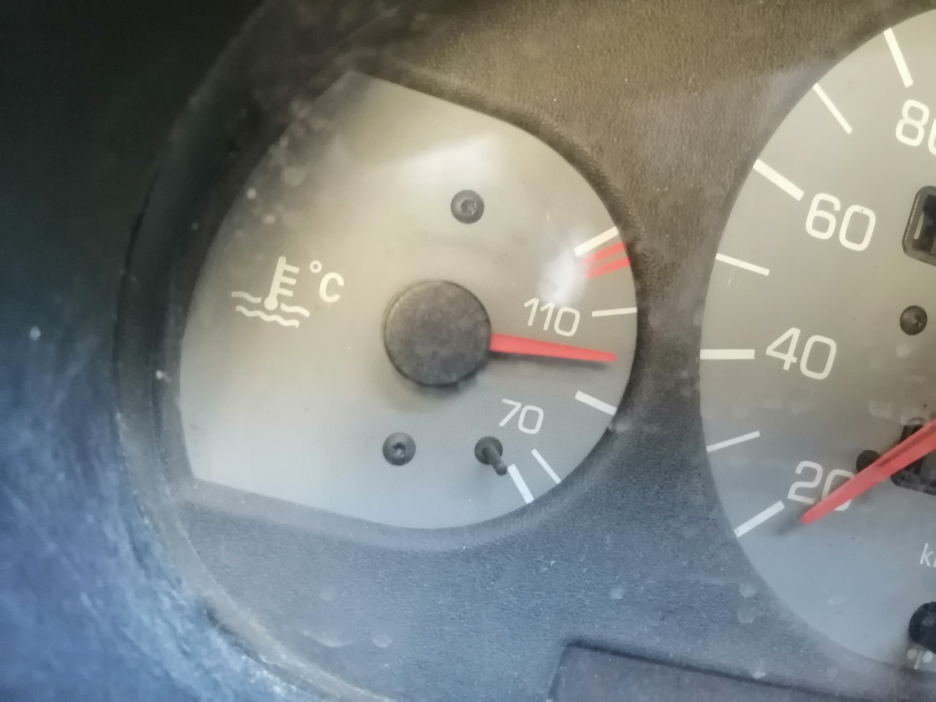

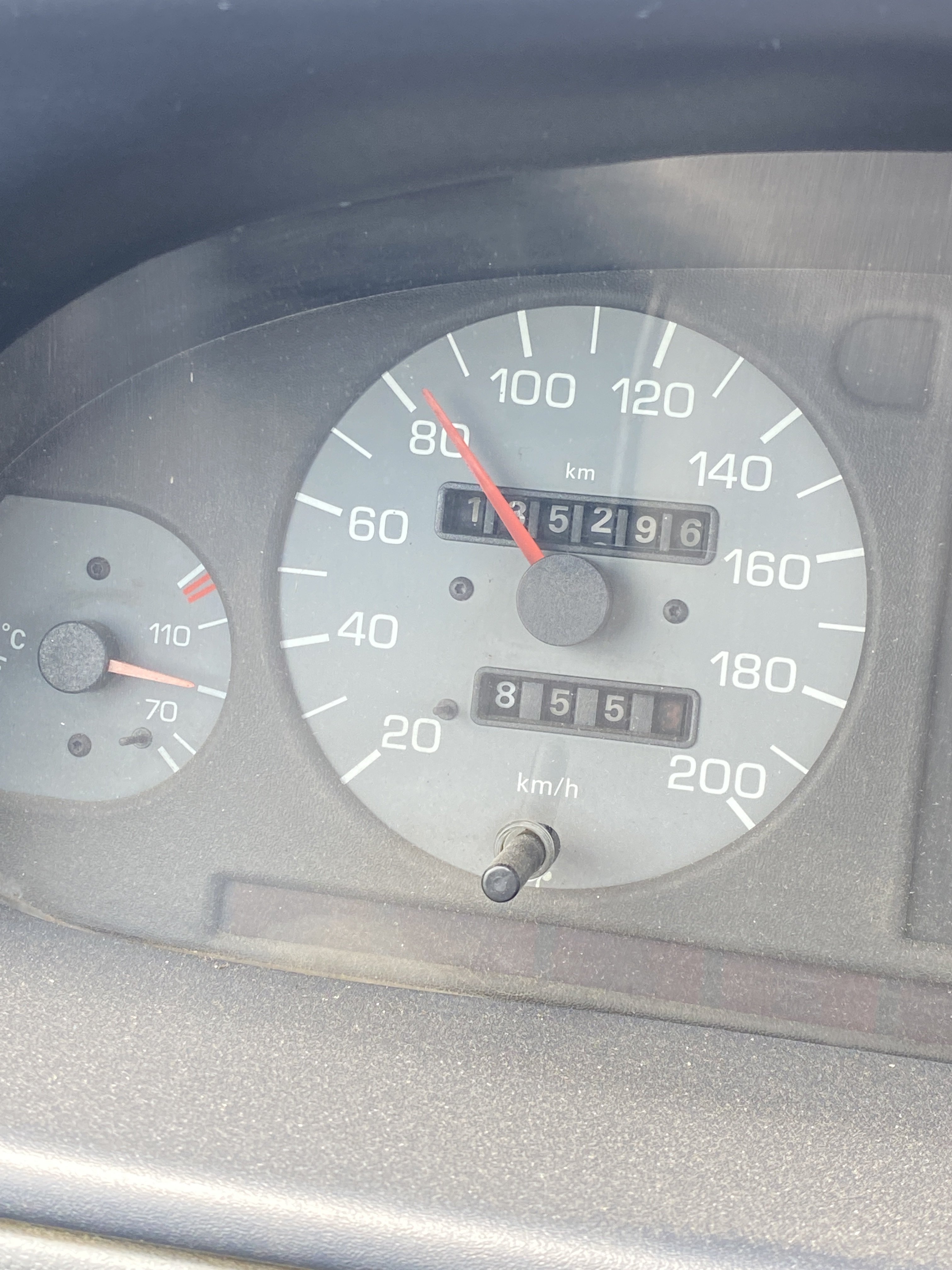

An update for you guys
So i installed the thermostat and before i install it i did a cooling system flush and the results are with no ac temps are between 70 and 90 pretty stable its the same city or highway without ac
With ac in the city its like this
But no boiling or anything and the fan is working great
The ac condenser is very hot at left side right side is warm to the touch
However ac at highway sometimes gets to 90 but no higher
Is the radiator fan running all the time in that situation?
mine would run approx there (maybe a tad colder) in the city with ac.
is the expansion tank loosing coolant.
if not i say you are ok
