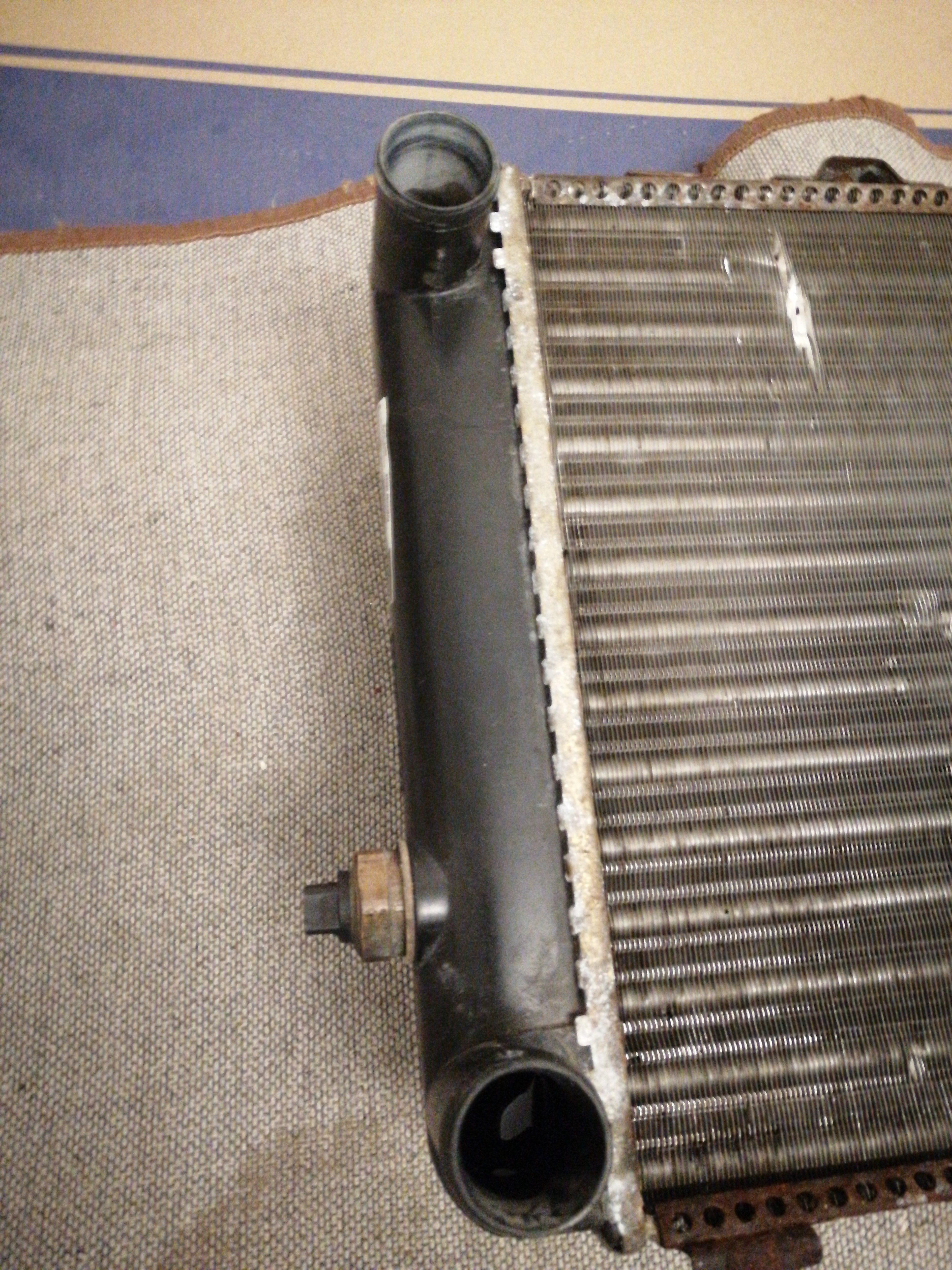

17 hours ago, Mohamedelbana said:
You mean this plastic shroud?
I was thinking to replace it with the old one to fit the hoses in the right places
this is a 1.6 rad.
you would need to make an adapter for the expansion tank line to make it fit as well as relocate a wiring and tubing

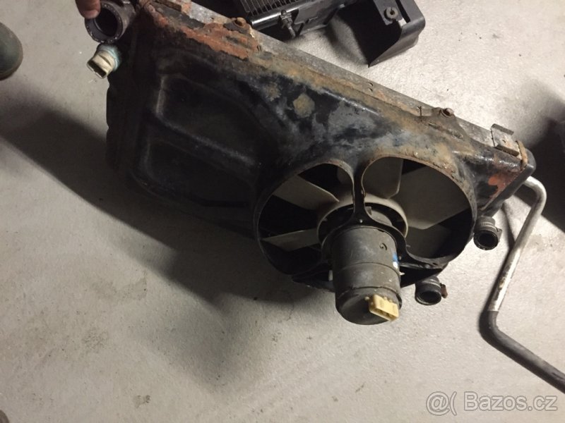

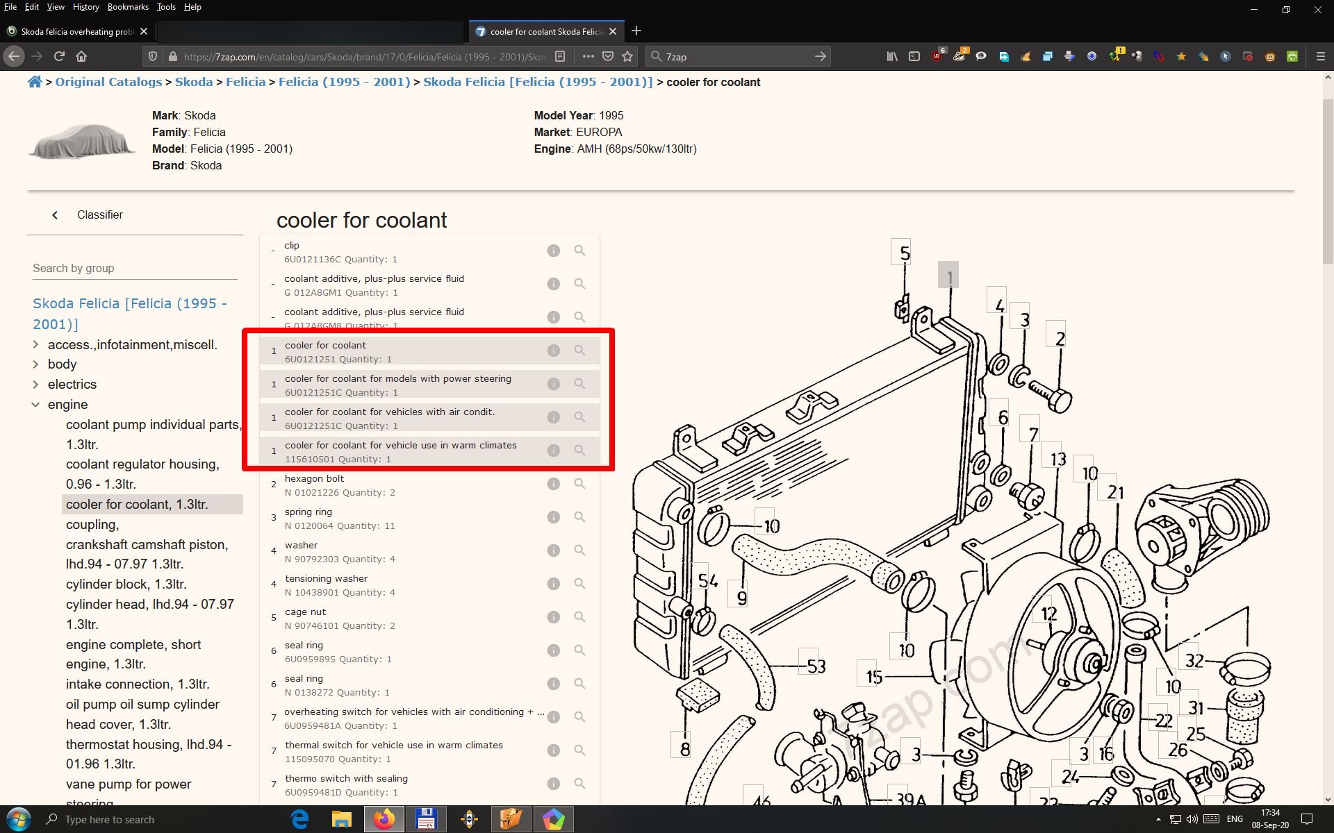

34 minutes ago, RicardoM said:
My car has AC from factory. It has bigger radiator, same fan as non AC cars. It is standard for countries with tropical climate.
Do you have some pictures? If there is some tropical AC radiator, it's not 6U0121251C, which has same dimensions as non-ac. This is how it looks like with fan installed. In 1.6, about 10cm of radiator are not covered.
Photo is from ad selling parts from Felicia 1.3 with factory AC
Edited by Papez
