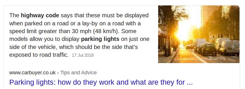

I tend to laugh, in a rather annoyed way, at people driving on parking lights.
@DaveMiller   Nice to hear you are looking carefully for what is behind you.
You will know then that Side Lights / Position lights are not 'Parking Lights'.
Parking lights to be used for when a car is stationary / parked are put on by putting the indicator down and a front and rear sidelight will come on and on some vehicles both registration lights and on some cars / Skodas 1 registration plate bulb.
(The UK Highway code really needs updating, the bit about Parking Lights and the bit about Sidelights within built up areas and in the Speed Limits / Street Lit areas.)
