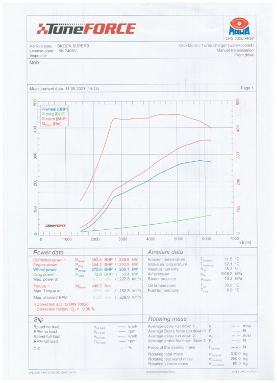

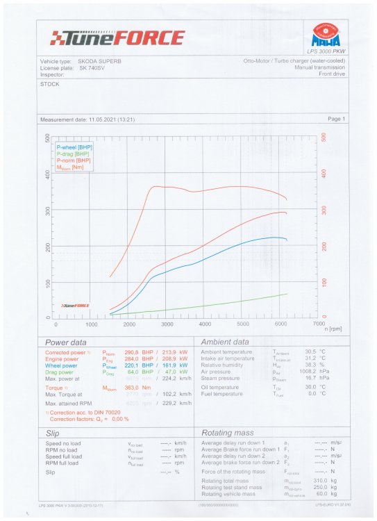

I got around to taking the car for the JB4 install. Pretty happy with the results, the car feels so much better now :D
Interestingly, the car was a little bit over 272 bhp stock
