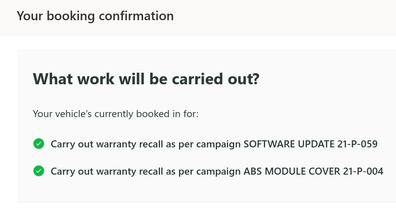

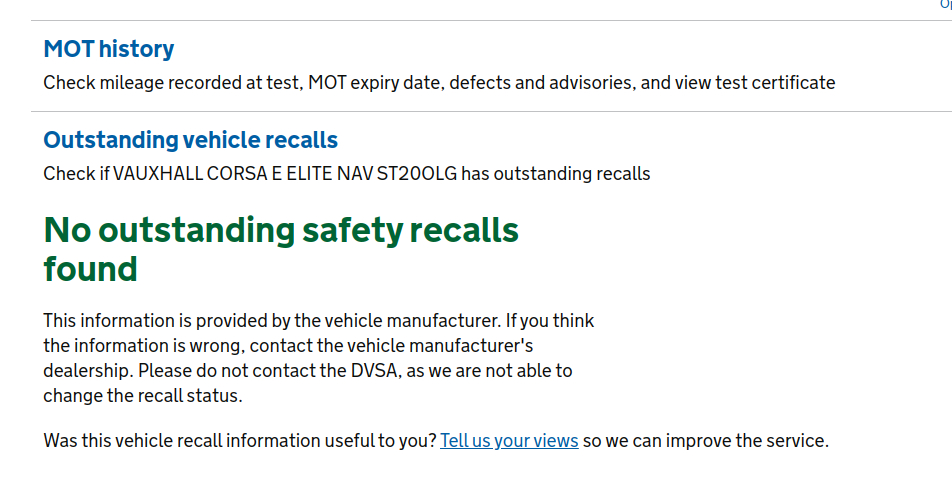

What really pees me off is when drivers / keepers find out about Service Campaigns / Recall Actions / Software Updates on their vehicle via Social Media or word of mouth but not from the Manufacturer or the Dealership network because they do not contact you yet cal these 'Service / Workshop Campaigns RECALL's.
Car is going in to get these but i await an explanation of why and what for.
Hopefully settings i have taken ages getting a i like will not need re-set, but i fully expect they will.

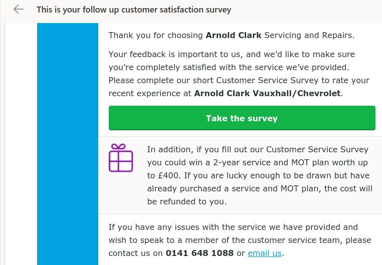

8am appointment and as expected with Arnold Clark the reception does not open until 8am.   Car went to workshop at 8 30.  So also as expected 'reception' knows nothing, and calls the 'Not called to tell you there is a service campaign a Recall'.  Obviously they say just a software update, well 2 actually, and nothing will change that I will notice.   We shall see.  Is it the touch screen that needs touched at least twice everytime you want something.   And more important is it the false warning of the need for emergency braking.  I hope it does not sort the KESSY which I am happy does not work most of the time as I like pressing a button on the fob to open / unlock the car and to lock it again
Edited by e-Roottoot
I can confirm that the visit to Arnold Clark for the software updates / recall action have resulted in no changes other than the car has been washed.  I declined the vacuuming.   I can be certain on that because there was no EV trained and qualified tech available to do the updates.    Par for the course with Arnold Clark.  I await the Customer Satisfaction survey.
Great example of experience taking a software driven computer-on-wheels to a traditional fossil engine dealer.
The receptionist or the person giving your coffee won't know jack all. They are only there to look sleek. As with all main dealers, they feel the need to jack up the price to employ those people so you don't get to speak to the technical people in the know. Then the technicians have their hands tied to follow service manuals, and in this case, software update instructions. Unless manufacturer publish changelist like software releases, no one in the dealership (or anywhere) will know what has changed. They prefer you treat your car as a blackbox and physically visit them everytime there's a fault, wasting your time and money.
I hate main dealers.....
'Yoos speart so yill git telt.'
& am expecting i will get a call from someone when they read what goes on Trust Pilot.  Muppets.
Only heard back from the AC Branch asking me to book in for the Recall.  So that will be when hell freezes over that it goes into them.
