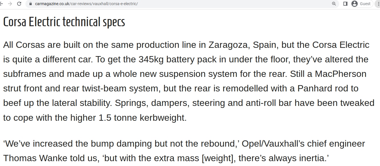

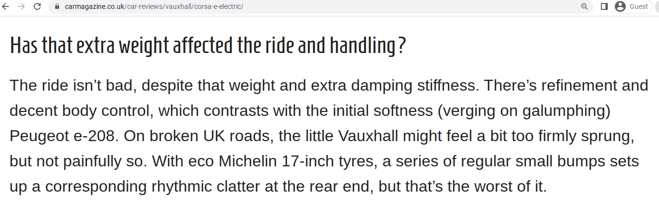

This is what the suspension was like when nearly new.   The springs are just like dead now.
Points to under testing of the electric version when it was launched which was always going to be an issue with the e-corsa being an adaption of the ICE corsa and just putting in say 20% stiffer coils is not enough.
When I was Dept Transport I recall reading one report which said that the damage to both car and road rose by the power of 4 ie not squared or cubed by the fourth power.

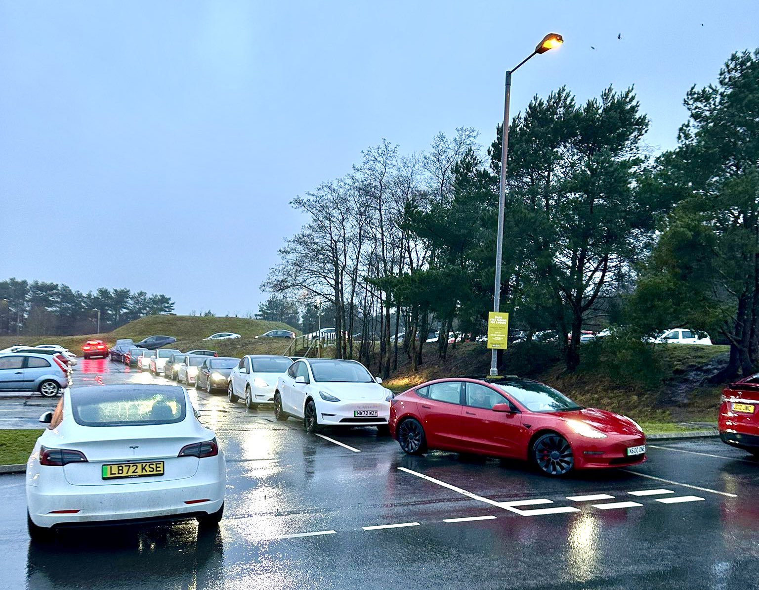

Will avoid trying to pop in for a charge at Tebay recharging at the wrong times, a 6 hour wait to charge sounds like hell on Earth.
Andy Harris on Twitter: "Tesla tailback at Tebay. Around 40 cars waiting to  charge yesterday. The future? Pic C/O Metro newspaper.  https://t.co/HRMQByFLb1" / Twitter
4 hours ago, toot said:
Anyway no more EV's for me as charging out and about gets stupid price wise in Scotland, i think i had the best of 'Much Cheapness; charging there will ever be in Scotland.
PHEV?
Yeah, my takeaway from that: avoid nice spots, do rapid charging at somewhere like an industrial estate.... at least until situation improves.

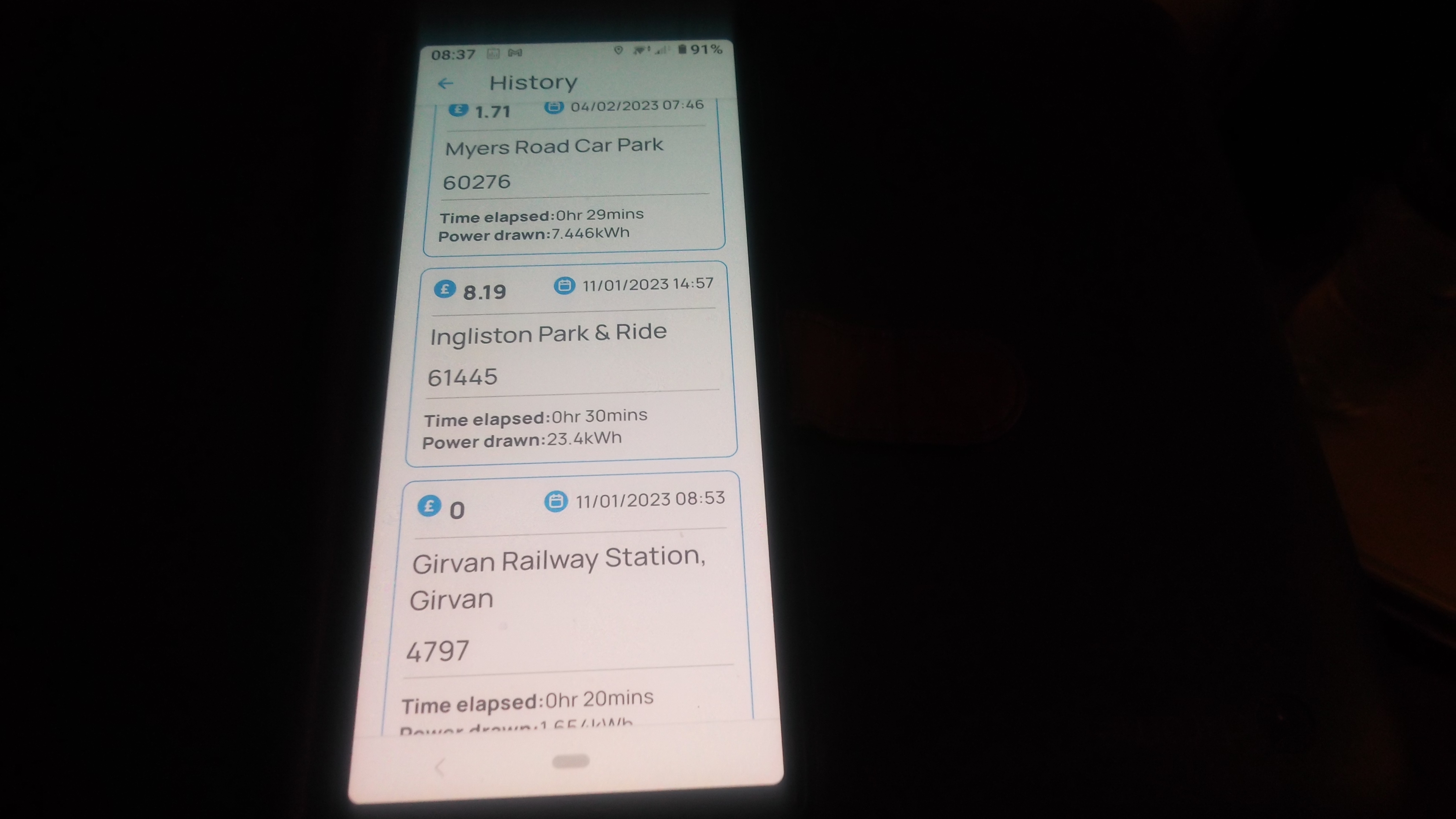

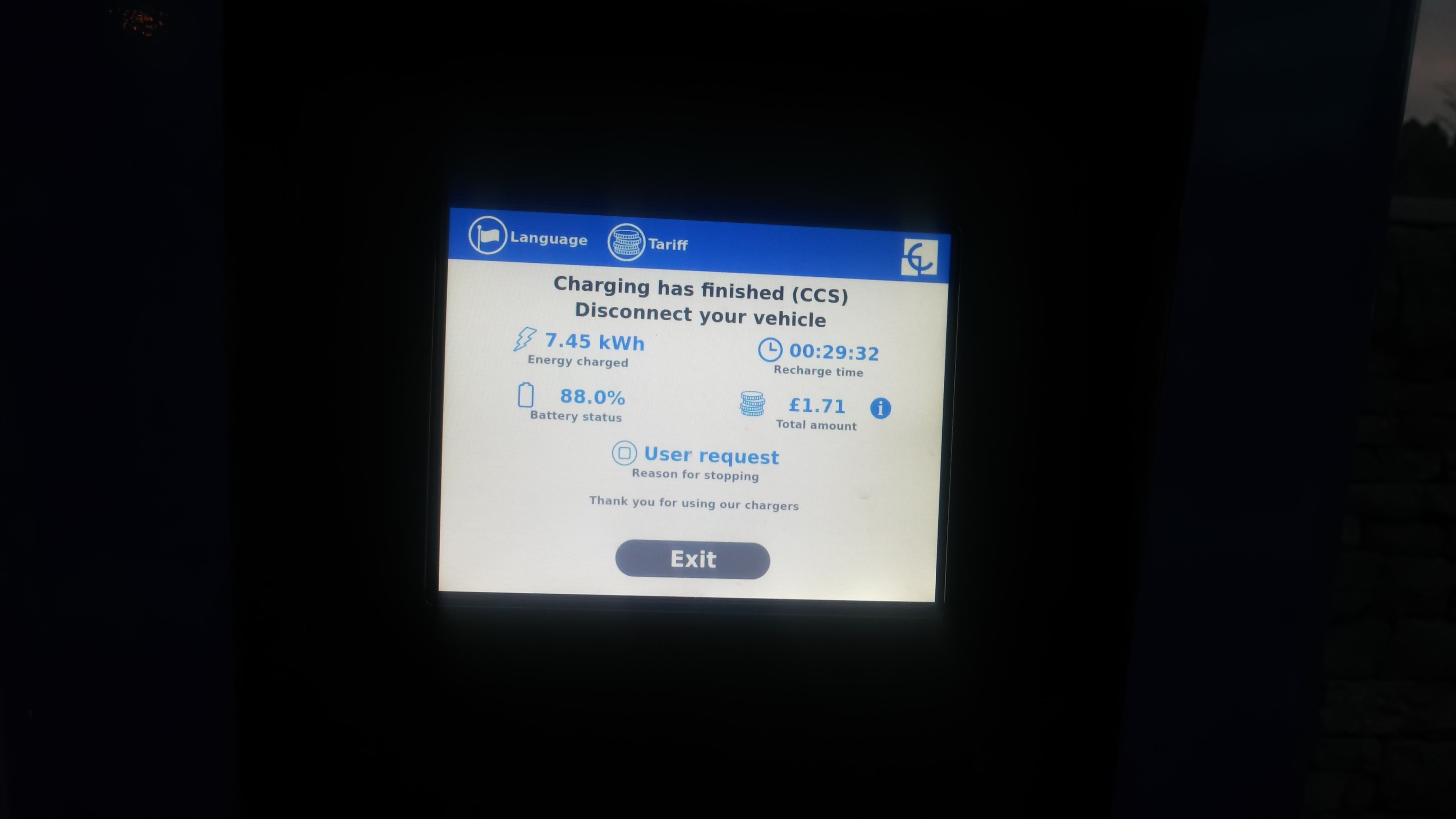

Well i stopped charging on the Rapid because after 5 months of it not being on the CPS app or taking money they have activated it.
It was good while it lasted.
So off to Tesco to get 6 kWh for no money while buying munchies then i will see how things are.
Edited by toot

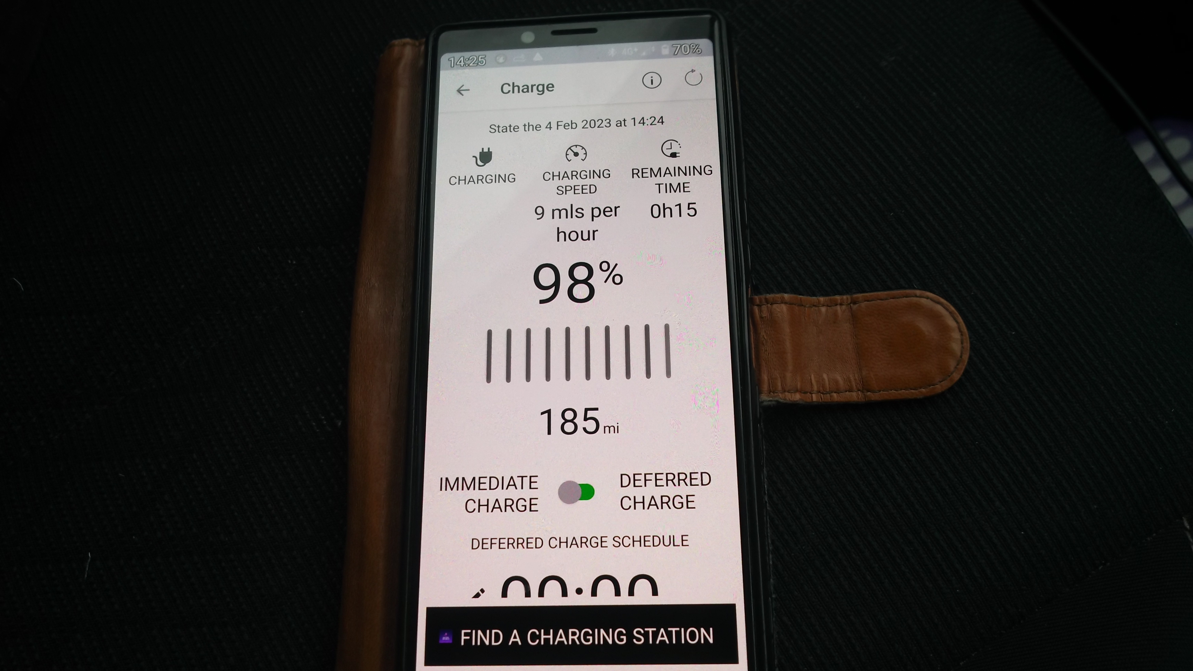

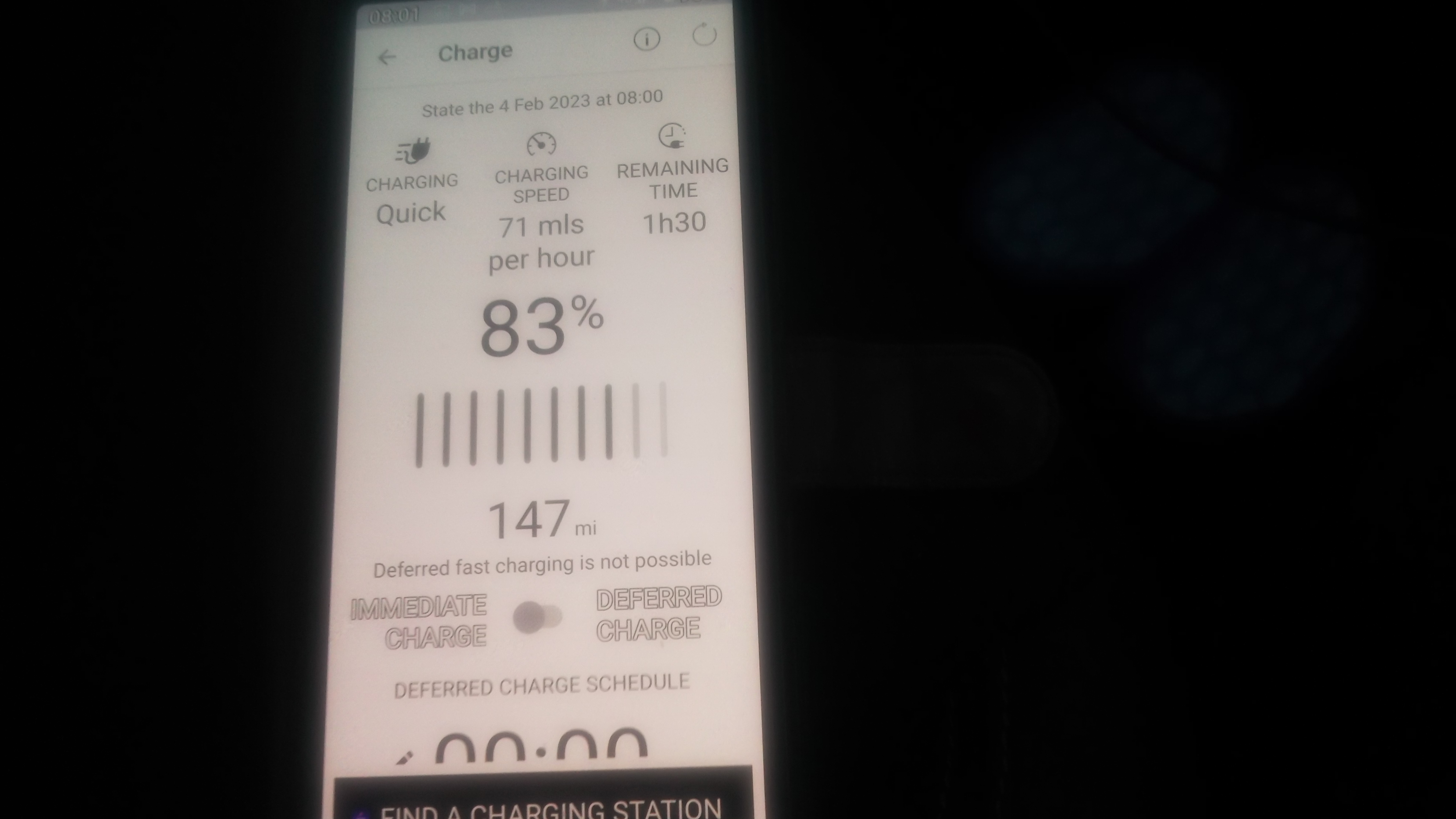

Back in September 2020 it would charge to 100%, not that slow from 90% and at not that slow 98% to 100%.
It would show the miles per kWh and then when charged show the range when charging worked out on the 4.5 miles per kWh, 3.1, 2.7 or whatever the car had been getting in a good while before going on the charger.   Like ICE vehicles.
Range dropped in 6 mile bits when driving.
If charging i could listen to the radio without ignition on or with ignition on, and sitting in the car parked not charging maybe 20 minutes before it shut off to battery saving mode.
Then September 2022 the Software update had it really not wanting to charge 98-100%, but leave it long enough and it would but it would show 180-190 miles range temperature dependent.
Range started dropping in 1 mile after it gets down to the 140 max range or what ever from the fictional 180 + miles.
I was able to listen to the radio when charging but no ignition on and only for 5 minutes if just sitting in the car, and no just switching it back on.
Now it does not want to charge above 98%. (Tomorrow i will try on my 3 pin charger and see if it will go to 99 or 100%.)
If the range was even near possible that would be amazing.  The radio will not stay on when charging if the ignition is not on.
It is turning off when driving then giving s bang, then lighting up and going blank, then i can switch it back on.

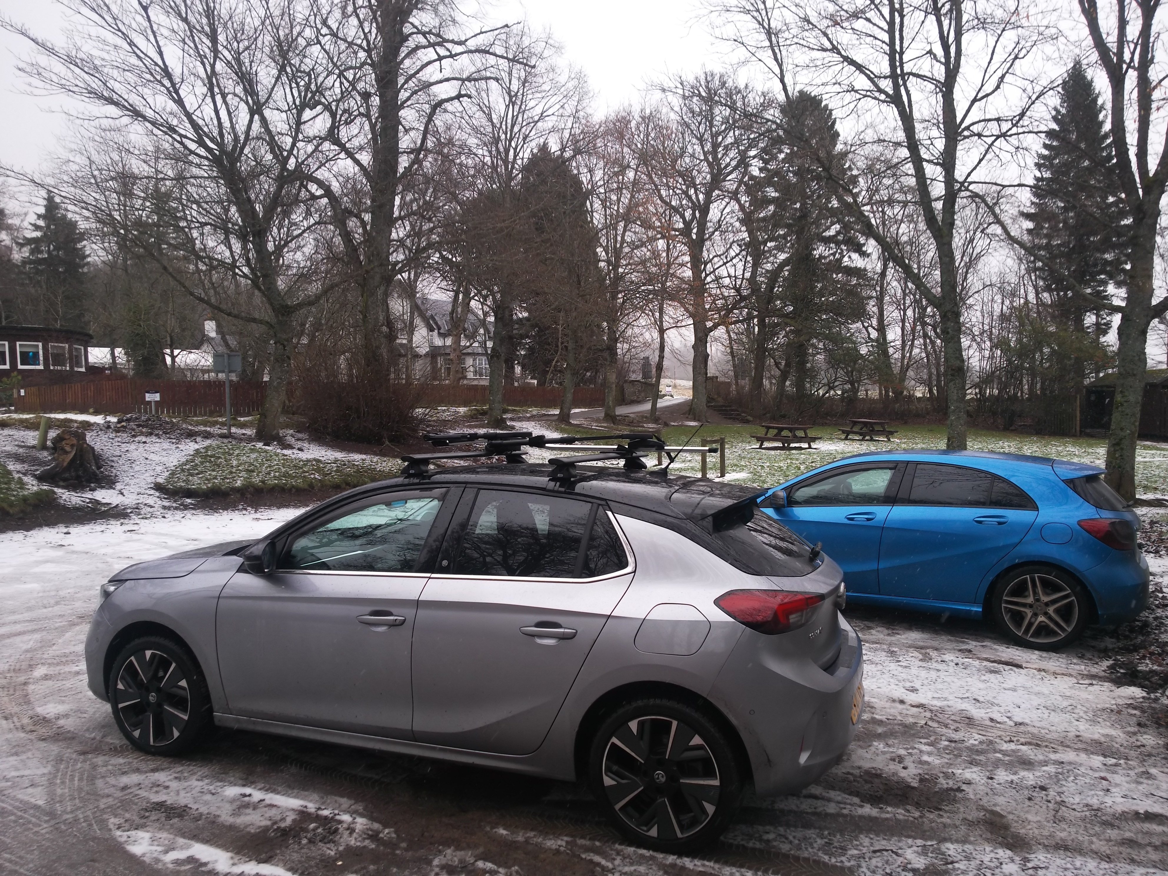

Had a wee run to the Angus Glens before charging but really it sounds like the motor is going to die, the bearings are dry and it is on shortened springs and no dampers.
Otherwise it goes well and corners like a Kart.
229 miles was back when new in 2020.
That was coming back from the same run in winter but after lots of regening, on Cross Climate + tyres.

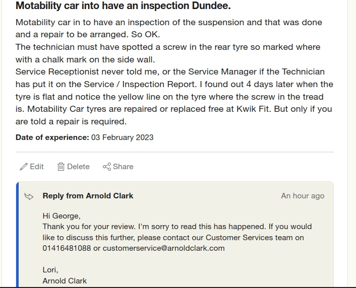

Barstewards.   Sitting at KwikFit, because they do Motability tyre repairs.   I did see a yellow chalk mark rear passenger side tyre.  Assumed it was techs mark to be sure tyres go back on same side as comes off.  Michelin Alpin 6.   On comes tyre pressure warning this morning and rear near side is 26psi.  Others 40 psi.    Screw in tyre 4" in.   So will see if it gets plugged.  Called Arnold Clark Service Centre to ask WTF.  The lady on the phone sees no issue with the Tech or the Service Manager not making me aware. Or leaving me to drive off with the screw in the tyre.   So once up the road it is on the phone to Motability Customer Services.  Then to Arnold Clark Head Quarters.  Then trust pilot and whoever takes my fancy.   First a health check at KwikFit if a ramp comes free, or if not to the ramp of an ex Vauxhall Technician of the years Garage.
Tyre plugged and just waiting till 1pm and the car away on a ramp for a MOT and DVLA examiner to have a wee look.    As to the tyre, Arnold Clark Customer Services have had that complaint in writing and by phone.  Now for Motability while I am waiting.   They might get a video shortly.

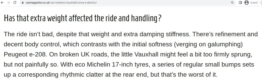

  The 205/45 R XL tyres are rock hard, and add to the rock hard ride even when the Suspension is new.   The cheaper models are on 16,s.    Waiting for Arnold Clark response.

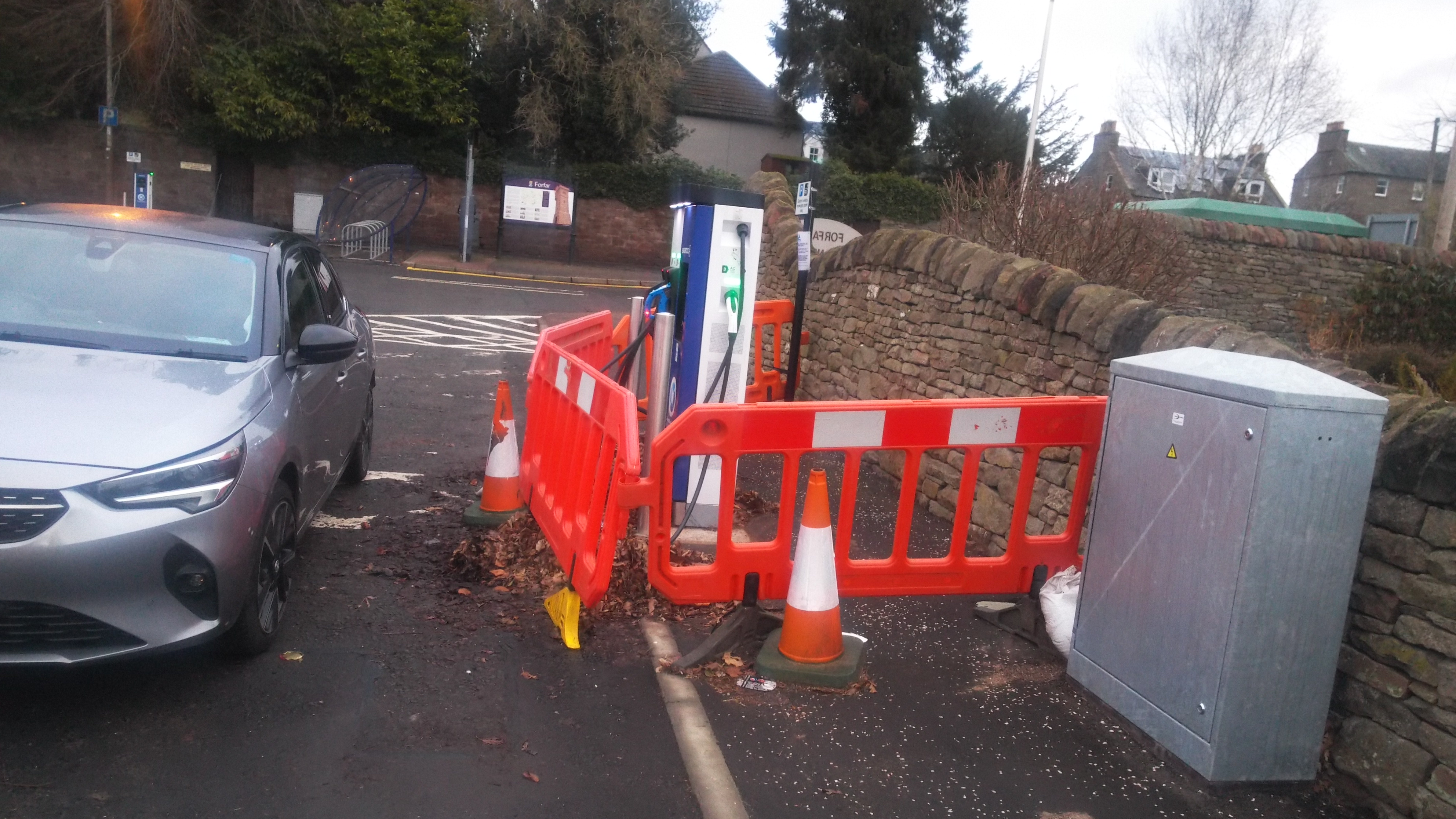

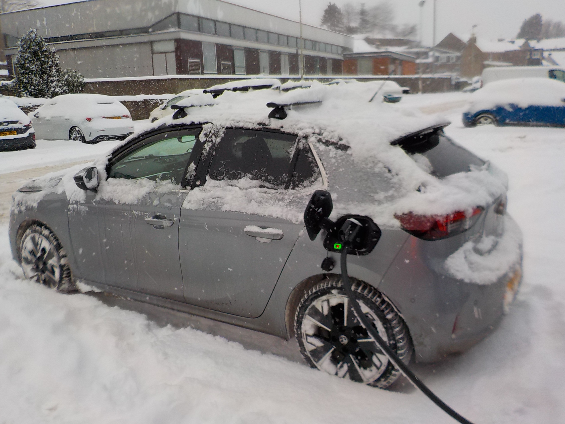

So right now in the torrential rain I am stuck at a rapid charger bay.  Unplugged after half an hour pressed start and up comes Gearbox error.  Tried a few times.  Same thing no drive.  Waited a minute.  Warning gone. Start and select drive and nothing.  Waiting a bit and about to call the RAC.   That will be a carry on, and on a flat bed.  And hopefully taken someplace to get a hire car.  Motability so that is ok, but I have hospital visits to do.   I might have to go get my diesel but that is 2 gallons for 54 miles instead of £3 electric.   We will see.    EDIT.  Comedy of errors.  So car stopped phone call as I was giving RAC details so had to go away from car to use phone.. 2,nd call handler says 3 hours for a responder, not a flat bed that will come later.   But they would get a taxi to take me home and get me my own car.  Fine.   Taxi office 200 yards away.. home 1 mile.    Txt comes in, a taxi on its way from Dundee 20 miles away to take me that 1 mile.  And not coming where I am but to the garage 100 yards across the car park because the RAC could not find on their map where the Charge Place Scotland Angus council chargers are in a car park. Only been here 4 years at least.
