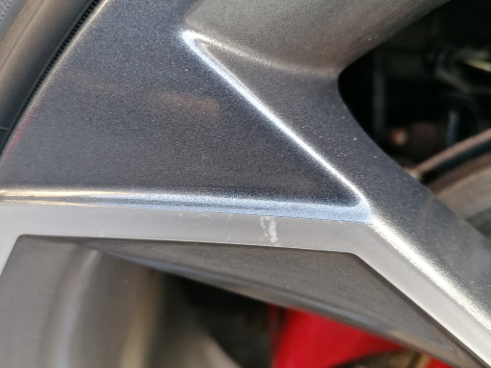

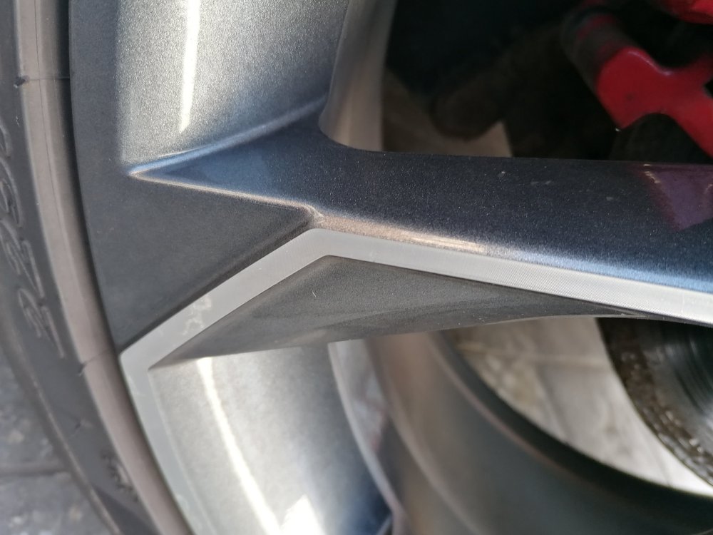

What are these white spots on my alloys? Is there anything I can do to prevent further markings? IMG_20200927_172339.thumb.jpg.c08c3bceab8c5c6c2244557c20acb9c4.jpg
A feature of diamond cut alloys!
Its water that has got under the lacquer, be that from a stone chip or peeling paint.  Over time it will just get worse.  You could try looking for any chip or peel and touch in with lacquer

I've got those spots on mine and they do my head in.
I took the wheels off, thoroughly cleaned them and then polished and waxed them. I haven't seen them getting any worse.
The curse of diamond cut alloys! Would a wet sand and re-lacquer work? That's what I'm planning on doing to spot treat mine if and when it happens
