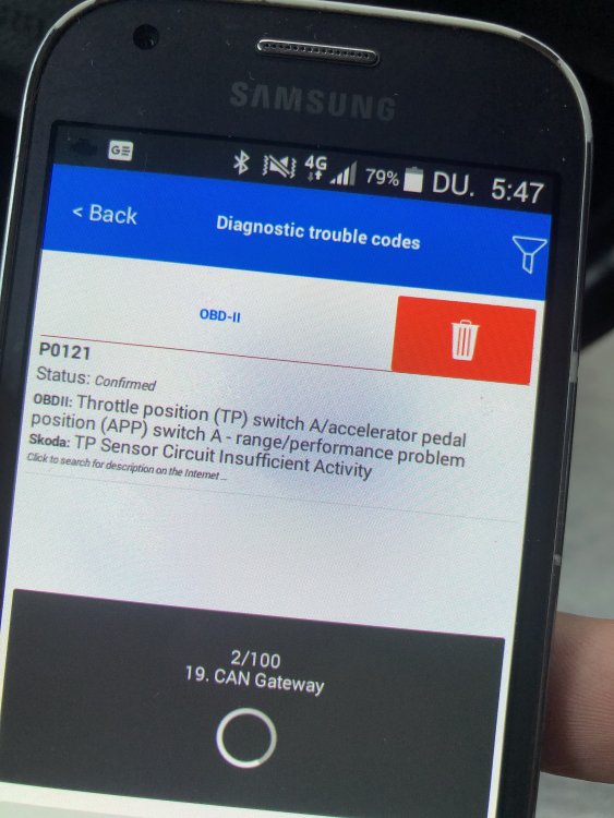

Hello,
did You had this issue? Coming this code more and more often so i need to fix it.
does anybody know what exactly need to be changed or does it need further analyse?
(2011 CR170 Dsg)

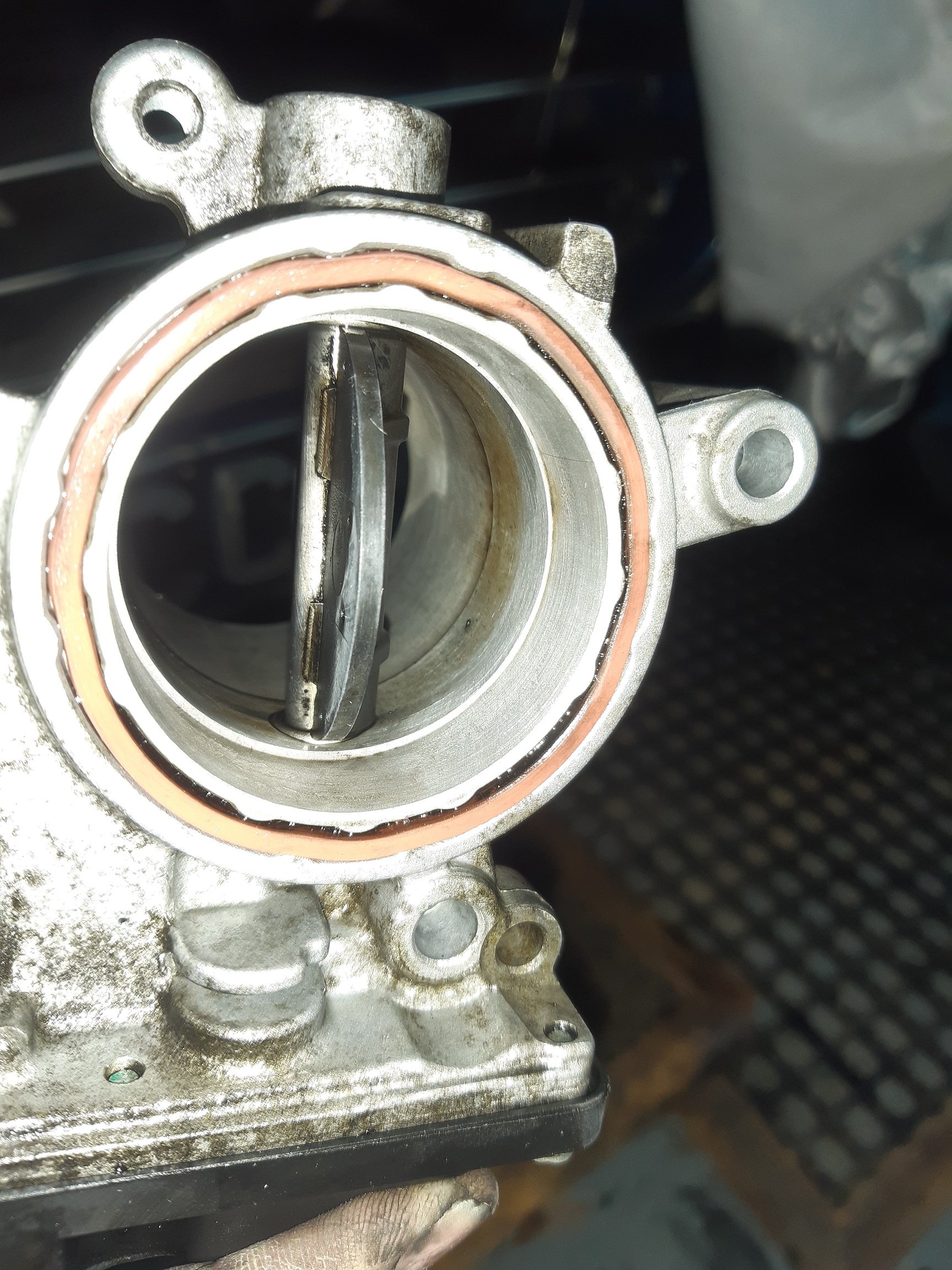

I recently cleaned my throttle body as it was throwing up the same error code and causing a lumpy tick over. I used a can of carburettor cleaner old tooth brush, Scotch Brite and a small plastic scraper. Took me around an hour to remove clean and refit the throttle body. The lumpy tick over didn't go away for a few days until the throttle body had re-calibrated itself. Had I used VCDS and re-coded the throttle body after refitting the throttle body it would have restored the factory settings and stopped the lumpy tick over straight away. But I didn't realise that at the time.
