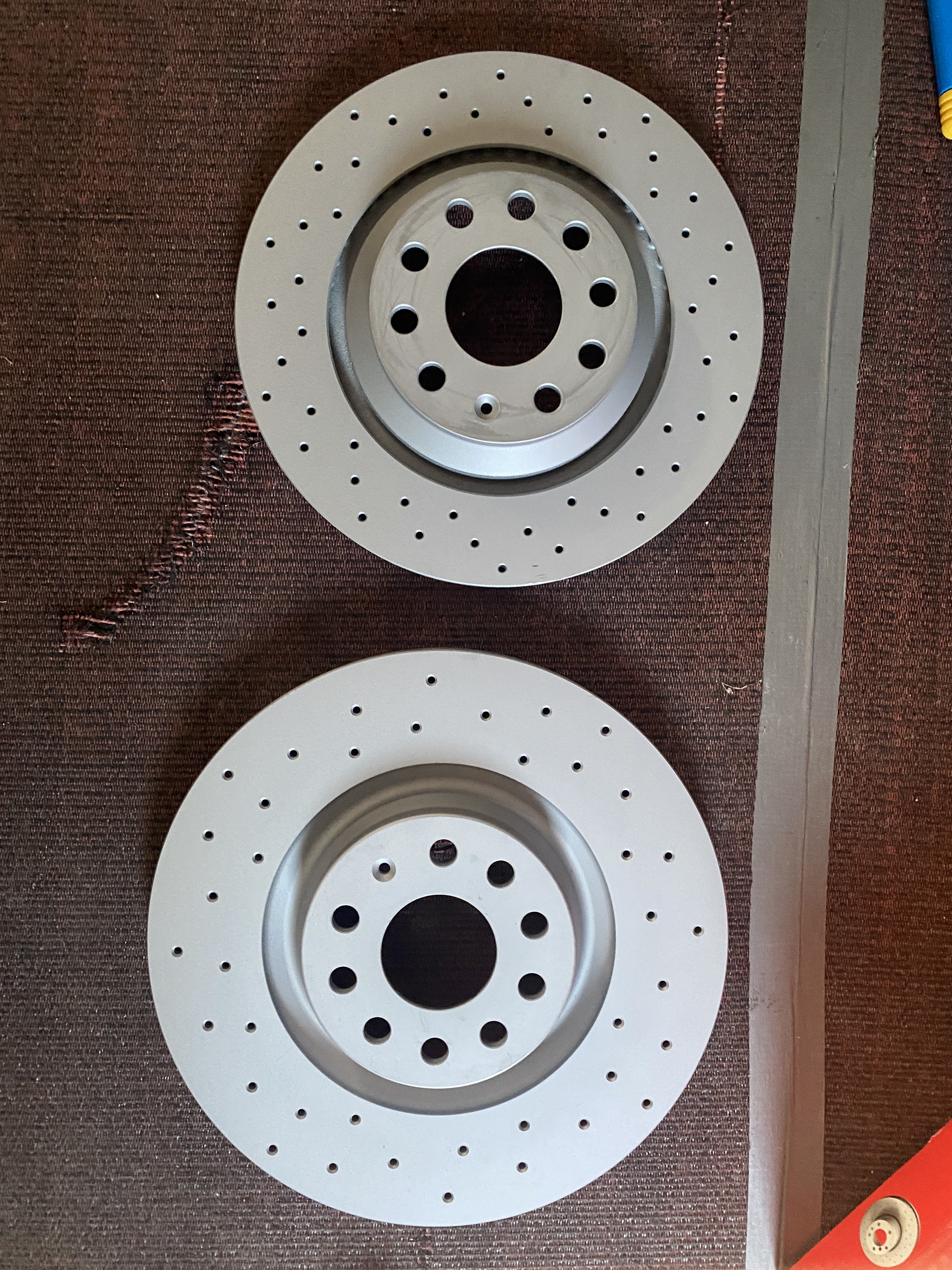

I got these the other week from AUTODOC. Arrived in 4 days
zimmerman sport.

So sorry for the resurrection! But wondered how you got on with those discs and which pads did you fit?
Great disc mate. I’ve just ordered some more from there and I’ve used the brembo xtra pads
New discs two years on? What mileage, or is it a different car?
Different car but I do 50k in 2 years
