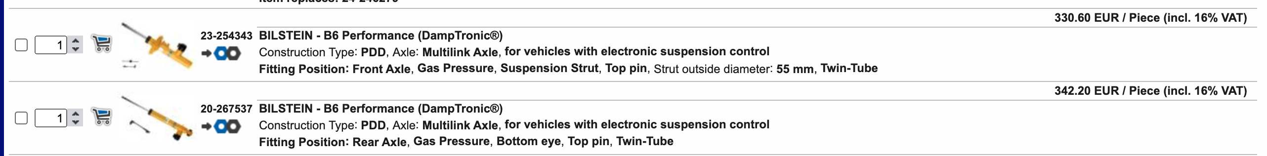

interesting, does same model of rear shocks fits for FWD
23-254343    front
20-267537    rear for 4x4
3 hours ago, newbie69 said:
Well hope never hurts but I'd say it's impossible for the KW DCC setup to ever become even remotely competitive price-wise to those B6 Damptronic. KW DDC is on sale for around 2200-2500EUR and they are not items that get discounted much (or even at all). It partly makes sense as they are a complete coilover set not just shocks, with the extra feature of height adjustability (for whoever needs that).
The B6 Damptronic could even be combined with stock springs but even with a pair of Eibachs (which i think would be the ideal setup), they turn out to cost half the price of the KW: 1200-1300EUR.
right now I could buy a kw dcc kit for € 2,300 (or maybe something less), or a B6 damp + eibach pro kit for around € 1,480. it means about 35% difference. Not bad!
23-254343    front
This ones should fit:

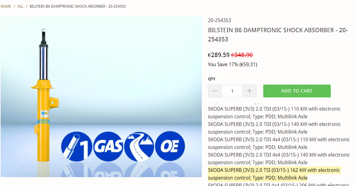

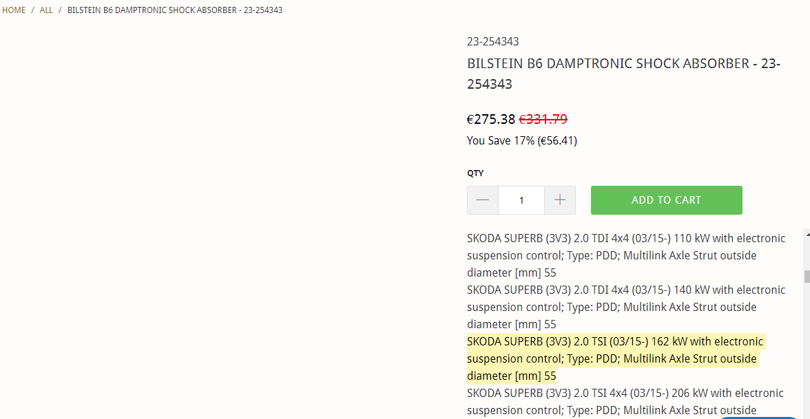

image.thumb.png.6cb019641b5794c2624f33f05720f211.pngimageproxy.php?img=&key=00da0a65627968c1imageproxy.php?img=&key=00da0a65627968c1imageproxy.php?img=&key=00da0a65627968c1
Well yes but It's still 900EUR for which I have tons of better uses than just to be able to adjust the ride height (how often would I need to do that anyway? I'm not tracking this car to worry about going ultra low).Plus for me having got the springs already the difference is closer to 1100EUR in reality.  But even mort important, everything I've read suggests the B6's damping is more than up to the job so I don't feel as If I would be doing any compromise if going with them and the extra cost of the KW does not provide any obvious benefit for me.
As @MartiniBwrote, the rear shock's part number for the 272 4x4 is different to the one you posted so beware when placing the order, cross-check with Bilstein's online catalog here:
BILSTEIN online catalog
