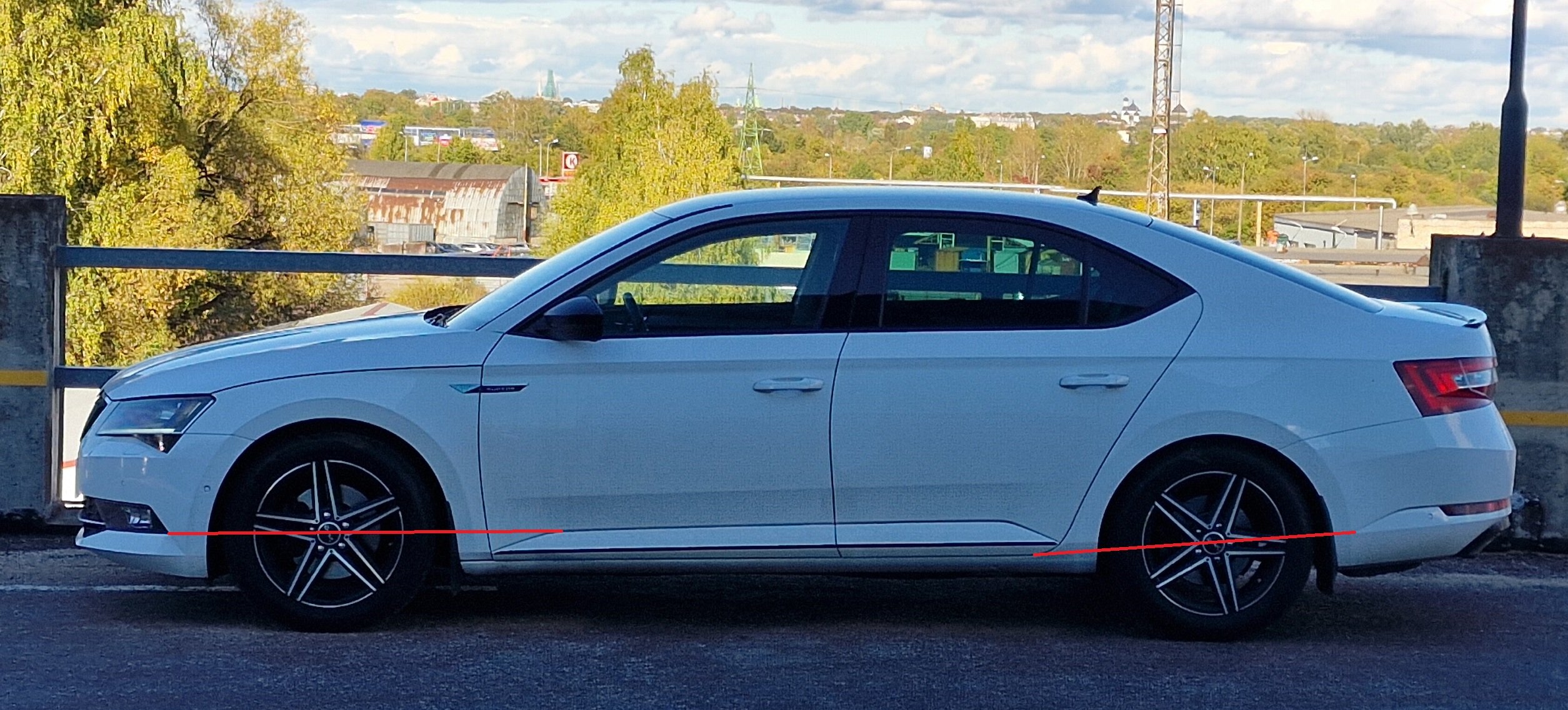

ordered: 2021-08-12  all Bilstein B6 DampTronic shocks + all Eibach Pro springs
shipped: 2021-12-17  front Bilstein B6 DampTronic shocks + all Eibach Pro springs
arrive: 2022-01-06
installation: 2022-01-19    front Bilstein B6 DampTronic shocks + front Eibach Pro springs
installation: 2022-07-08    rear Eibach Pro springs
shipped: 2022-09-06         rear Bilstein B6 DampTronic shocks
arrive: 2022-09-12
installation: 2022-09-23   rear Bilstein B6 DampTronic shocks
13+ months long story has been finished
got perfect driving condition, small annoying suspension noises on rough roads aren't gone
rear axle got few new parts too
5Q0513353E   x2
1J0512135A   x2
N 90648402   x4
WHT007127    x2
5Q0511357L   x2
N 10628301   x2
5Q0513425J   x2

Eibach Pro F11-85-043-02-FA front (from weightier Audi Q2)
Eibach Pro F11-79-008-01-HA rear (from weightier Superb 4x4)
Bilstein B6 DampTronic 23-254343 front
Bilstein B6 DampTronic 20-267537 rear
2022.09.30 (one week after install rear shocks)
581922138_220930_Bilstein_B6_Eibach_Pro_frontrear_ED.thumb.jpg.ff1c0c4ca3473b54d26ad90287f8fa87.jpg

The difference between Comfort and Sport has been reduced for about 30%
as result, Normal became to useless option, because difference between Normal vs Sport and Normal vs Comfort is almost unnoticeable
Comfort, which were annoying waterbed, now feels like previous Normal
Sport became as Sport with little plus
by my subjective opinion, the most, 65% of performance improvement, came from stiffer Eibach Pro springs
