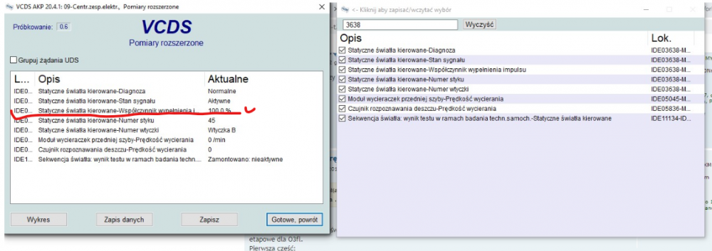

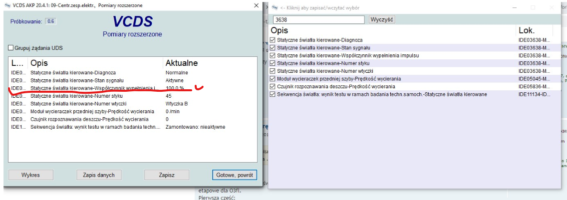

Unfortunetly it seems to be not succesful with FL version. What is really strange it that I have checked with VCDS advanced measurments how controler is reacting on steering wheel turns and it seems everything works correctly (my version in Polish, so most of you have to belive me, but underlined line is showing Puls Duty Factor for left fog light):
After turning wheel, AFS signal become active, duty factor is 100% and plug number is exactly the same as for fog light. But all this is not reflected in real light behavior.
I've tried reseting lights options in car setting to factory defaults, also I was waiting 30 min allowing CAN to go into sleep mode... no changes.
Can anyone help me with those adaptations in FL version, it seems something has changed in FL and probably some additional adaptations / coding has to be done, maybe in CAN Gateway ?
