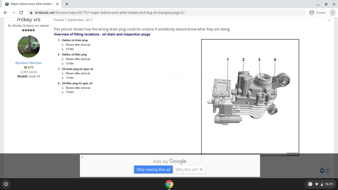

  • Seen plenty of bell ends drain out the differential oil, force some more oil into the Haldex unit (leaving the diff empty). Then a short while up the road with no diff oil in it the diff overheats and
  • @John@C Your own thread has now gone off at a tangent really.      Your issue is most likely the error of a technician or fitter and not a Fundamental Design or Manufacturing or materials fa
  • Direct from the horses mouth, - that is the most concise explanation ever and perfectly decribes this bell end   who was watched over, aided and abetted by another forum member.   Considerin

1 hour ago, Tech1e said:
Seen plenty of bell ends drain out the differential oil, force some more oil into the Haldex unit (leaving the diff empty). Then a short while up the road with no diff oil in it the diff overheats and cracks.
Direct from the horses mouth, - that is the most concise explanation ever and perfectly decribes this bell end :blush  who was watched over, aided and abetted by another forum member.
Considering how many miles I drove, the speed and the load carried I was very very lucky indeed, I may still pay for the expensive lesson but at least I can own up to my own incompetence and not expect someone who trusted me as a professional to pay out £4.5K for my mistake.
In my defence I did my Haldex service shortly after screwed up eye surgery that left me blind in the eye that previously could see closer than the other, another so called professional who blames everybody else and leaves the customer to deal with the consequences.

An apprentice technician is a trainee and a fitter is a fitter not a technician or a motor engineer or mechanical engineer.
Edited by e-Roottoot

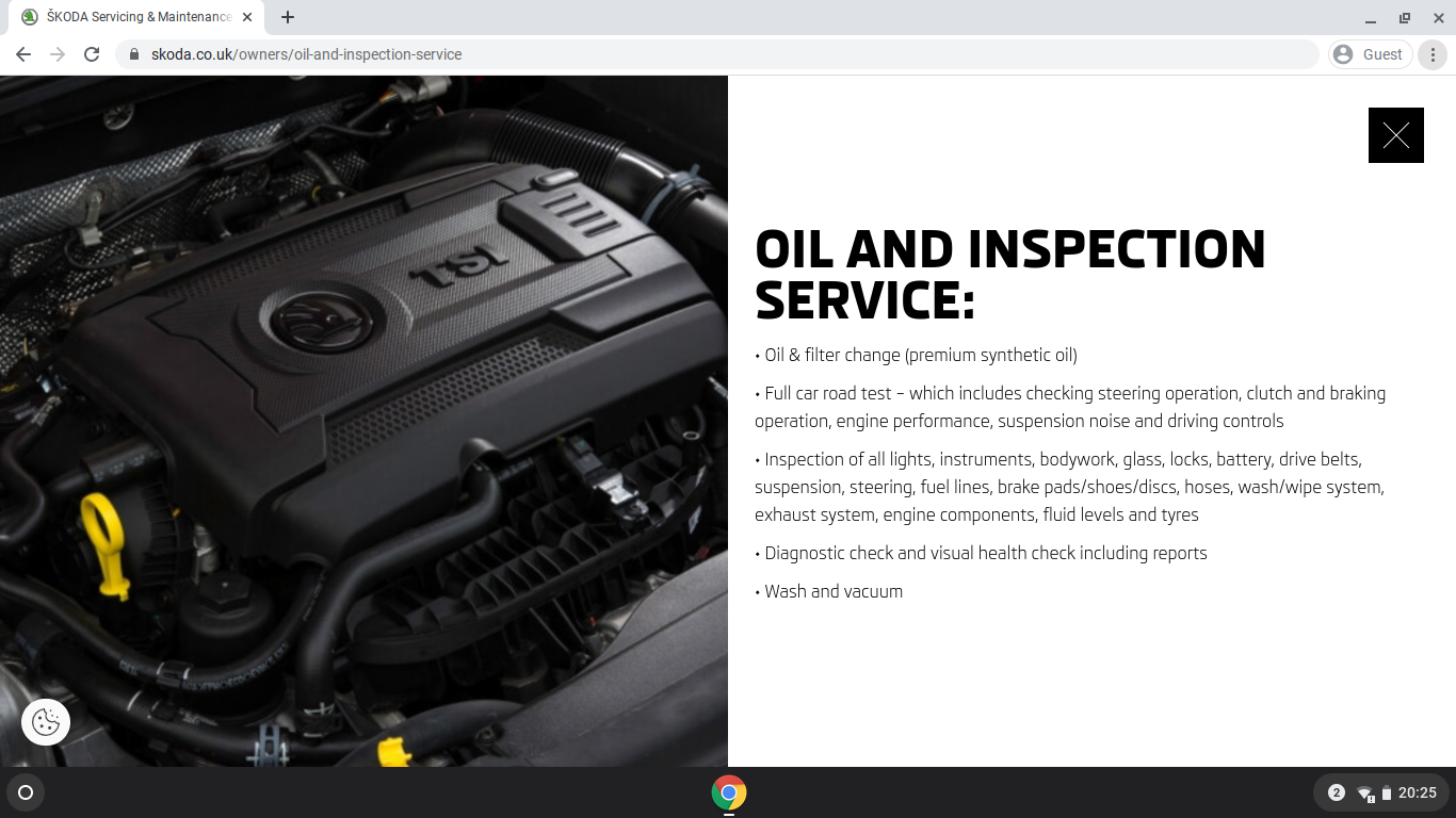

Dealerships fail to tell owners about a Haldex Service so they get missed.   The Car has been fine since 2017 until they serviced it.
What is the DPF thing all about?    What do they mean?
Spot the Extended Scope.  CHECK / REPLENISH FINAL DRIVE OIL (WHERE APPLICABLE)
This simply does not get done.   OR HAVE THIS CROWDS TECHNICIAN DONE THAT?
It used to be shown to be done with the MAJOR SERVICE as well which was changed just this year in January.
