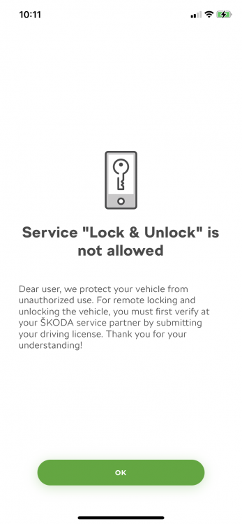

Have you tried locking or unlocking the car with app? Mine wouldn't work at first, I got a message saying that for added security I had to take my driving licence to my dealer for them to fully activate Connect. They did and certainly my app now works fine.
Interesting.. I never tried that and it tells me I can't do it.  Never tried that before!
Right I'll ask the original dealer to do so as they asked for my driving license. Clearly didn't use it to authorise the app!
Thank you very much. Hopefully this might be a solution.

Well potentially exciting times. The dealer I bought it from have been - let's be charitable - less responsive than I would hope.  However my local dealer is going to give it a go so we'll see what happens.
I spoke to Skoda directly and their view was it's two separate issues. They don't expect authorising the app will fix the 'where the heck is my skoda connect' icon issue.  So we'll see. Worse case at least my local dealer gets the problem so I can book it in there,

So now the dealer has activated the car so the app now lets me lock and unlock it.
As I suspected this has made NO difference to the problem with the 'Skoda Connect' Icon not appearing in the menu.
