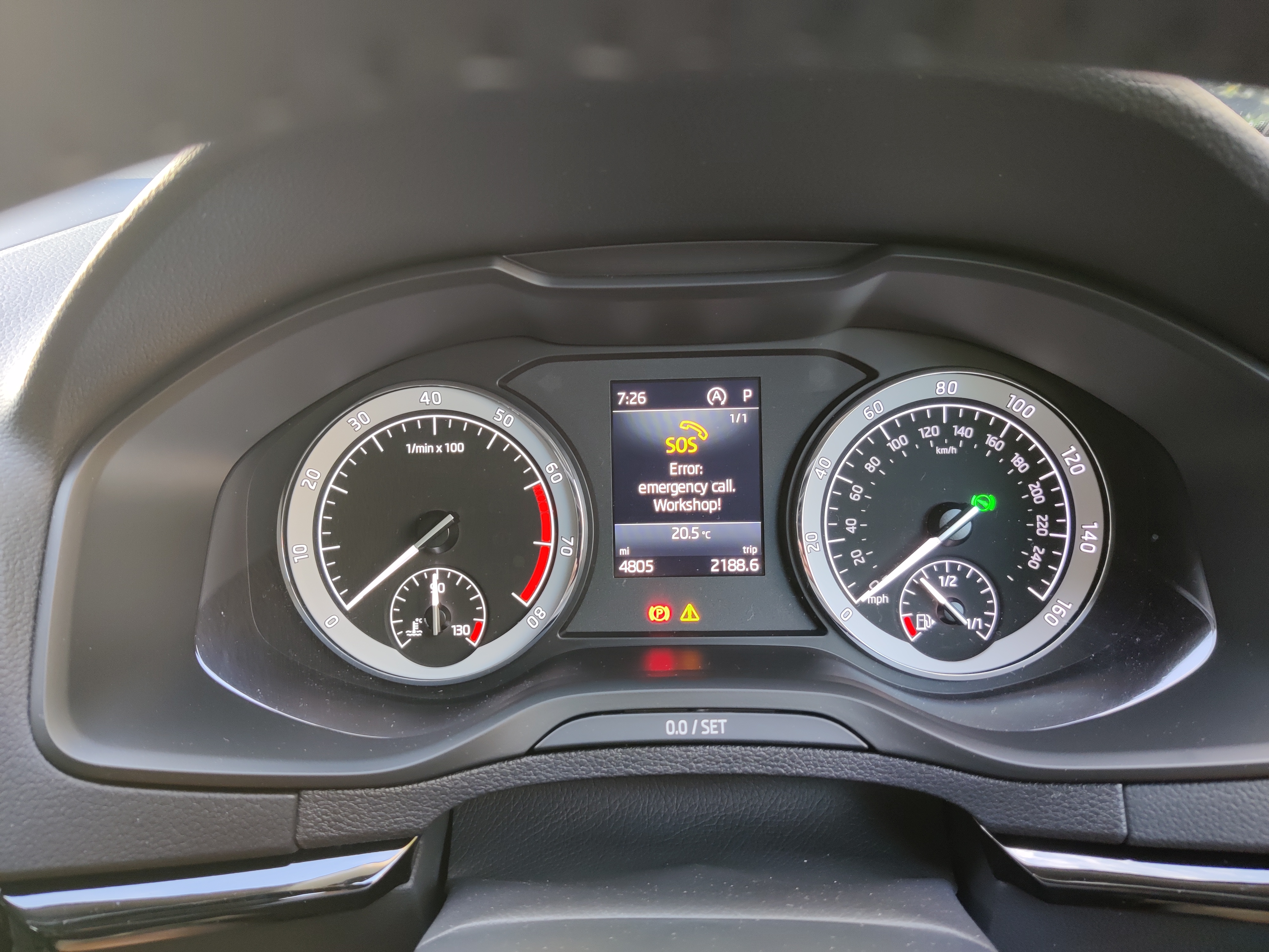

I shouldn't have said anything about my last 10 months with no problems with the Karoq "connected" infotainment. Because on the first of August while driving on Hayling Island there was a ping and a rather alarming SOS message appeared see below. IMG_20210811_192637.thumb.jpg.ac3c6a8a2ea048d3c54373d35b79ac2e.jpgmessage on the
Seeing the word Workshop! I thought it was something serious with the car, I did eventually realise that it wasn't and I looked up by the rear view mirror and the green light was off and so was the skoda connect "world" symbol no longer on the screen. I suspected that perhaps we were in a cellphone deadspot so wasn't too concerned. Anyway it stayed like this until I reached the Premier inn in Havant, but was back to normal next morning. However a bit later that day on the M27 near Southampton it did it again. On both occasions it did not reconnect on its own but only after the car had been left locked for a while. Since then it has done it several more times, and I now realise that other aspects of Skoda Connect are affected
Going clockwise on M25 near Clacket lane on 11th August the message pinged again and this time the navigation went off and the screen just displayed the usual loading navigation message but for about 20miles, eventually the screen blanked and then navigation came back. However returning later that day anti clockwise I pulled into Clacket Lane with the system working OK but when I started the car to leave there was again a ping with the SOS message but this time the whole system froze as it was unable to load my user profile, so I had to drive home to Essex with no infotainment at all not even the radio as nothing would work (I did try switching off, locking doors etc. but nothing helped). And it did it again yesterday with my wife driving just as she was about to re-join the M25 clockwise after a stop at South Mimms. This time the navigation, radio and Spotify were not affected or so we thought. We didn't really need the naivigation but its useful in case of congestion or diversions but as we neared our home it repeatedly tried to re-caculate the route and looking at the map I could see that it thought we were a few miles away from where we actually were, so the GPS was also affected in some way.
Has this happened to anyone else?, or has anyone heard of anything similar.

Hi Ex-Yeti. I've had exactly the same issue twice in the last 2 days, at different places. It's very annoying, as you lose live traffic info on the Navigation page, and other services. I was able to use live traffic info on Google Maps via Android Auto to continue to Navigate through busy traffic last time.
It has happened to me three or four times before, but more sporadically, and once happened twice at the same geographical location.
It usually corrects itself and comes back on after switching the engine off and leaving it for a while, though on the first occasion it happened to me it was out for a week - I booked it in for an inspection at the time, but cancelled it after it came back on.
It is very frustrating, and for me is occasionally spoiling an otherwise very enjoyable car to drive.
Like you, I'd like to hear from others with the same issue, and how they have resolved this, or from Skoda with an update on the issue. With that in mind it's probable worth starting your post as a separate topic, rather than at the bottom of page 3 on another post. Let's hope it can be resolved. All the best, S.
