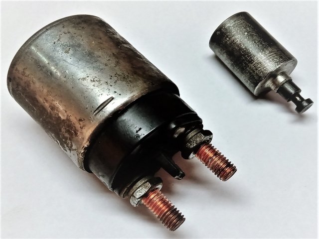

I had to change the Solenoid of the Starter,i searched paying attention for codes similar to the original Magneton and i have found the HC-Cargo 136270 which fitted perfectly.
As i see now the car starts one click faster then previous.
Here is the old one:
