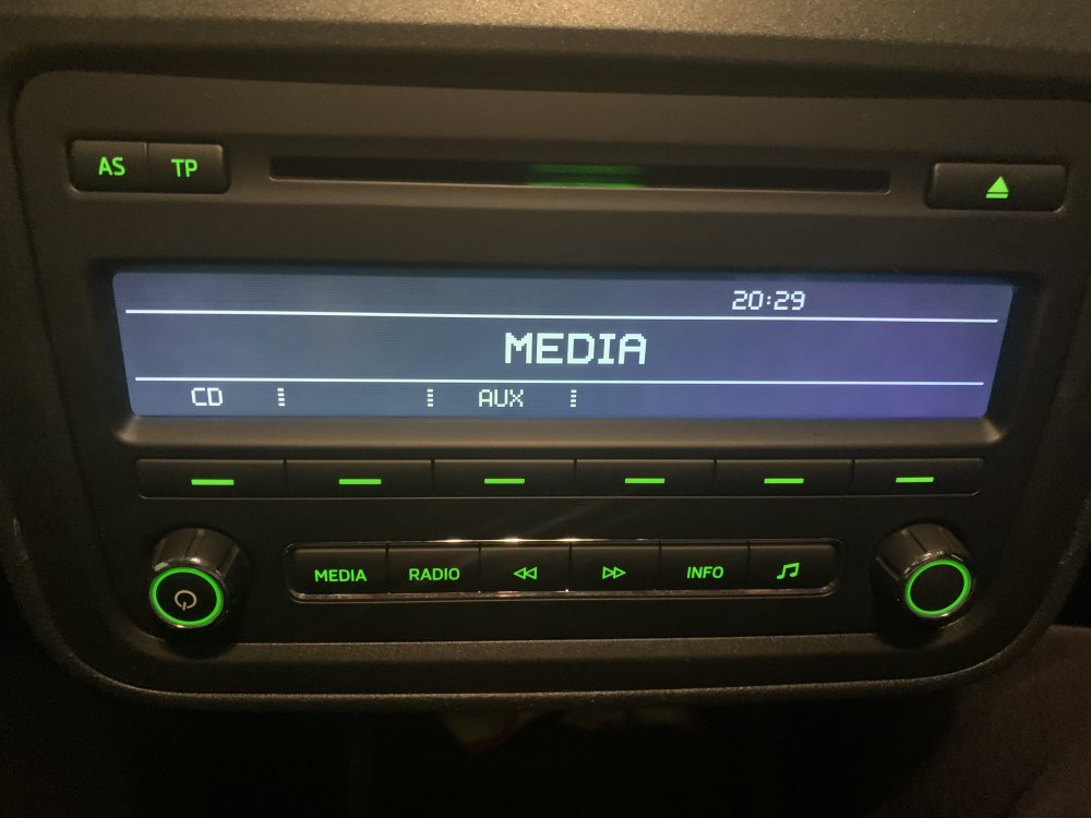

Hi All, does anyone know if there is any sort of Bluetooth module that integrates into the factory fit Swing Radio that is fitted into my 2015 Roomster. Seen a few on eBay that connect into the CD Multiplayer socket on the back of the radio. I’m not fussed about DAB and would rather stay stock as I want the reverse sensors to work. I’m guessing that the Media menu seems to have a blank section where the multiplayer could be selected, see the attached photo.
Does anyone know the RNS model number.
