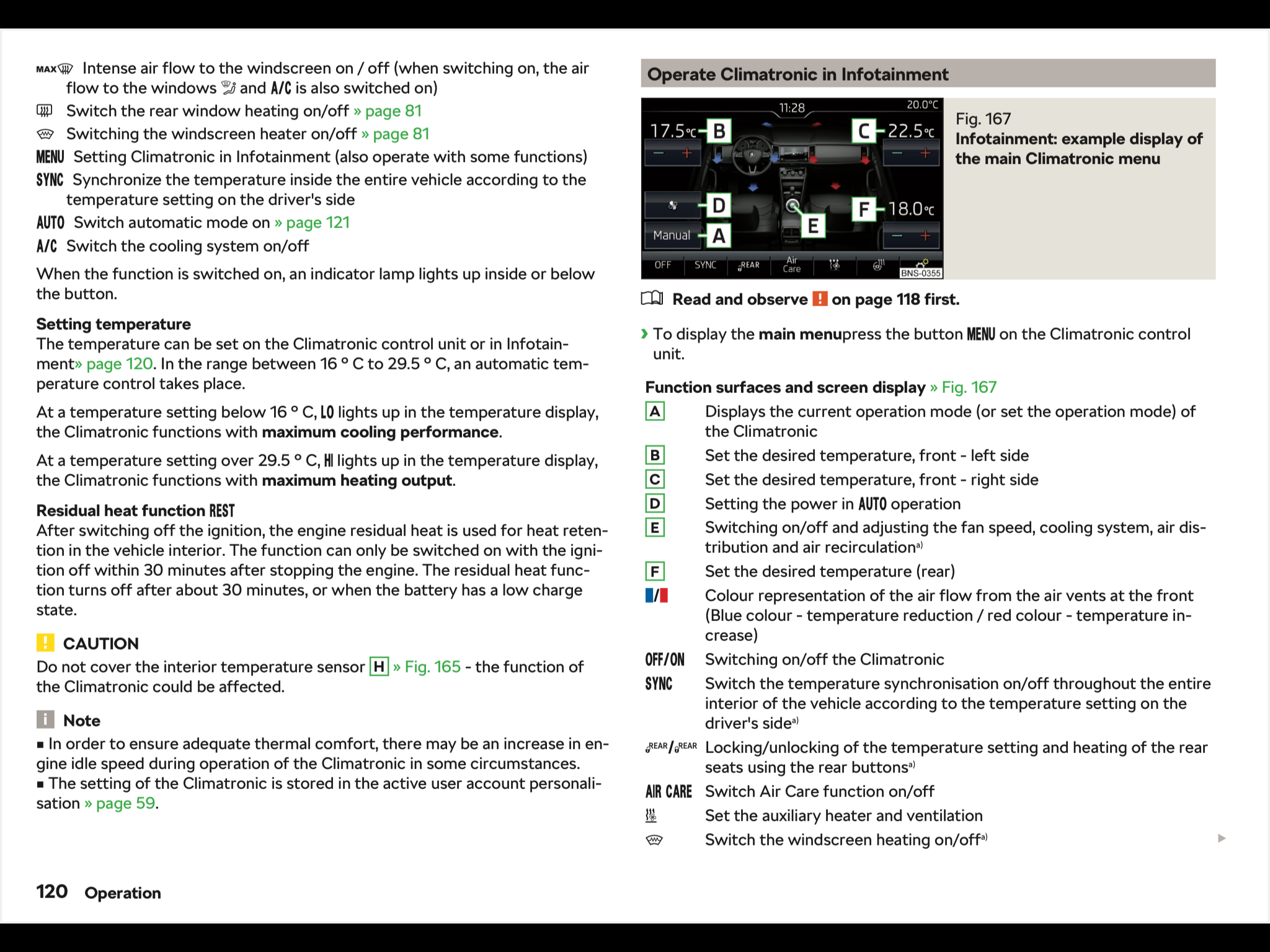

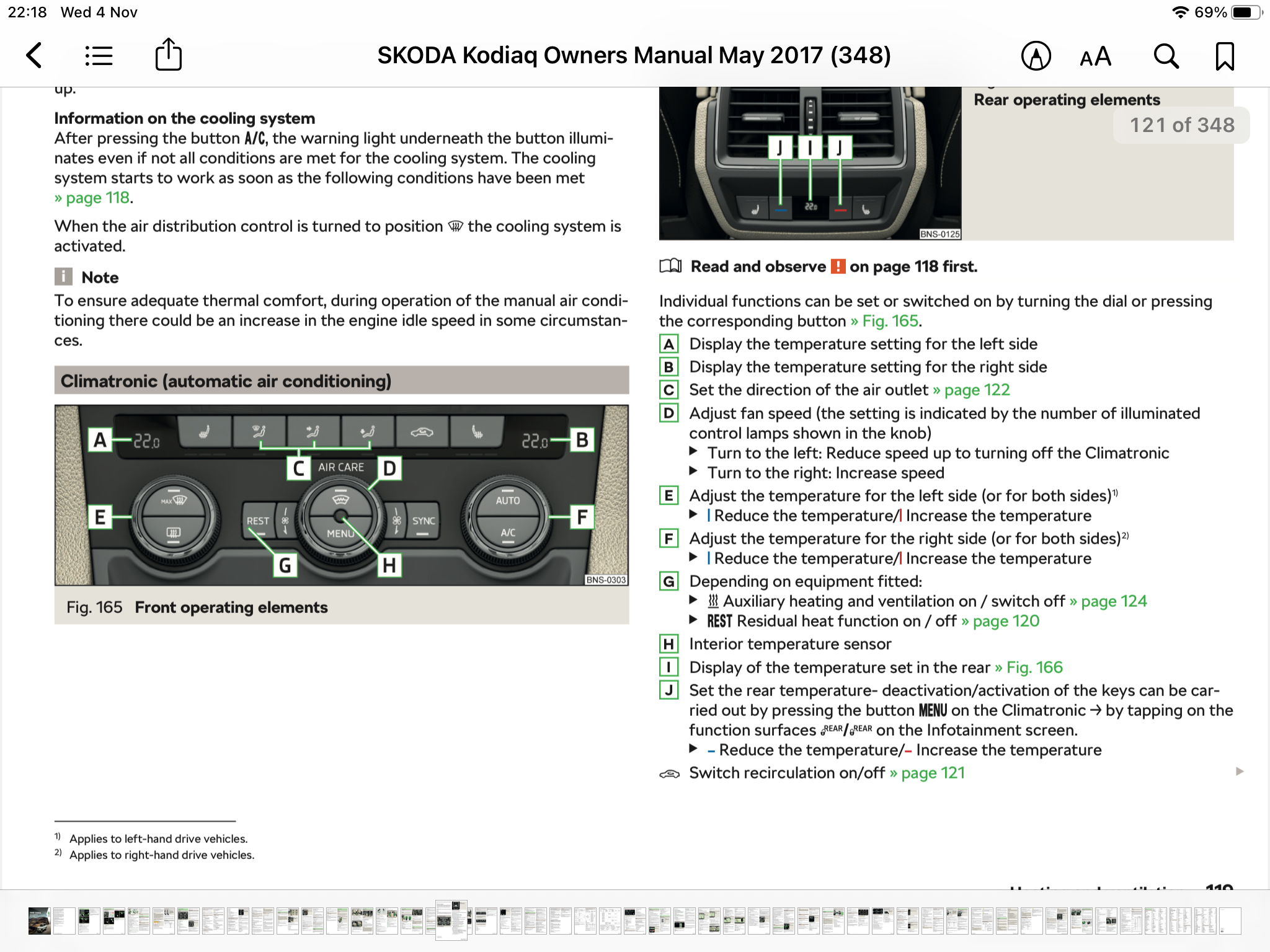

If it wasn’t the radiator fan - very common for that fan to run on after switching off - was it the Residual Heat button causing the ventilation fan to run on after switching off?
Button G.
Edited by BoxerBoy
The fan stays on for a while when the regeneration process is interrupted.
