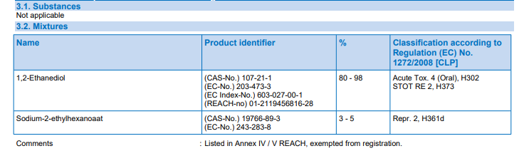

OK, so the MSDS (Material Safety Data Sheet) for the two say that both are principally still ethylene glycol (ethane-1,2-diol in modern chemical parlance), but G13 does have a proportion (10-30%) of glycerin too.
G13:
G12++:
Interesting that the exact proportions of ingredients can be kept vague.
  • Sponsor
Haven't found an MSDS for G12 evo yet.
