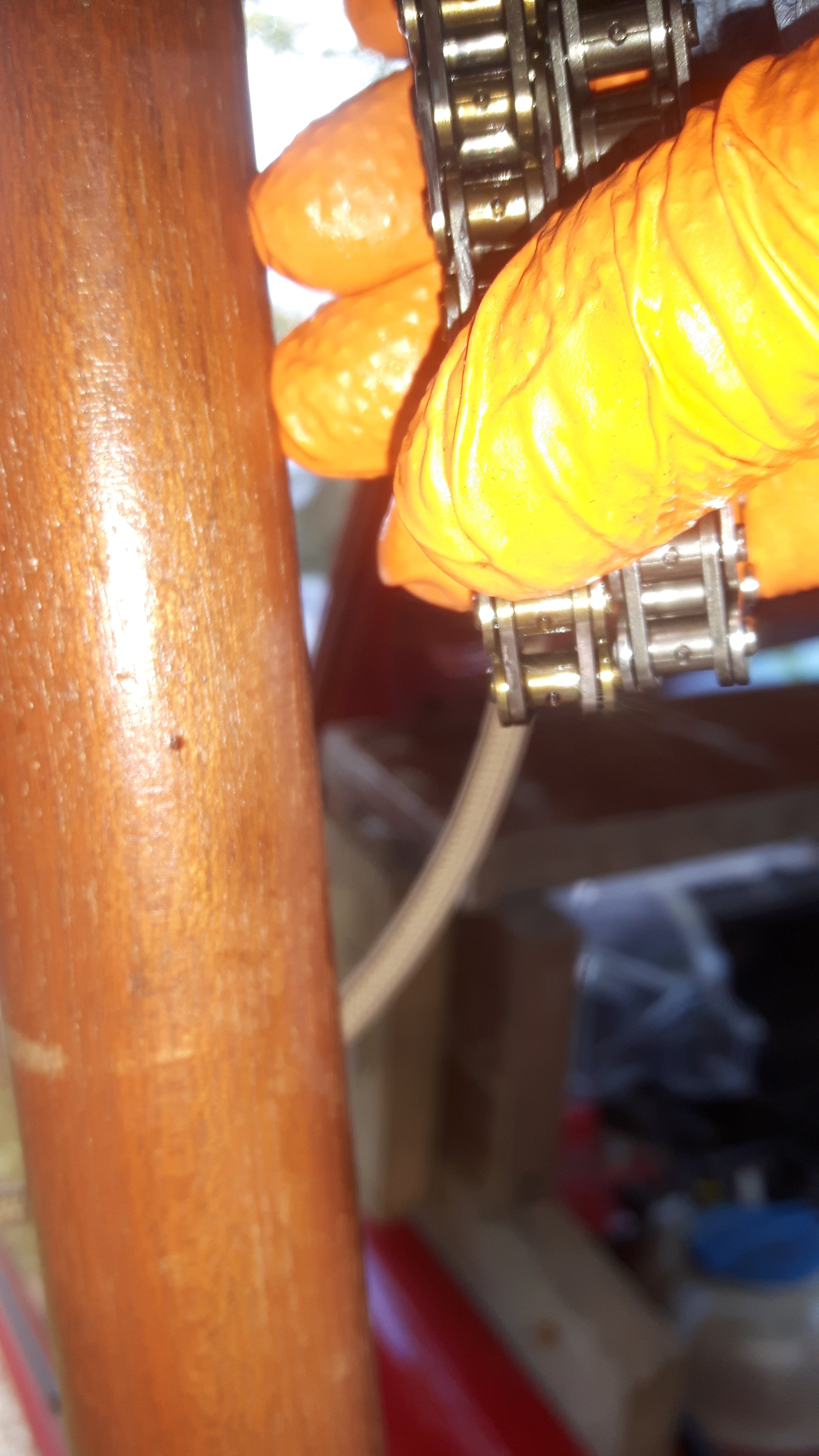

Funnily enough ( see below post) I did a major overhaul of out HTP in August and after stripping the engine down to virtually bare block, the only fault turned out to be the clutch (d'oh!)
Chain was barely visibly different to the new genuine replacement at 175k miles. Maybe 3mm elongation, if that.
Edited by Wino
I overhauled my sons 1.2 12v polo, replaced timing chain and guides, new valve guides and seals, recut seats and ground in valves - after 120K miles, chain was stretched about one link and chain and valve guides very worn, runs superbly now !
I understand these are prone to chain wear.
