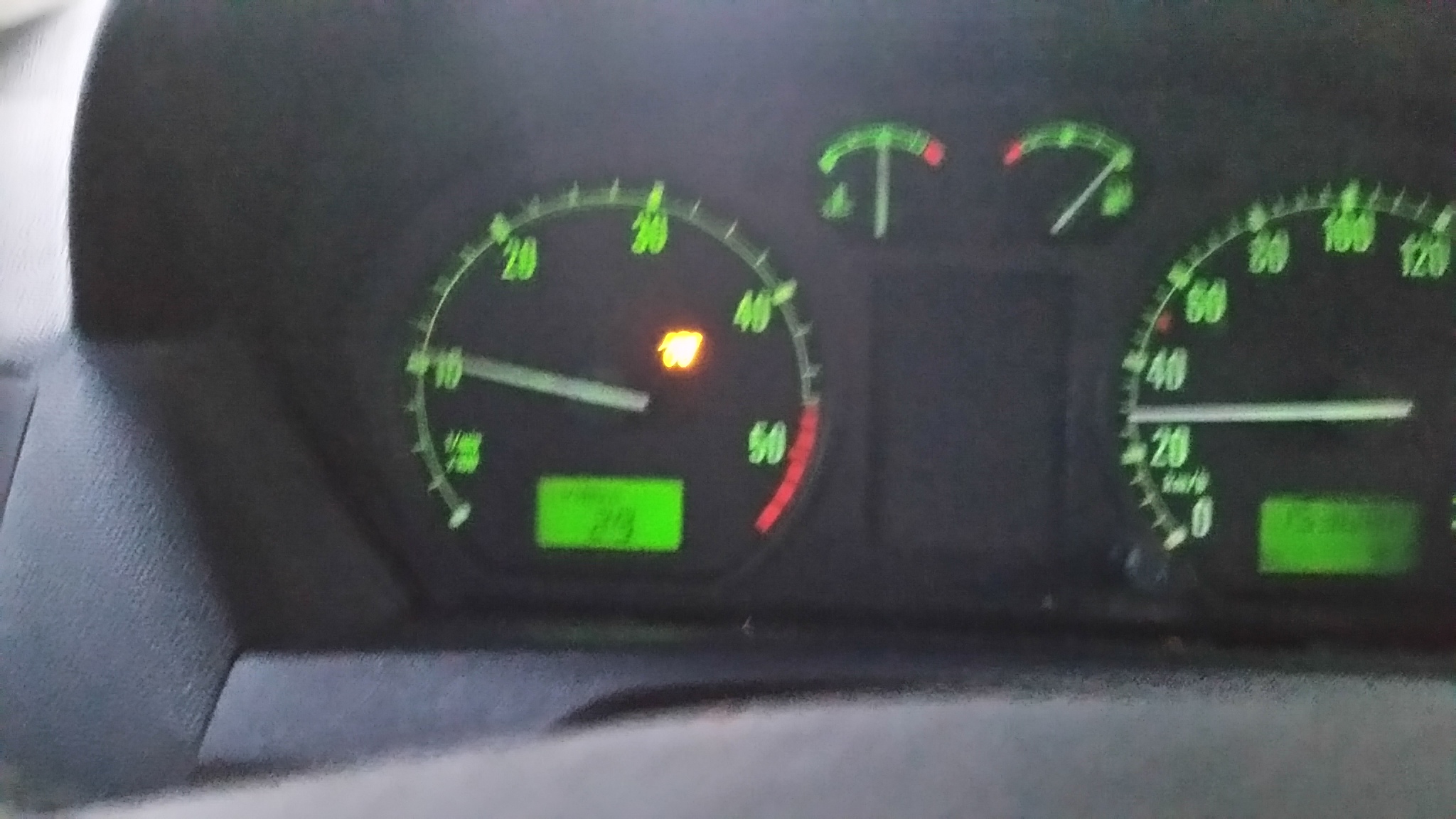

Does the battery light now come on with ignition?
Yes, and it goes away as it should, BUT past weeks has come on randomly couple of times

Are the brake lights working? The glow plug light can come on if  both brake bulbs have failed or the brake light switch is faulty. Having said that, it could just be on because your car is an electrical disaster area.
Edited by TMB
Yes, i am aware of th three function of the glow plug lights (brake bulb, brake switch, or general electrical malfunction)
Yes they are working.
I finished working in the car for today.
I turn on the car then remove the battery, the problem was there, I turn on the car and remove the alternator, the problem was there.
I removed all the fuses but only the vital for engine keep running, and the problem was there.
Hmmm, I don't know then :thinking: Has that light been on ever since you've had the car or only just come on?
It came on a two months ago but due the brake light switch. Then never back again until today.
Everything would point to the alternator or its regulator but the problem still persisted when I removed the alternator form the equation.
Edited by Kharl
New info
I see. I suppose the switch could have failed again - they don't just work the brake lights but have connections going to the ECU as well. Other than that I'm not sure.
