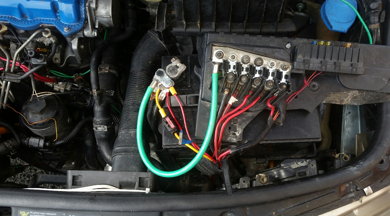

Some bare wires and bad connectors in poor conditions
Now the problem is only when I turn on the ac

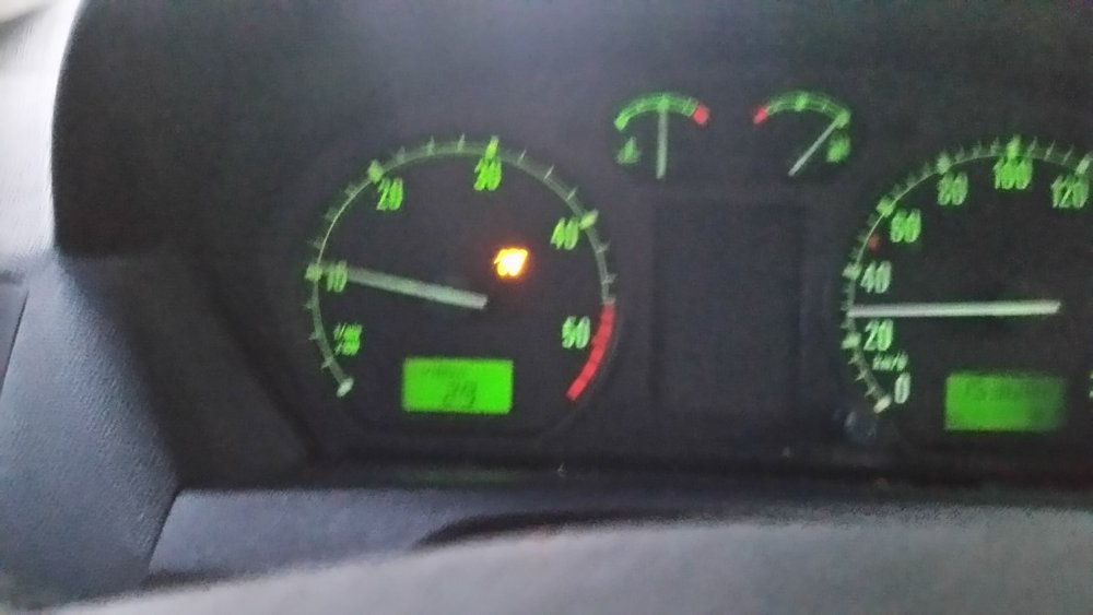

An update, late this afternoon i went to an electrician that told me the problem is either the ECU or the... i forget the name of this part, the one that let the air in in response to the accelerator, in gasoline es throttle body i guess?
Find another electrician, it's NEVER the ECU and almost never the throttle body, there has to be an air leak somewhere.
i am sceptic too but it is directly related to the idling, i mean, rpm goes up and dow with the lights and the voltage... i dont know really..
oh oh, i also forget to mention, the car have a service inspectionmessage, and he says the scan tool told it is related to the throttle body

Service inspection message does not relate to faults.  It just tells you when a service is due, and which type (oil or inspection).
What is the fault code read by the scan tool (what number)?

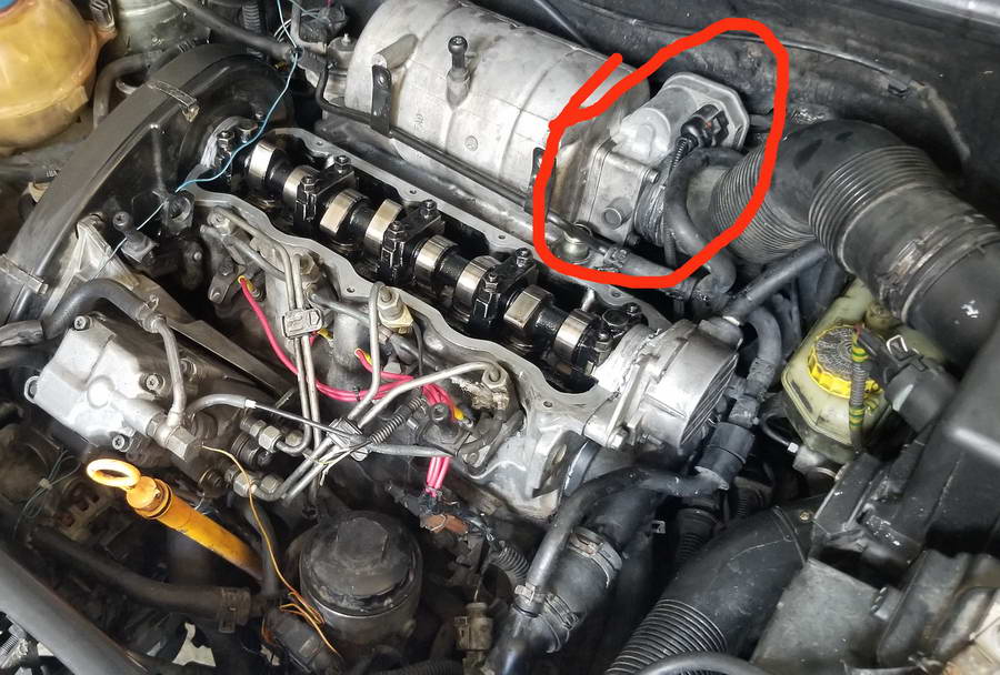

Check for broken wires close to the intake manifold flap motor (circled part in your last photo).  Check cabin fuse #24.
Maybe also take it off and clean the flap.

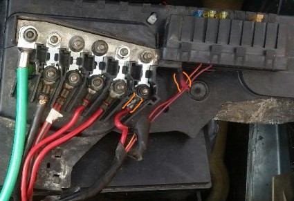

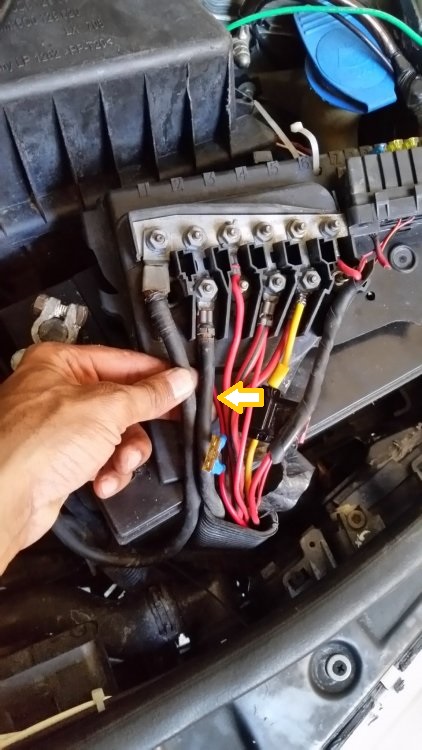

There should be a strip fuse in positon 3 for it on your car. It looks like someone has removed it and connected the wire straight to the busbar beyond.

i did organize all the fuses in the battery area *the best for now( and i did remove the power cable to the pump, i was able to confirm it because the steering light and the hard steer, and no luck, the problem still there.
ufff good news! i went to a store near home that sells electrical equipment and they had the special tool for the clamps in the wires you suggested me, i decide to make a stop there to install and organize the wires
and wen i finish an di turn on the car, voila!, problem gone!

Are you going to fix the cut wire too?....

The new wire looks to be nicely terminated, but would be better if it was as short as possible. It normally goes to a stud on the underside of that fuse panel instead of where it now is, which is where the alternator fuse and connection is from the factory.
But if everything works, just be happy and enjoy the car. :)
Yeaj i was thinking about doing it with a shorter wire, that will be for the next roundm
Regarding the cable going underside, i will gice it a look and see ig i can put it there.
