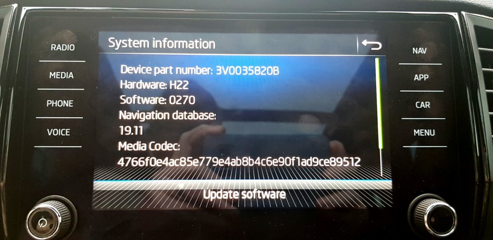

My System Information shows my software as below. Is yours the same, or has your system update given you a more recent release?
Chris

Information about my system:
Hardware: H22
Software: 0270
Navigation database: 20.10
Radio Database:1.30.16

Looks like you've got an updated map for yours, but the hardware and software is the same. The MY21 Karoqs in the UK now come with a free online data plan for the first year (probably to get us used to having it, so we'll pay to keep it later!)
