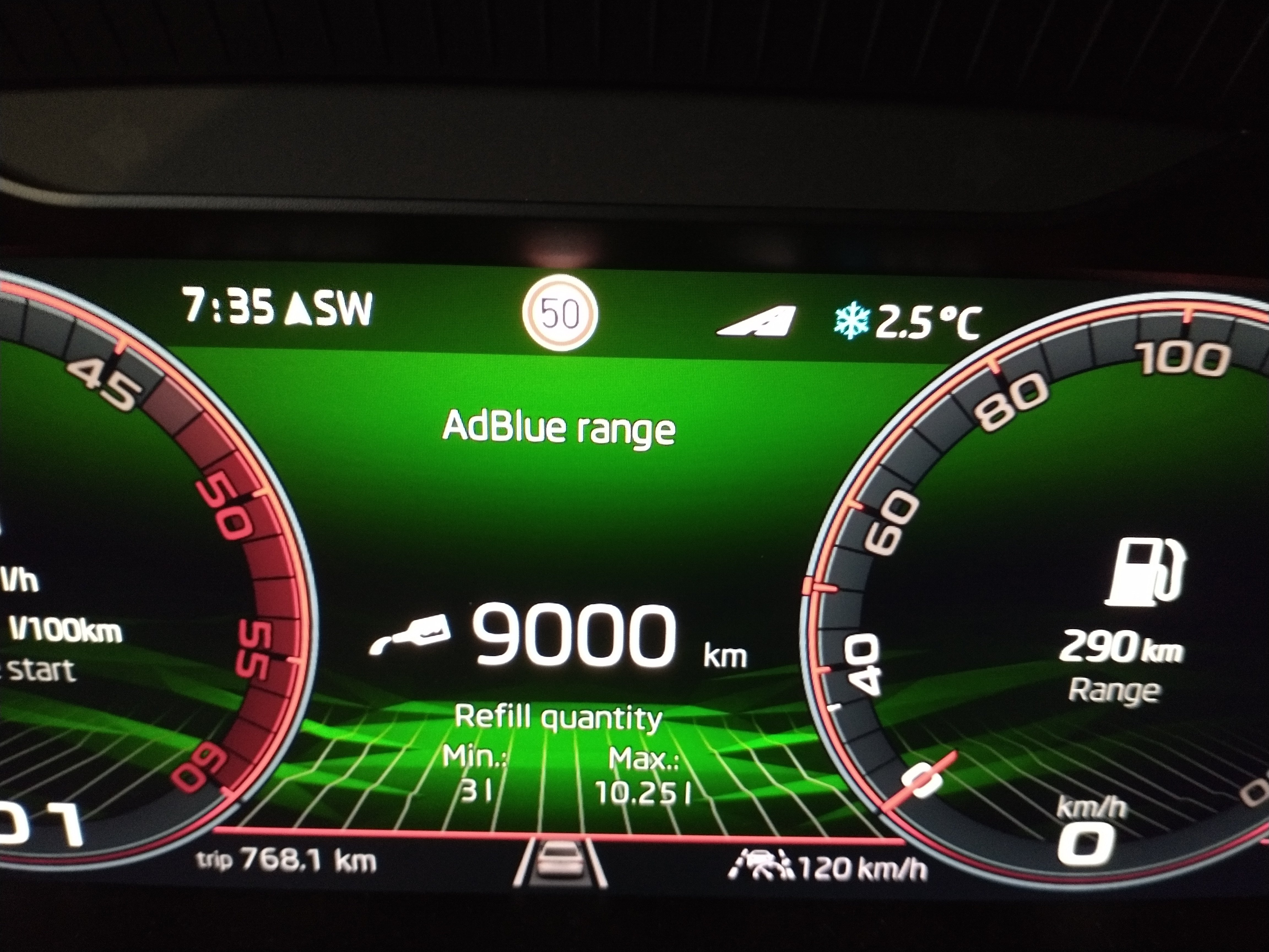

@Jonatan maybe worth to read the adBlue tank level in the driving data & then topup to see if the indicated level increases, then monitor over time to see if it rapidly decreases or doesn't change..
I tried this today.
I dont really understand what refill quantity min & max means but I'll monitor it over the next thousand kms next week
Sorry for late reply. I initially poured 5L in (and turned on ignition for 30sec before starting the car). Driving data didn't change and the car kept on warning about needing topping up on AdBlue. I then filled her up with an additional 5L (until full) and the car has still not registered the tank being filled. I will have to consult with a garage in the coming days.
