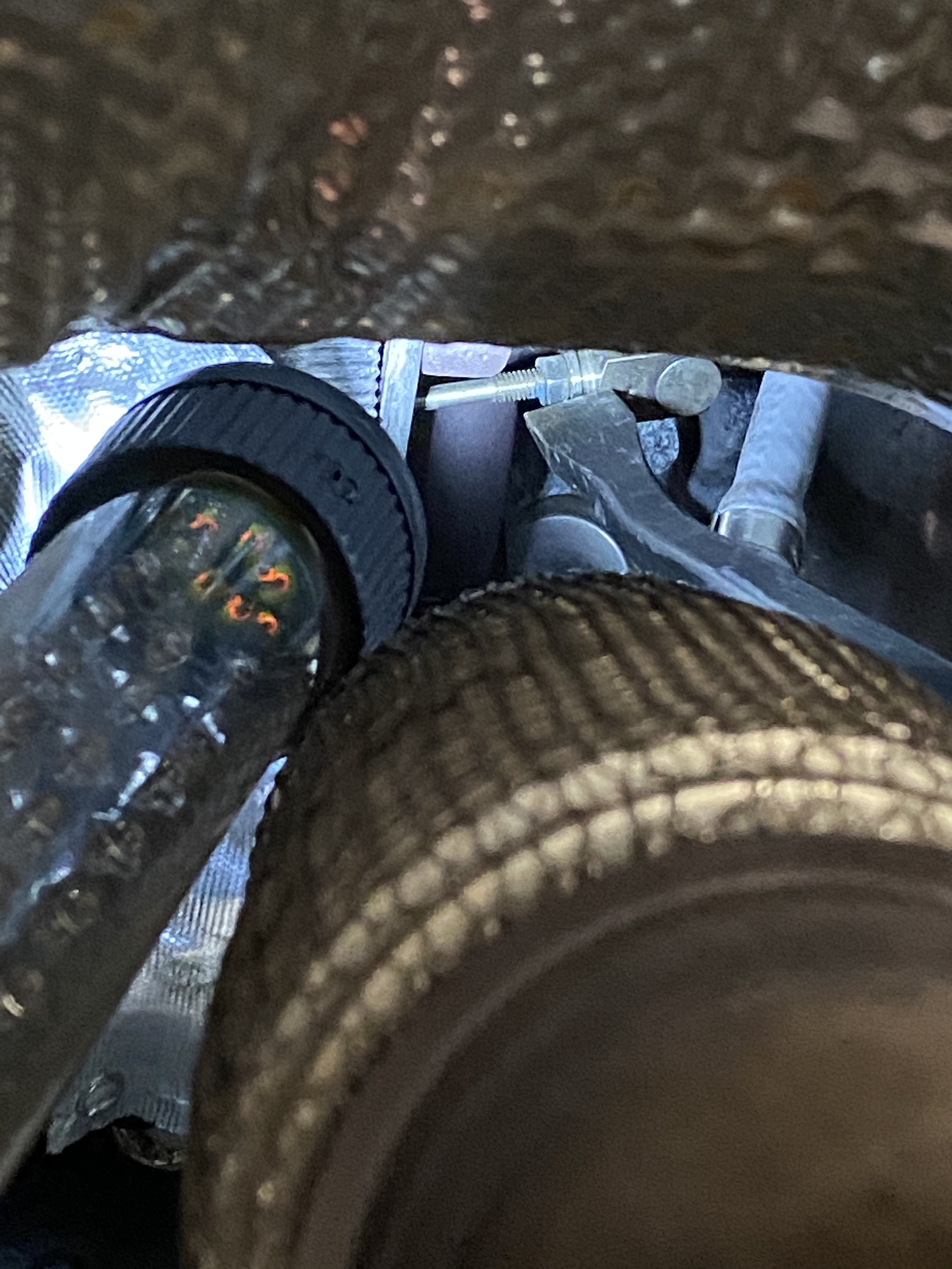

Gen 2 EA888 IHI RHF5
Gen 3 IHI IS20
The gen 3 actuator coupling to the wastegate arm looks much chunkier.
Edited by TheClient
Thanks for the photos.
